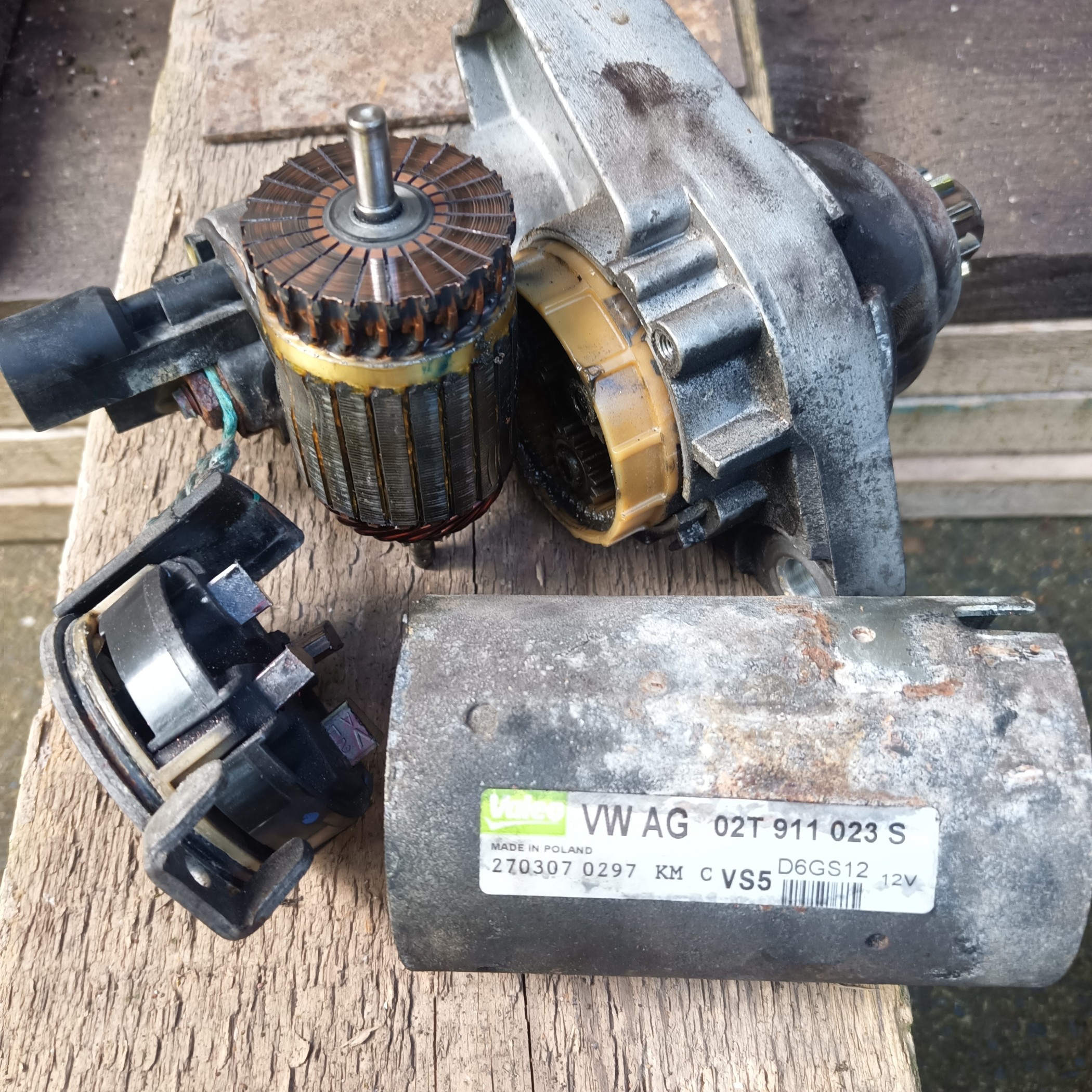

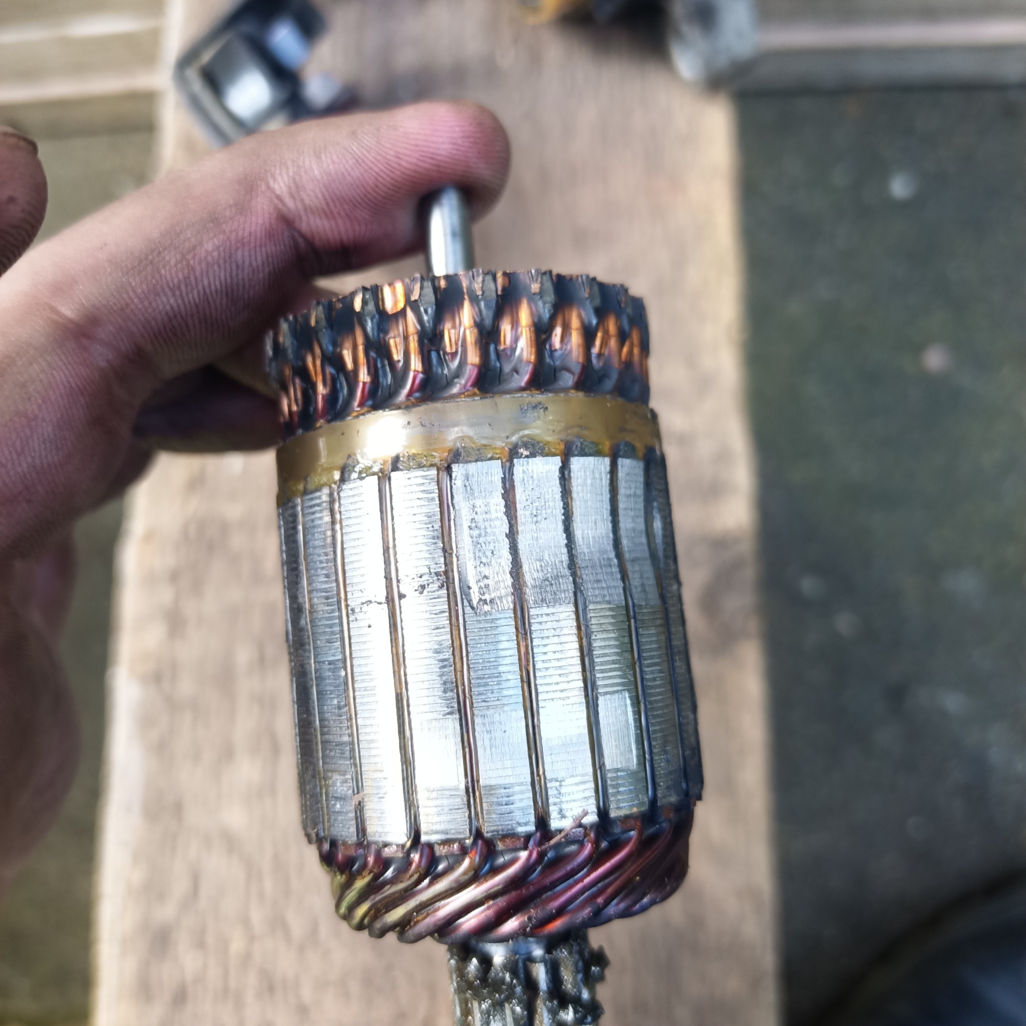

  2. Well a lot of swearing later and the starter is off. As the nuts looked a damn sight easier to undo, thought I'd have it apart out of curiosity. Still some meat on the brushes. But commutator looks a bit oddly worn to me, but I'm neight an electrician nor a mechanic.

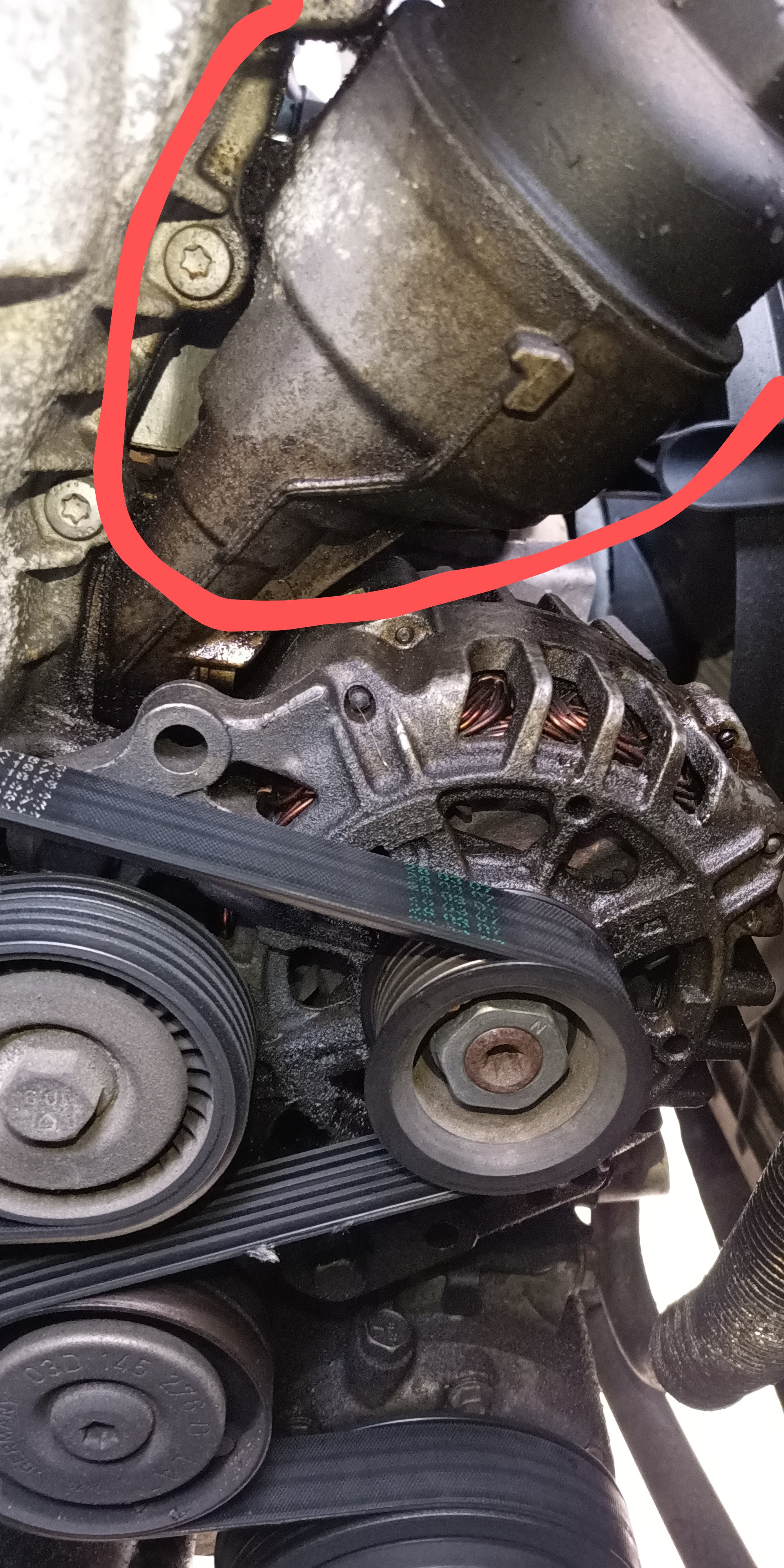

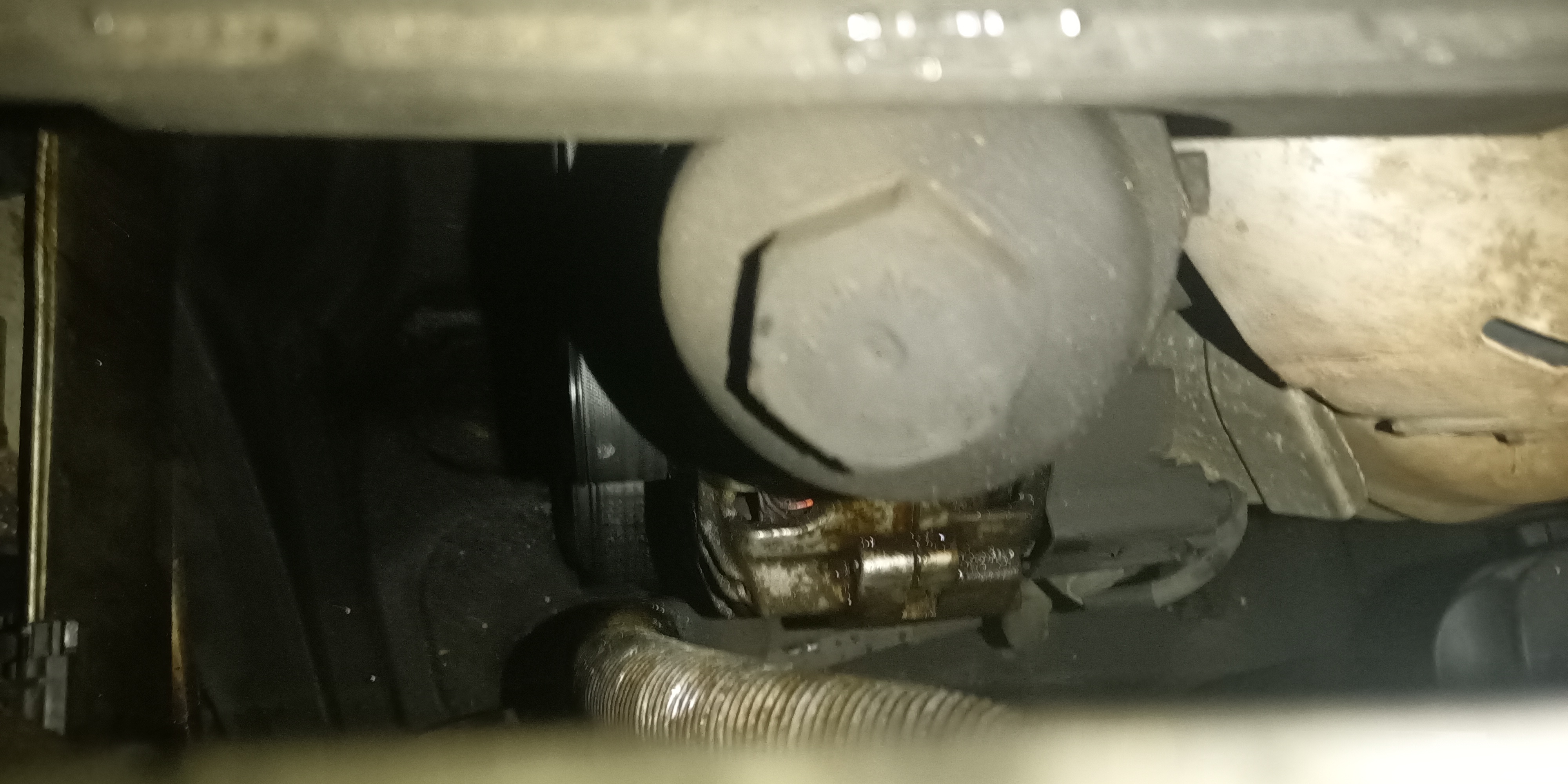

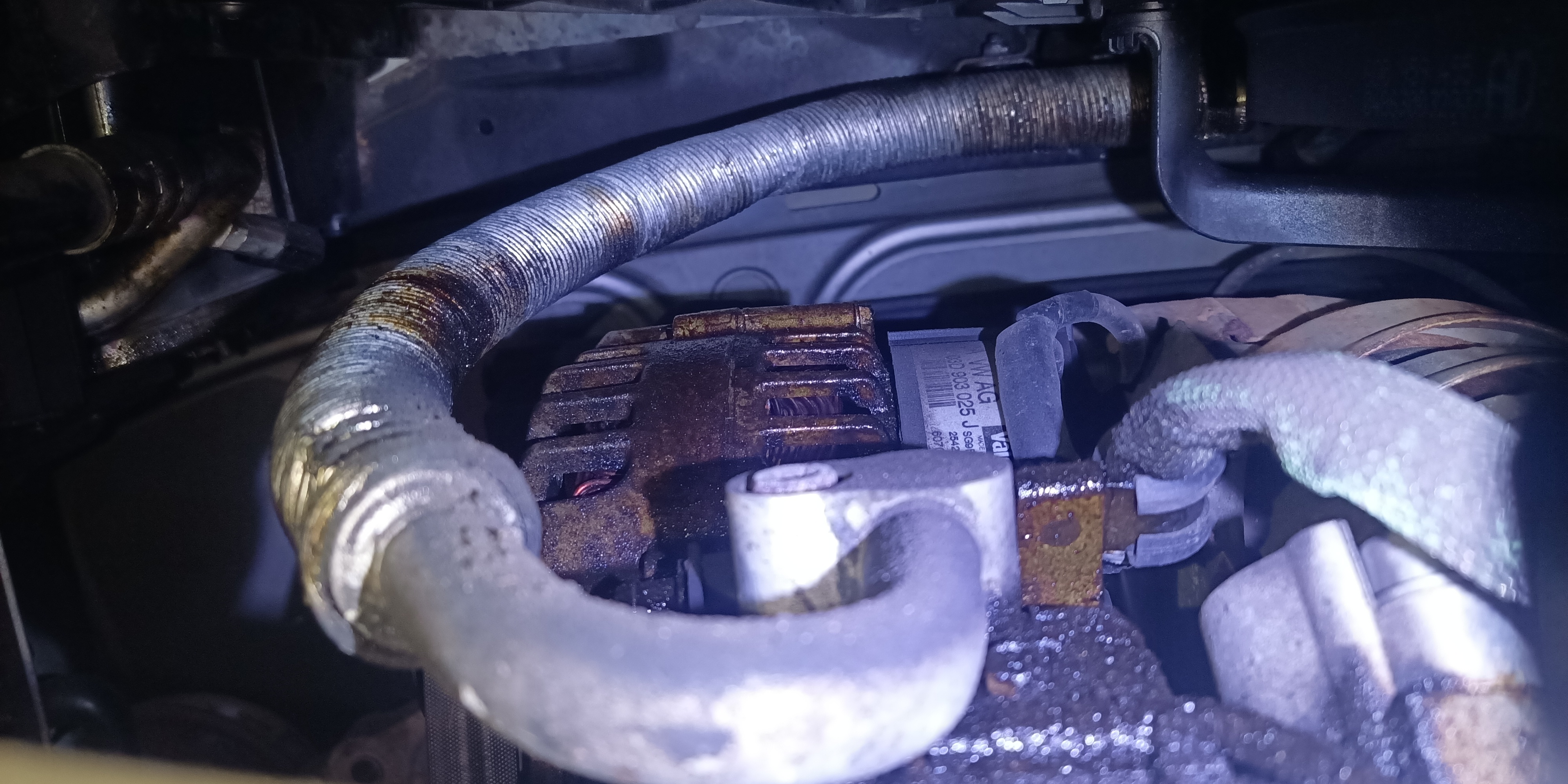

  4. Hi JR, thanks for your reply. I did top her up with oil as she seemed a bit low about a month ago. But no oil change and, nothing else has been loosened or tightened. Oil is localised to the components around the area photographed. Hadn't noticed any dripping when I'd been parked up, but the plastic tray I've taken off the bottom did have quite a lot of oil residue in, not sloshing about or a pourable quantity though. Daft question but what part am I looking at in the picture below, oil marks only appear below its black cap with a MN rating on the nut. Not sure whether it could be the source of the leak or oil has just been thrown against it.
