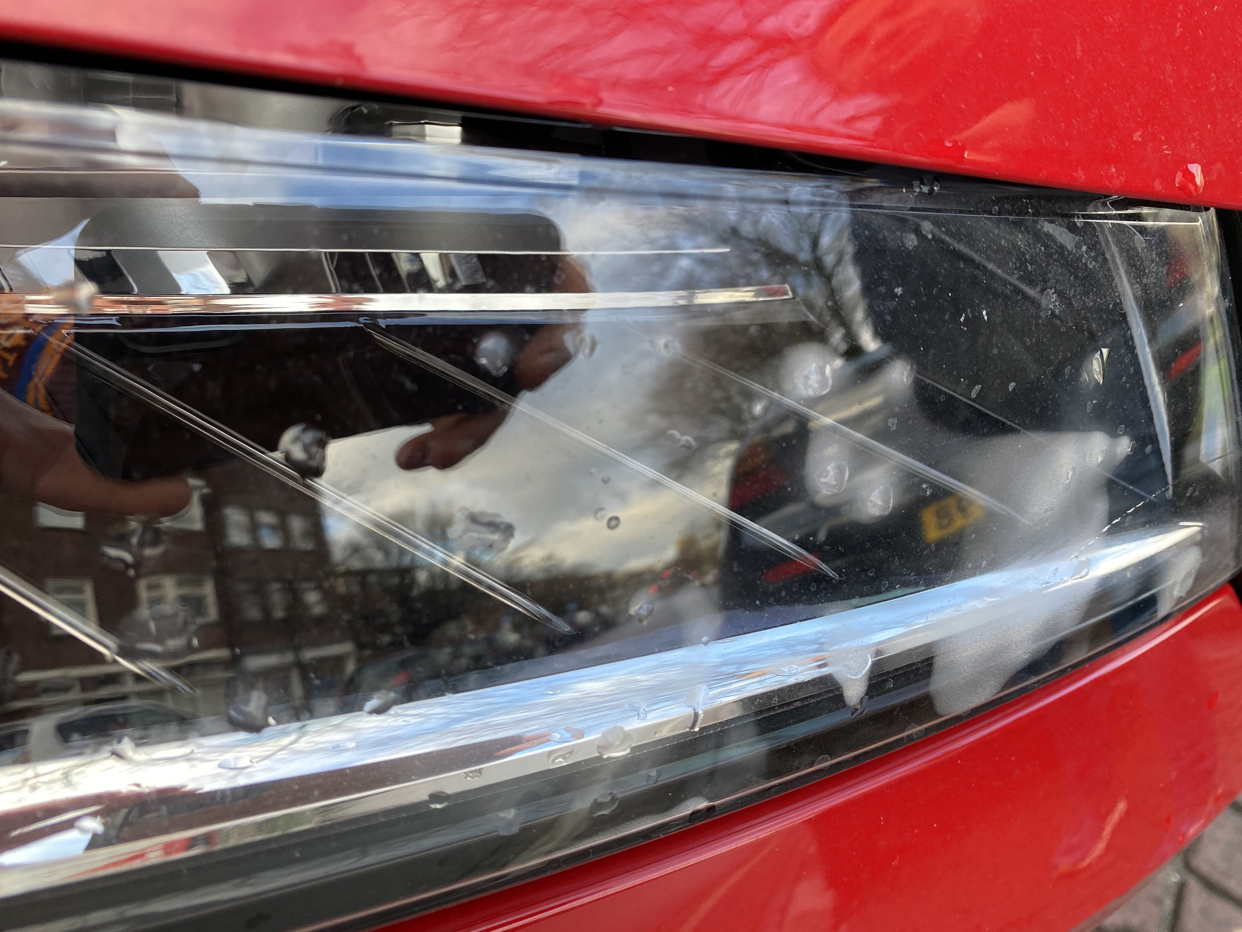

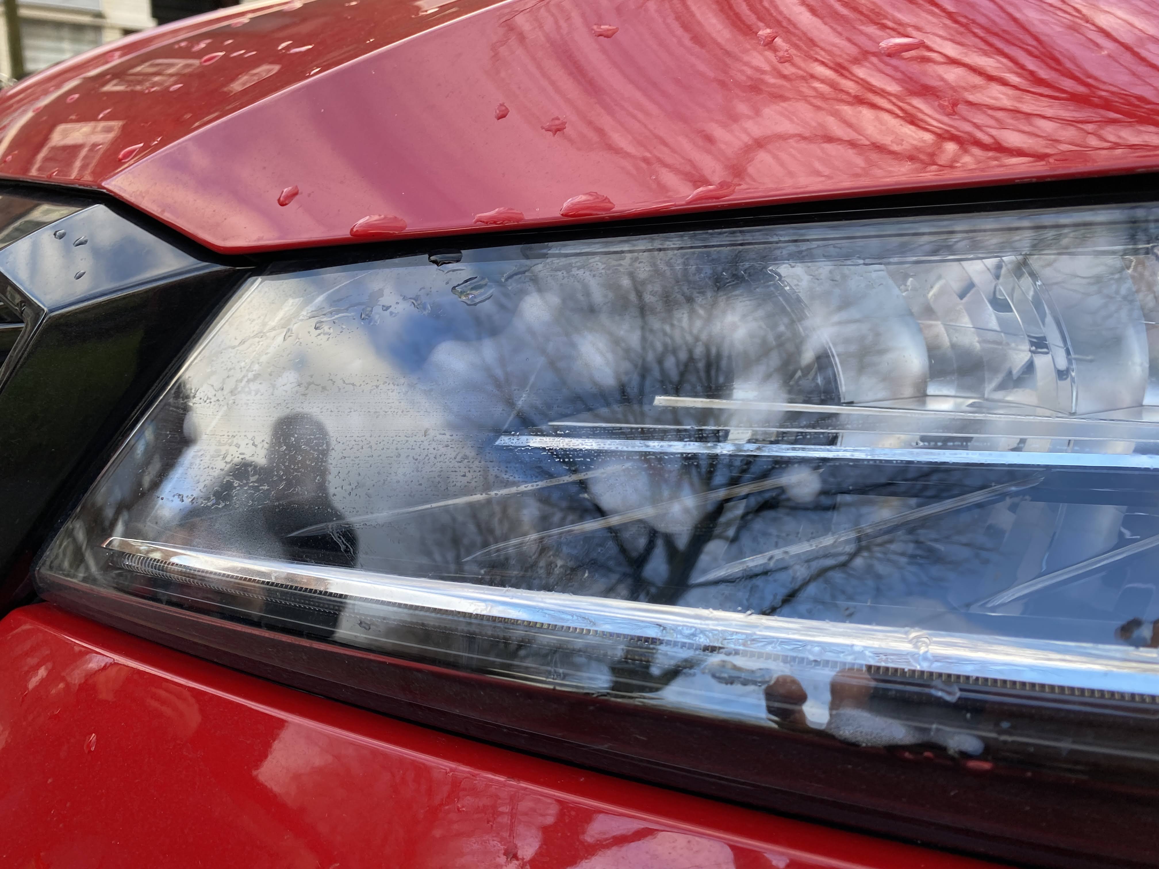

  12. Apologies for opening this topic! It raised immediate concerns, but should have investigated this more. It is even in the manual that this does not cause any harm and is "to be expected" (I can post a screenshot of the manual page, but since it's in Dutch the value is somewhat limited.) In short: This is what Skoda believes is normal on these humid, cold days of the year. I thought this would even cause failure of MOT (Dutch equivalent: APK) but it doesnt seem to do so. That was with old cars.
  13. Hi all, I have noticed that my 1 year old MK3 with full matrix LED head lights (not sure if that's relevant, but better be as detailed as possible) has moisture in both headlights. The car is a year old. Its hard to clearly capture, but visible on both these pictures: Is that something that needs to be addressed? Or is that expected and "normal"? One 1 picture you see the "dots" (left headlight) and the other a big cloud near the center of the car (right headlight)
