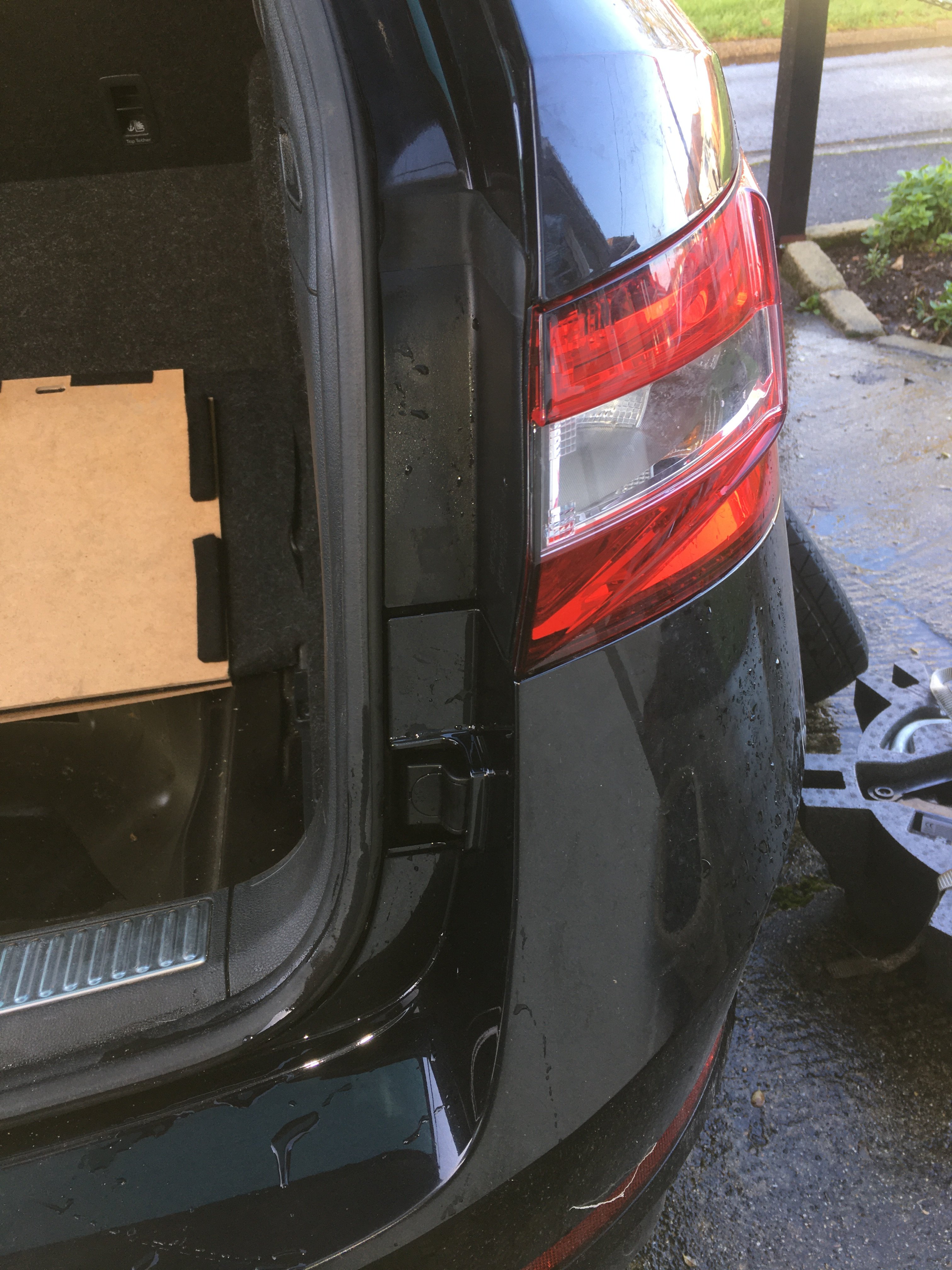

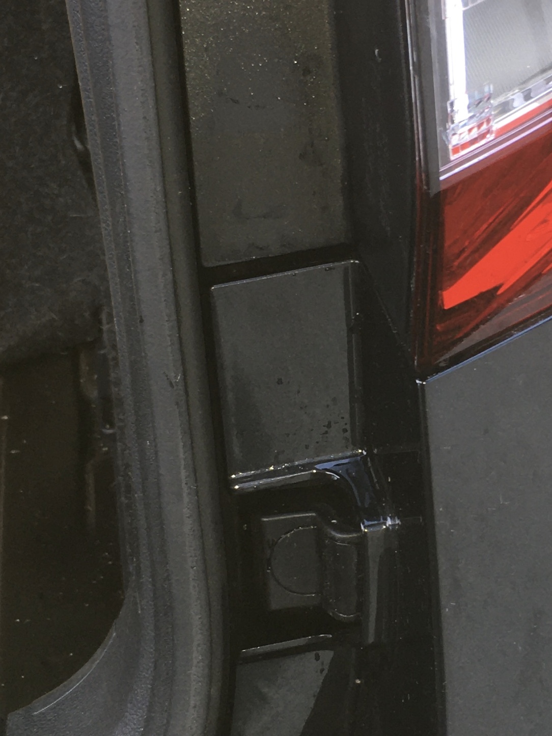

  7. Thanks for reply. Done that, the water just goes under it and further down through the bump stop thing inside, then most goes under the car apart from what leaks into the wheel well.
  8. Thanks for reply. I've had a look around the tail light and done some water test. It seems the water is going in the big catch, then some of it leaking inside to the wheel well. Where as the other side, the water goes into the big catch (seems it's meant to do that) but just then drips down under the car. I just wonder if when the towbar was fitted some damage was done. Any ideas please?

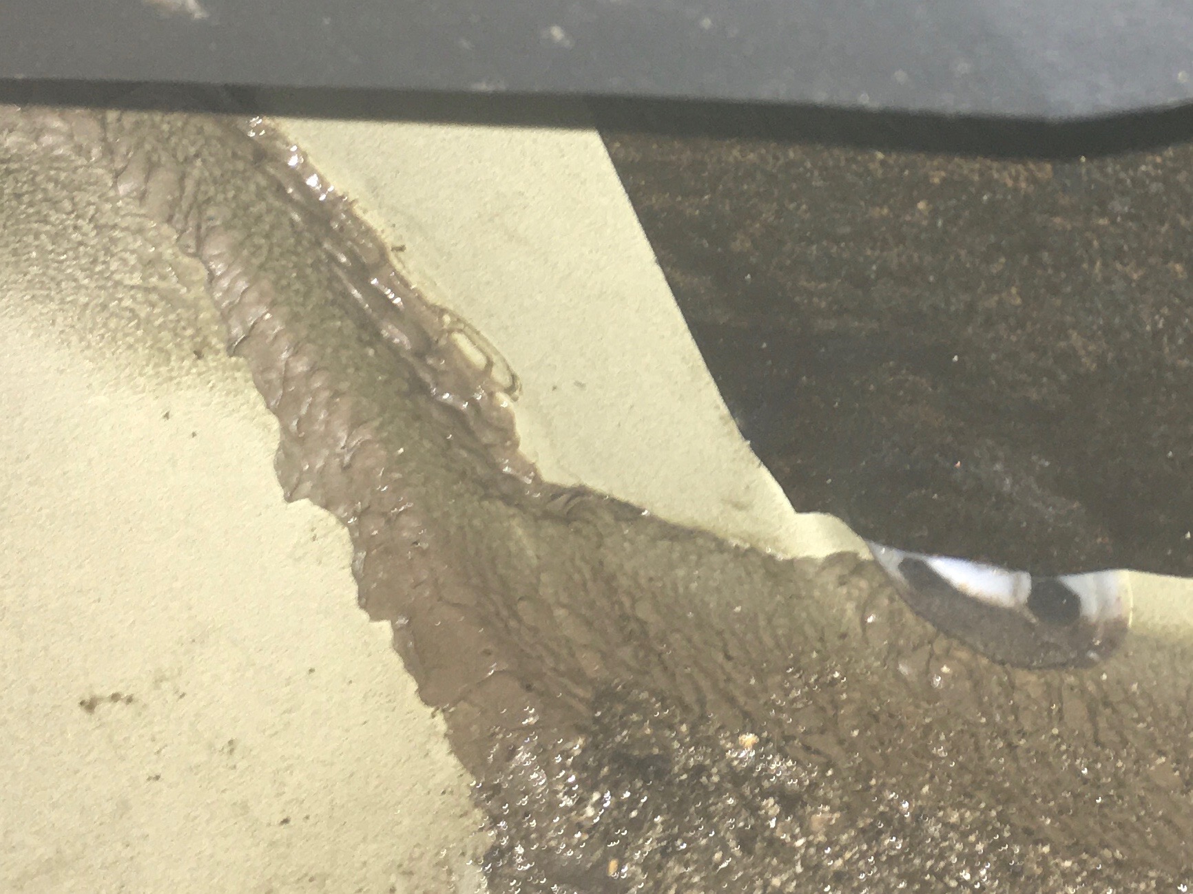

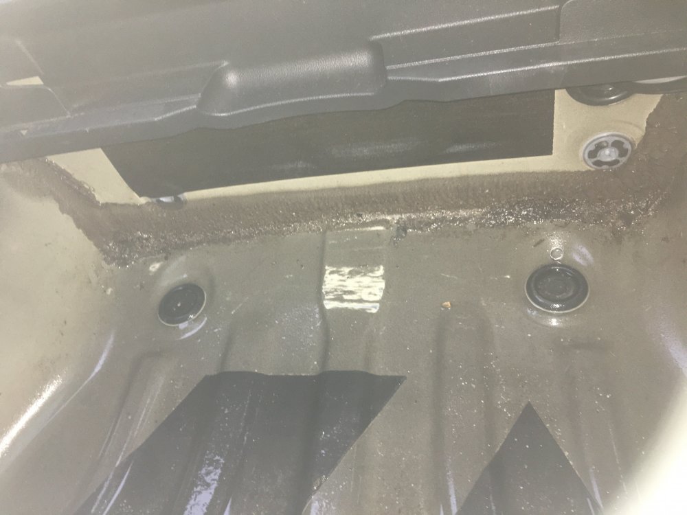

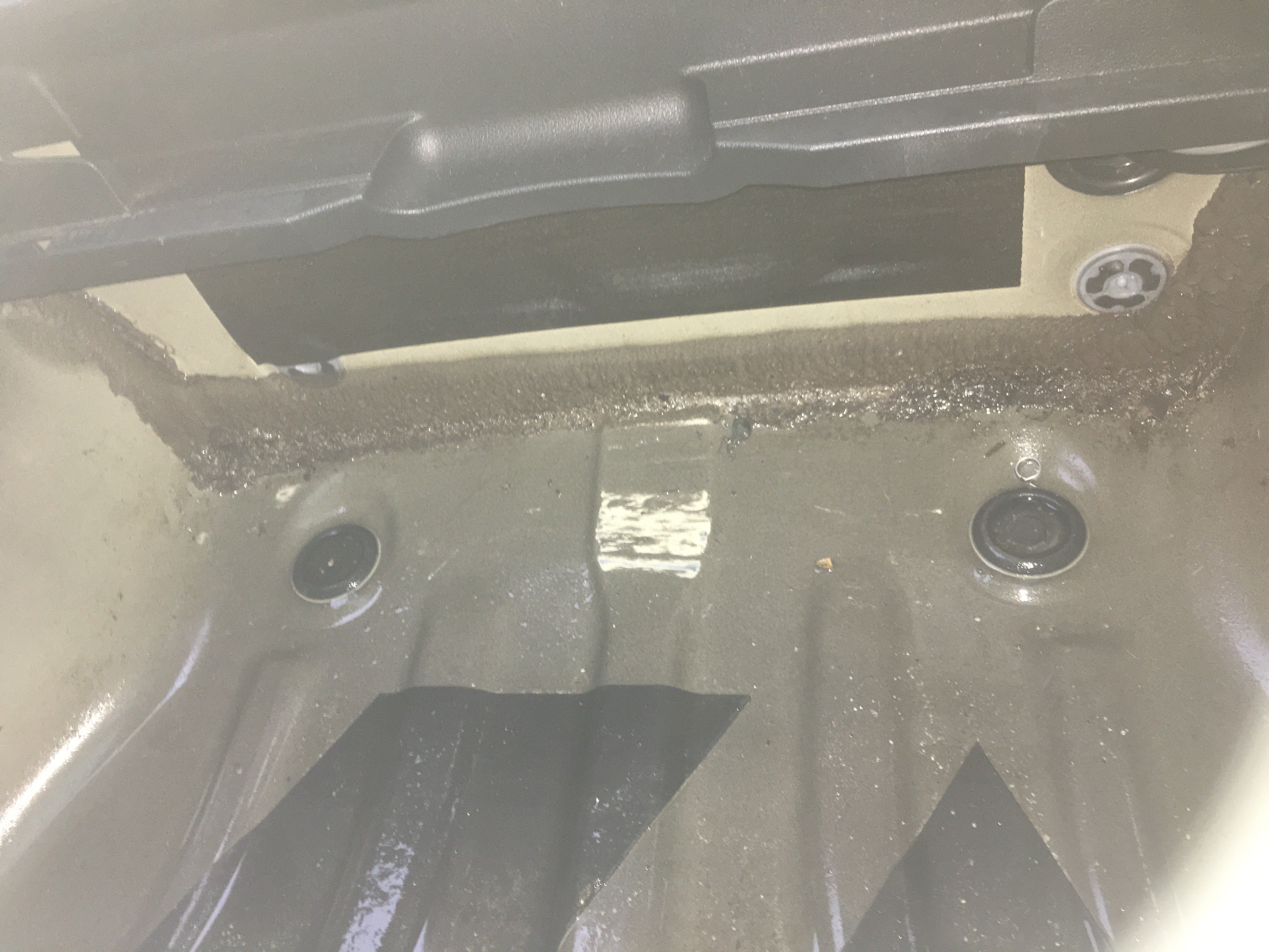

  9. It seems I got a bit carried away in my first post. Yes, I have a water leak where I said, however all the weilding stuff I thought might have been done afterwards, after looking at pics of other wheel wells, is the factory weilding. I'm still after ideas on how the water is getting in though.
  10. Bought my 2016 Superb two months ago. Noticed the wheel well was full of water, sponged it all out. In the "close up" picture, the water seems to be coming from the centre of the picture in the corner of the weilding stuff. Not sure what the light brown stuff is, wether it's some sort of wielding or something. The garage I bought the car off, had a tow bar fitted, at my request, you can just see the wiring in the top right hand corner of the second picture. A bit concerned as in my laymans knowledge, the light brown weilding stuff looks like it's been added and maybe the car has been in an accident? I've contacted the garage I bought it from, they said to bring it in for them to have a look, which I will do, but as I need the car for work I can't take it in until the week after Christmas. Any ideas appreciated, thanks in advance.
