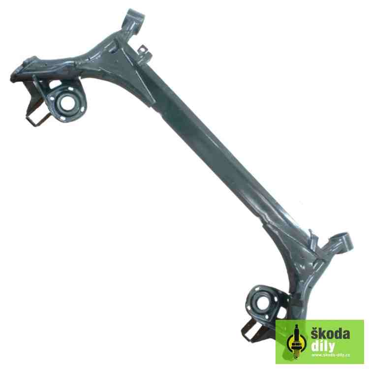

  5. Hi Pete I have included a pic of a fabia mk2 axle can you mark where i should place the stands thank you
  6. Hi Murdockman I was'nt very clear I have a trolley jack and axle stands, but where to put the axle stands if the jack is lifting the car at the jacking point can I put the stands below the rear shock and springs
  7. Hi I`m trying to do my wife's rear brake shoes on her 2010 Fabia mk2 1.6 tdi, I have searched everywhere and cant find any info on where to place axle stands to get the rear of the car off the ground. Some sites say to place the stands on the rear jacking points, how can you do this if the jack is there lifting the car, I`m so confused and when looking under the car I can`t see any safe place to place the stands any help please with pics would be very much appreciated

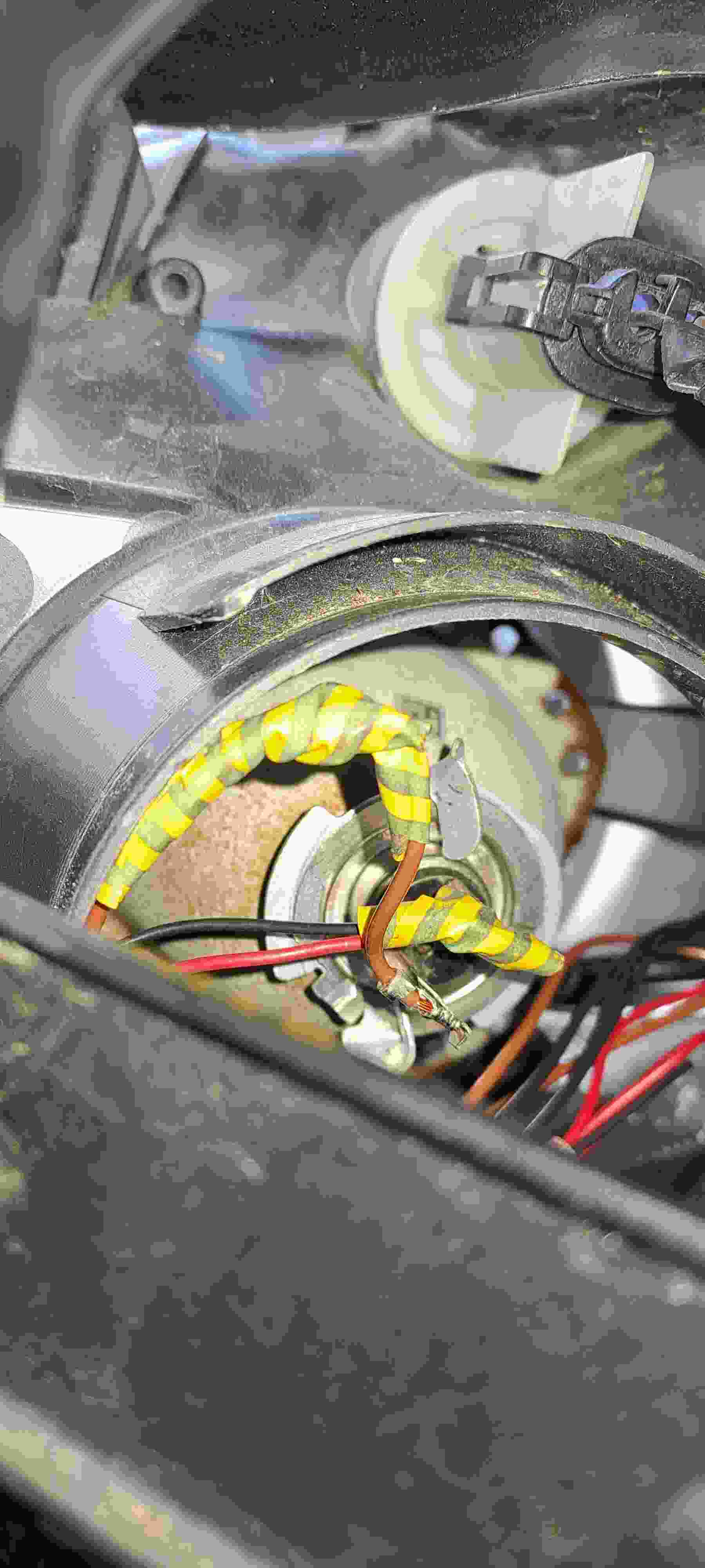

  8. Its worse than I thought looks like they have bent the retainer tabs on the back of the headlight to try and hold the bulb in. why why🙄
  9. Will this hold the bulb in place or will I need a retainer clip too
  10. Hi I have came across a problem with the wifes headlight, the dipped bulb has gone on the drivers side and I went to change it only to find there is no plug or retaining clip. Looks like the last owner had trouble fitting the blub because of the diesel filter and rather than move it they butchered the black socket that the bulb plugs into. They have removed the plug so the blub is plugged onto the harness and just set into the projector lens. I have searched all morning to try and find a replacement plug with retainer to repair it but have had no luck, can anyone point me in the right direction as to where I could buy a plug to attach to the wiring harness for the headlight as at the moment its just flopping around and will fail Mot on beam pattern.
