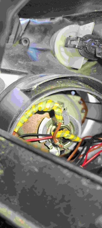

Its worse than I thought looks like they have bent the retainer tabs on the back of the headlight to try and hold the bulb in. why whyπ

Hi I have came across a problem with the wifes headlight, the dipped bulb has gone on the drivers side and I went to change it only to find there is no plug or retaining clip. Looks like the last owner had trouble fitting the blub because of the diesel filter and rather than move it they butchered the black socket that the bulb plugs into. They have removed the plug so the blub is plugged onto the harness and just set into the projector lens. I have searched all morning to try and find a replacement plug with retainer to repair it but have had no luck, can anyone point me in the right direction as to where I could buy a plug to attach to the wiring harness for the headlight as at the moment its just flopping around and will fail Mot on beam pattern.

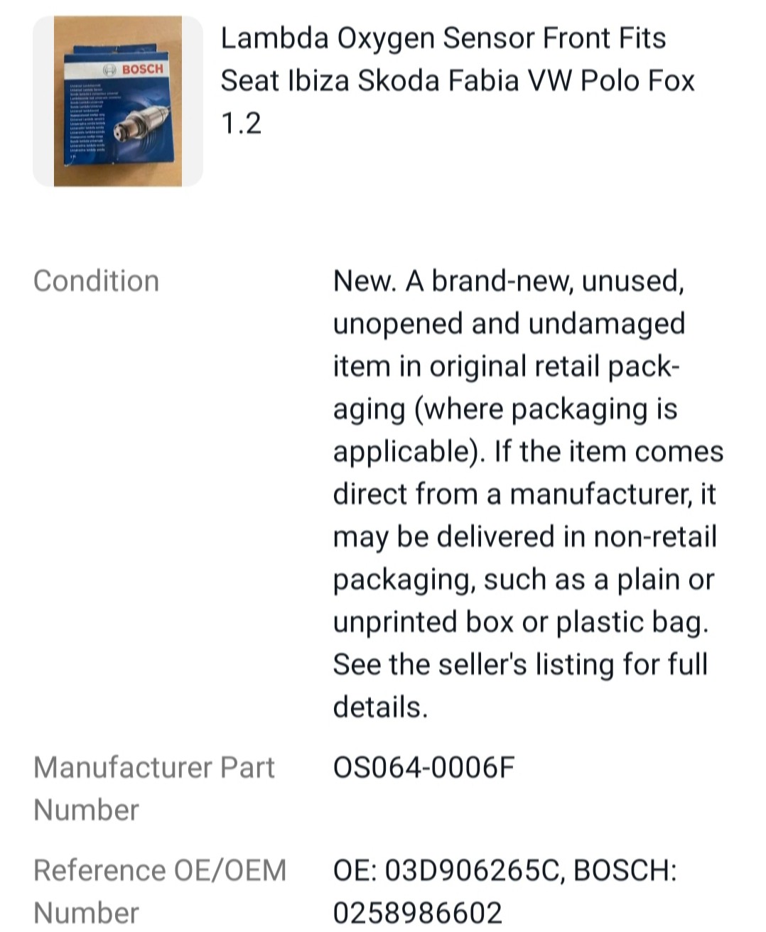

Hi wino had a good look on google and ebay the difference seems to be just the plug found it on ebay says its for awy/bmd 1.2 engines but plug might need adjustment. I have seen them on other sites too with no plug just bullet connectors , also on the autodoc web site it says its a universal sensor and is compatible with 1.2 awy and bmd engines so might just grab it anyway at that price

Ahh is see the difference that one is part number 03D906265C and mine needs 03D906265 any idea what the difference would be

I know what you mean wino seen this on a local selling group for Β£15 think is the right one for my car so was going to take a punt at it

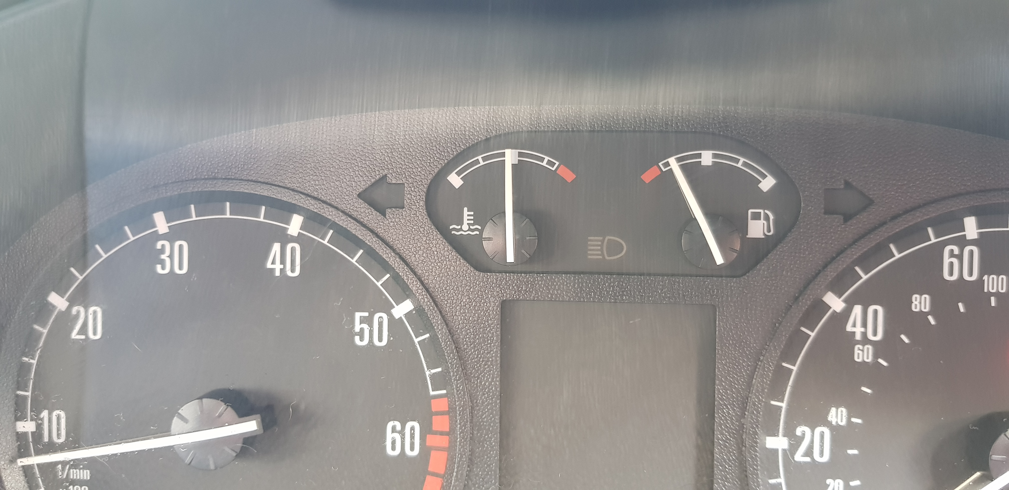

Thanks guys for all your help and advice i will check with vcds every week or so and see. Wino i had only done a few miles before the temp needle was vertical and at correct temp. As i have only had the car a few months and not sure when o2 sensor was last changed or ect sensor i wonder would it be worth just changing them anyway, the car itself drives great except for a slight judder when pulling away but i put that down to me not giving it enough gas at times as its not every time i pull away that i get the judder. Other than that its a great little car for nipping around townπ

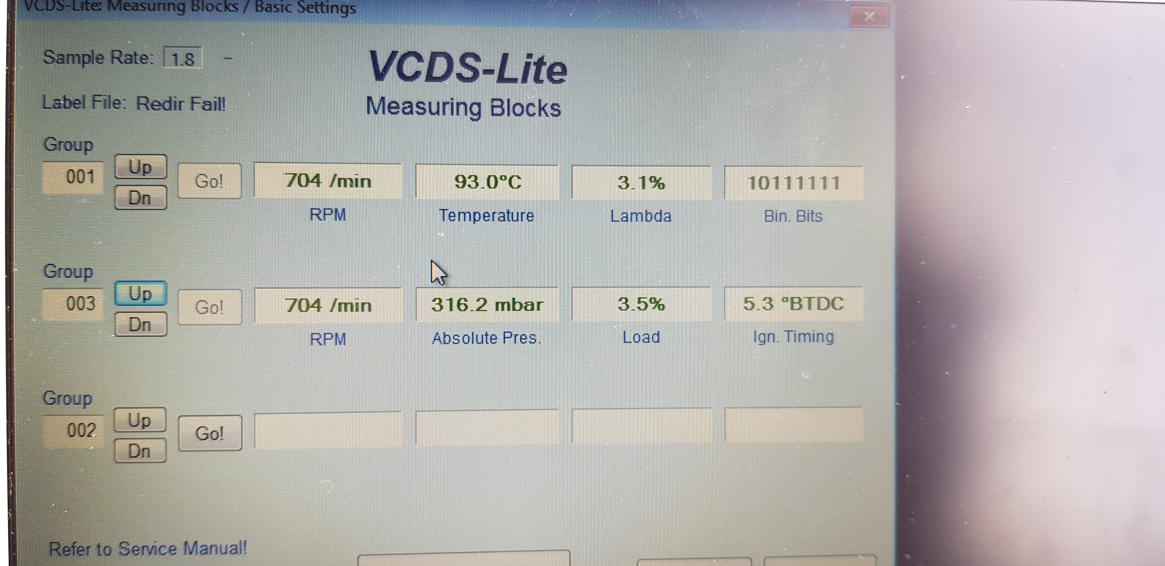

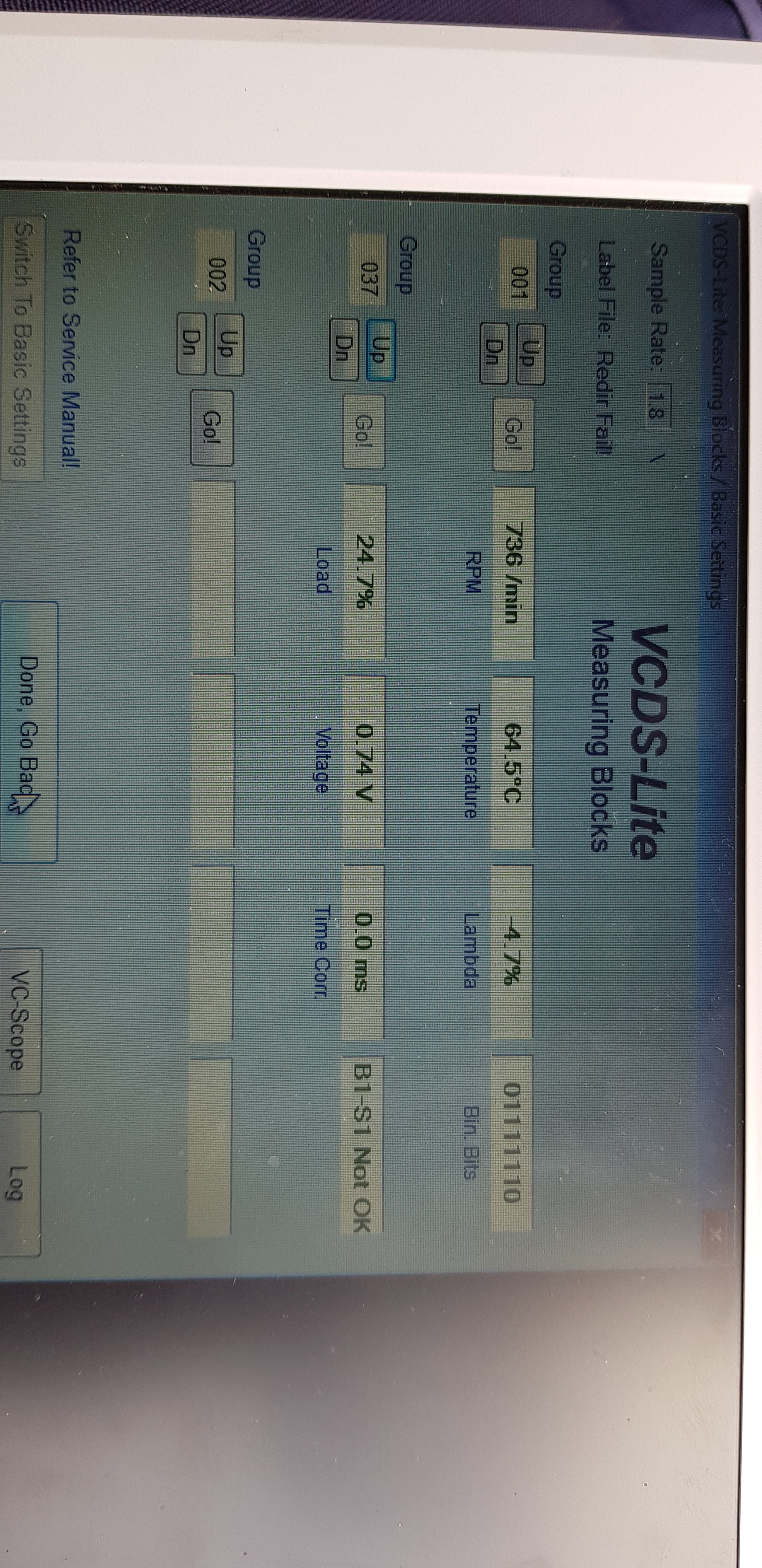

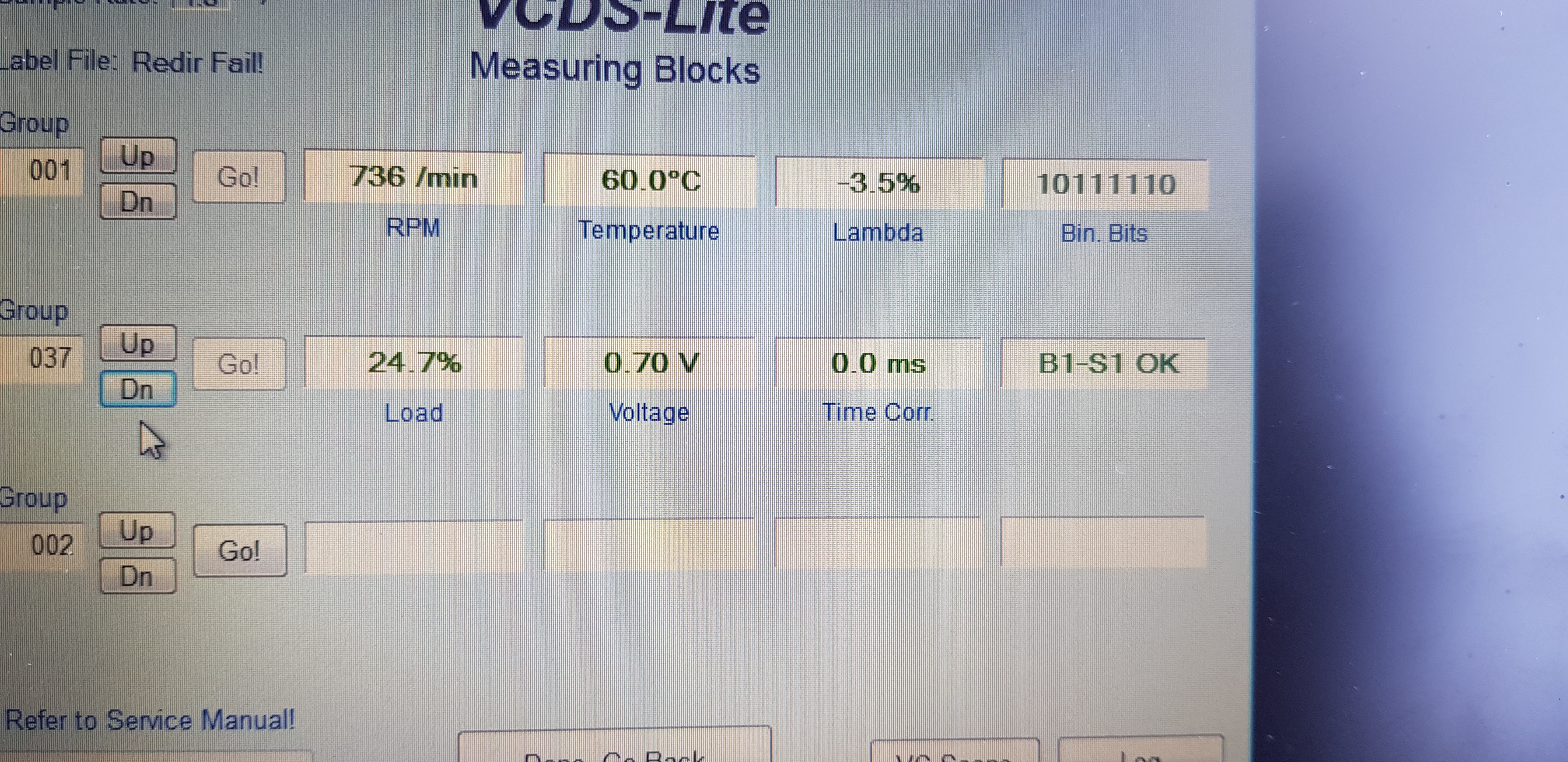

Ok ..so took the car for a drive up the motorway for italian tune up and then connected vcds when back at home and the p0172 has not returned yet but ect on vcds was up to temp as you can see from the pics so still a bit puzzled as to cause of the fault code

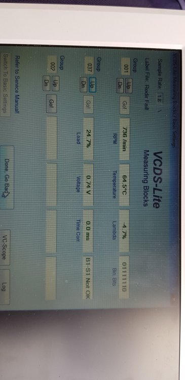

Hi wino no didnt take it for a drive but what i did notice after I checked for vacuum leaks and locating pcv valve was when i connected back up to vcds bk1 sensor 1 was now ok do these sensors blip from working to not working when failing or do they just fail

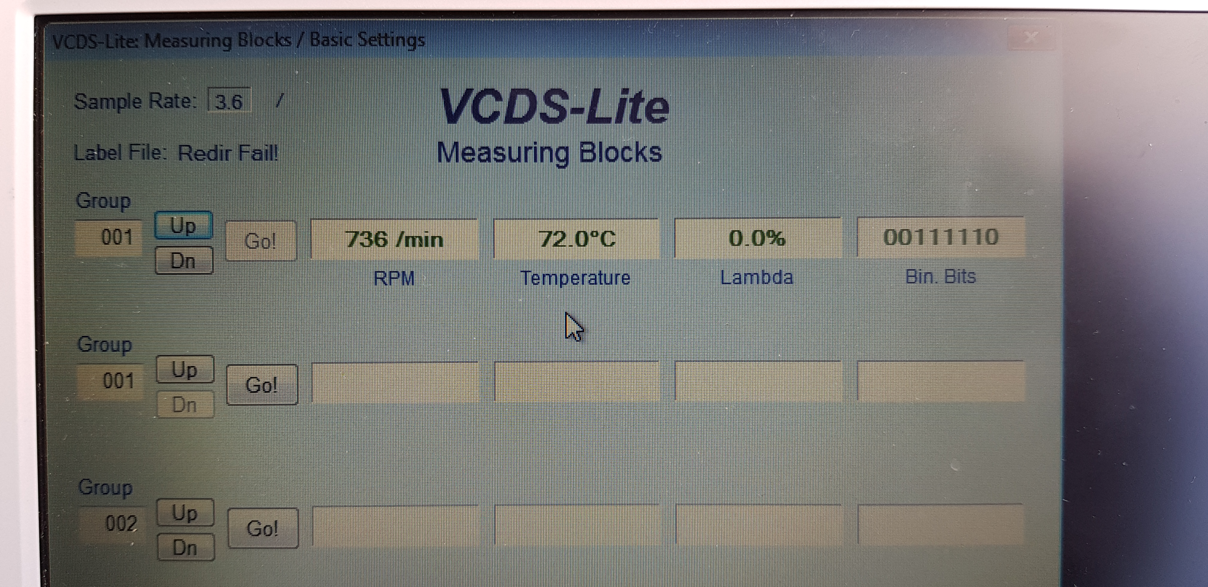

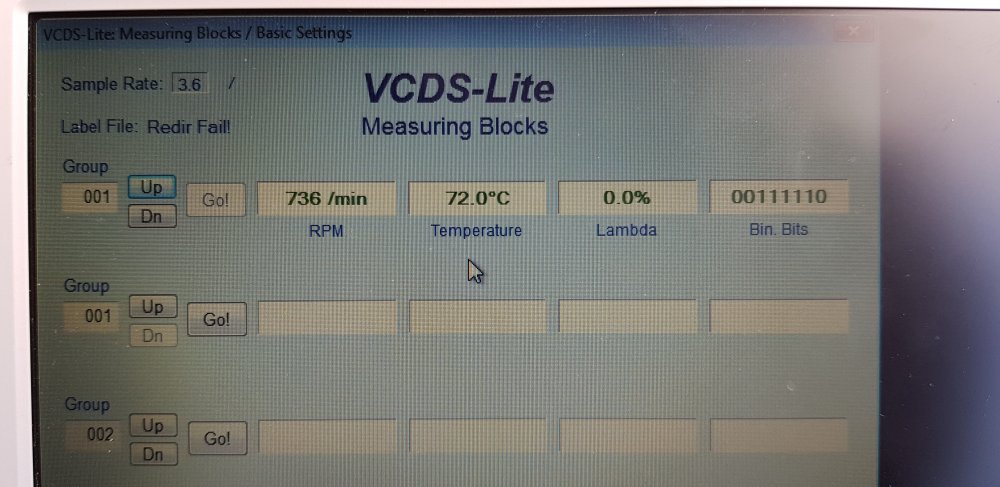

Ok hooked up vcds and took a few pics ECT was bang on with outside temp at start up. I took a few pics of other blocks still trying to work out what they mean
