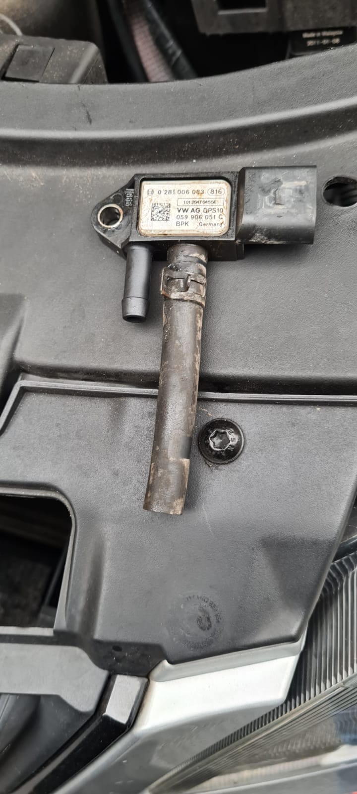

  1. That sets my mind at rest. Thought it had been cut for some reason. All the videos i watch, one of the pipes goes before and one after dpf. Thanks for the reply
  2. Changed my dpf pressure sensor but one of the pipes looks to have been cut. Anyone any ideas as to why? Only owned the car 6 months and recently had dpf issued and limp mode.

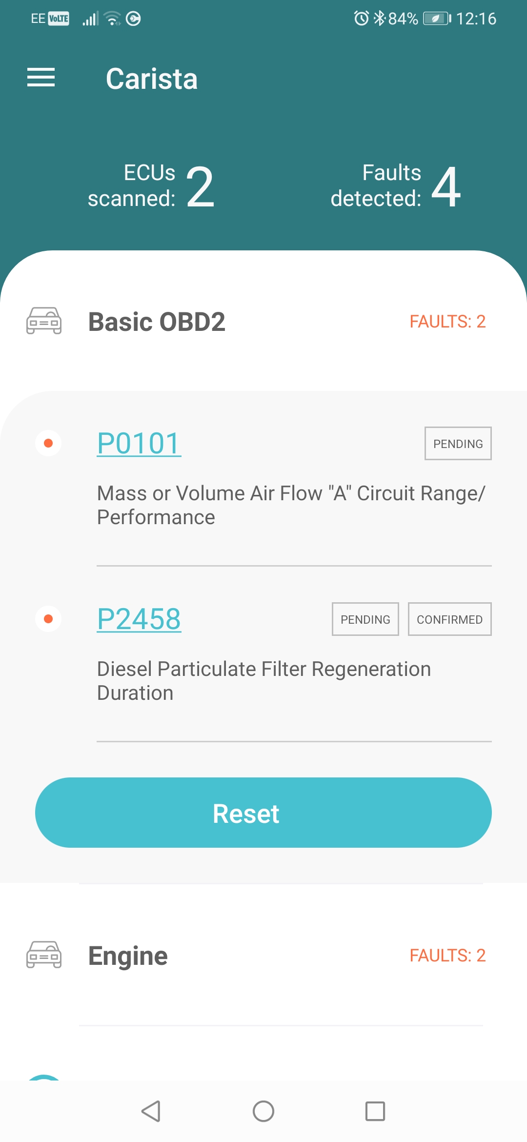

  3. Think its had a egr delete. Not sure though. Tried unplugging the maf. Just dont want to put one on if its a faulty wire

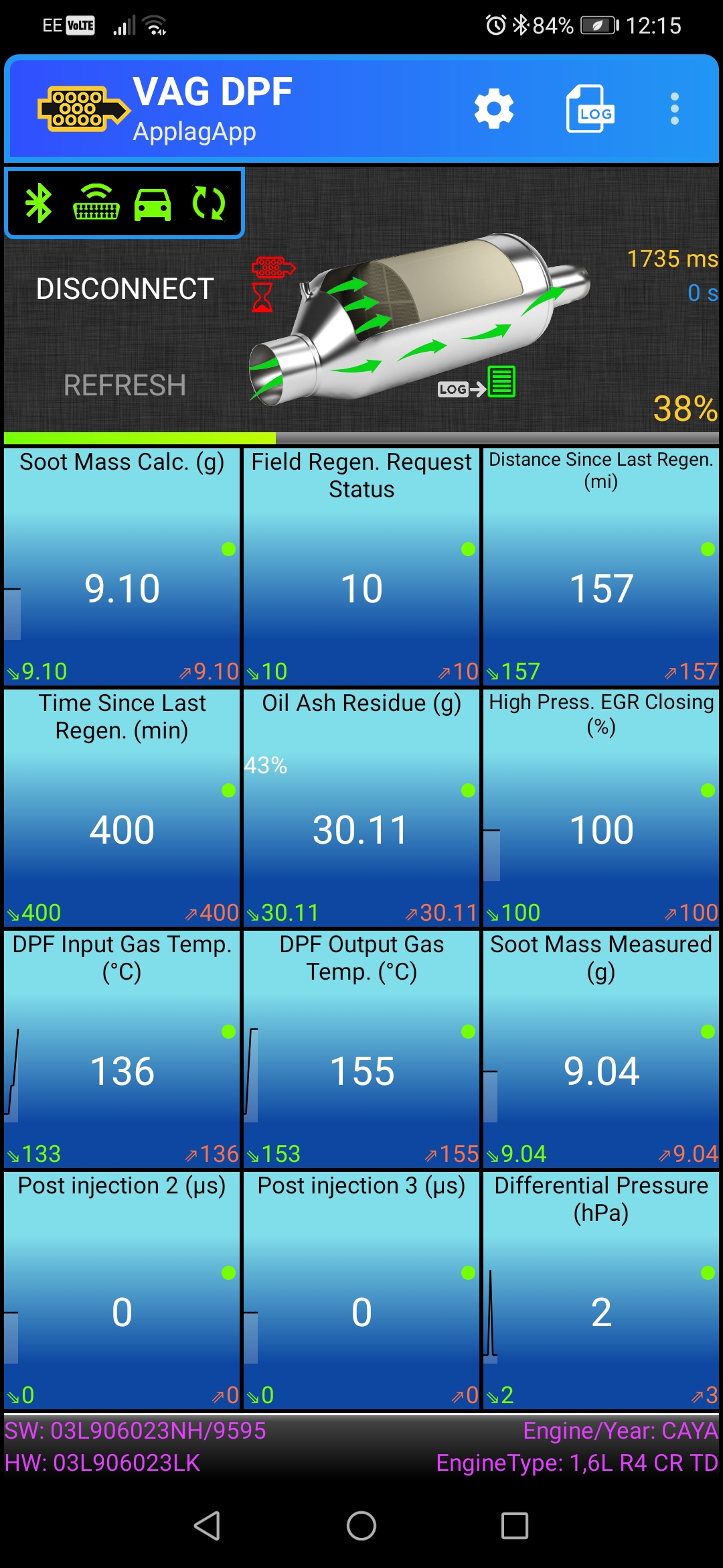

  4. I bought 20 litres of mannol 507 for 40 quid delivered off ebay for my 1.6 fabia. Thought that would give me 4 oil changes and do every 6 months. However a week after my dpf light is on and in limp mode, now i am wondering the coincidence. My soot is now at 9grams and still cannot get the warning lights off.
