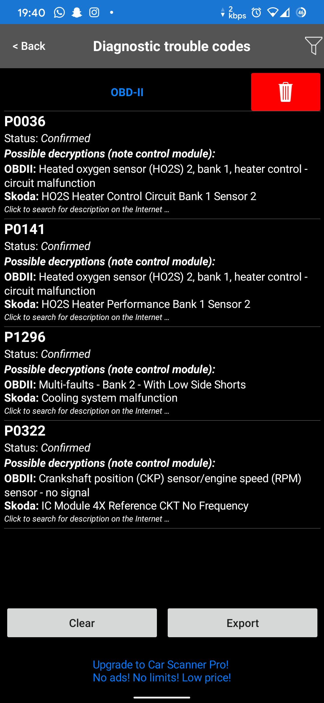

  3. Attached a screenshot of OBD scan. Disregard P1296 as it is solved (replaced thermostat), it just completely slipped my mind to clear the code(s) last time I scanned.
  4. P0322 Status: Confirmed OBDII: Crankshaft position (CKP) sensor/engine speed (RPM) sensor - no signal Skoda: IC Module 4X Reference CKT No Frequency Does not seem to specify that it is intermittent, but the car does lose RPM signal when the car tries to stall out but recovers I do not know yet, it hasn't even left the store I ordered it from. I will be running VCDS lite though so I assume I can't do data logging

  11. Thank you for your reply. I did a scan about a week ago when this first started and here is the output: Car Scanner ELM OBD2 DTC report Selected brand: Skoda ============1============== P0037 Raw code: 0037 ECU: OBD-II Status: Confirmed OBDII: Heated oxygen sensor (HO2S) 2, bank 1, heater control - circuit low Skoda: HO2S Heater Circuit Low Voltage Bank 1 Sensor 2 ============2============== P0141 Raw code: 0141 ECU: OBD-II Status: Confirmed OBDII: Heated oxygen sensor (HO2S) 2, bank 1, heater control - circuit malfunction Skoda: HO2S Heater Performance Bank 1 Sensor 2 ============3============== P1296 Raw code: 1296 ECU: OBD-II Status: Confirmed OBDII: Multi-faults - Bank 2 - With Low Side Shorts Skoda: Cooling system malfunction
