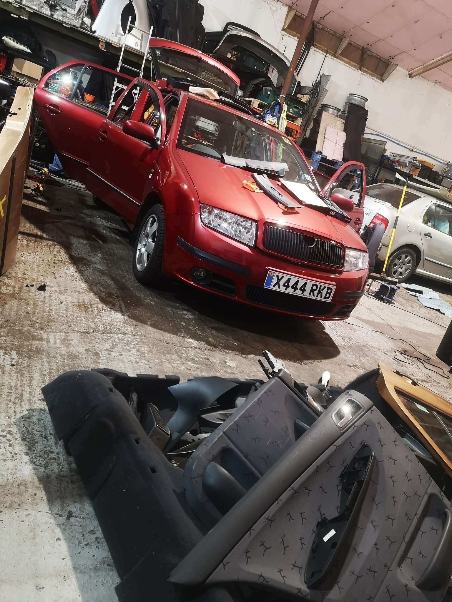

  10. Not quite the same thing, but my mate (who isn't on here I don't think) and I retrofitted rear electric windows from a donor Elegance to my old 2006 Mk1, although being a later one there were some CAN/LIN incompatibilities. I think the main thing I'd advise is making sure you have a Comfort Control Module that is capable of running these things, as I know there's a certain spec of these that have a stripped down system that cannot be adapted. @Tech1e might know more than I do about this actually.
