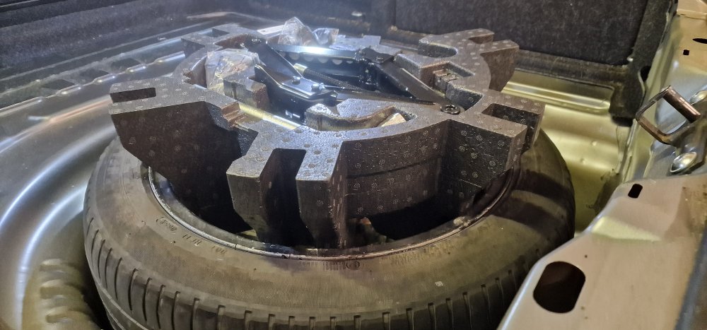

  2. It's supposed to be designed to fit inside the spare wheel but it wouldn't have gone inside a skinny space saver. I don't want to trim it unless I make a mess of it and can't take it back. They have a 16" toolkit in stock so I'll try that first. This will do for the meantime.

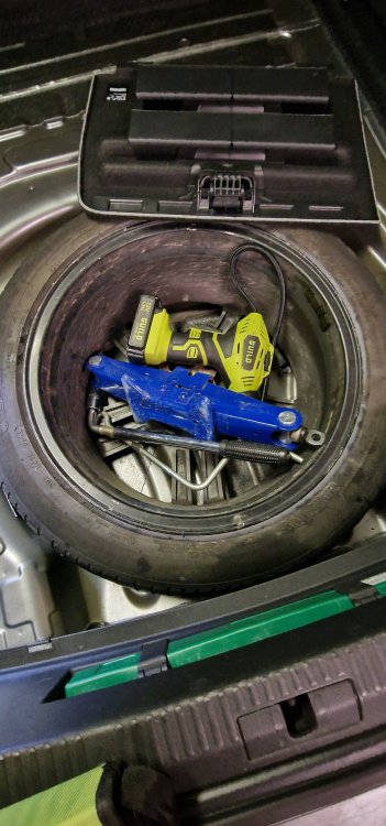

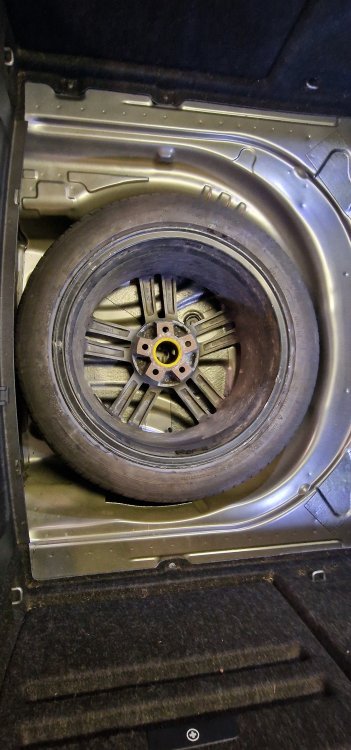

  3. naster, it has gone in but only just. No need for cutting the trim. Pity the Skoda tool kit doesn't fit even though it's supposed to be for an 18" wheel.
  4. And there we have it. A full size 18" alloy with 235/45/18 tyre and no cutting of trim to be done. Yes it sits a few cm above the level of the boot floor but that's easily remedied with some foam or the like. What I can't understand though is that the 18" tool kit from Skoda doesn't fit flush inside the wheel. Never mind, I've got a spare scissor jack that can sit inside the wheel. Job done although it is a shame to lose the storage that was in the foam insert.
  5. Naster, for me it's not just to get to the nearest tyre shop. I'm a self employed taxi driver and if I'm on a fare and have to put on a space saver then my fare terminates there and then. I also can't continue working at all until I have the tyre is repaired. And there's a good chance that my tyre would have to be ordered which means I can't work until the tyre arrives. All this time I'm losing money. Not only that, I tow a caravan and don't want to be towing it with a poxy space saver on my car if I was to have a blow out. I wasn't keen on cutting the trim but I've come round to the fact that I'll get a full size alloy in there and no one but me will know or see that the trim has been cut. If I come to sell the car then I'll explain why I did it and the new owner would have the choice of leaving it as it is or sourcing a new trim from a breaker or whatever.
