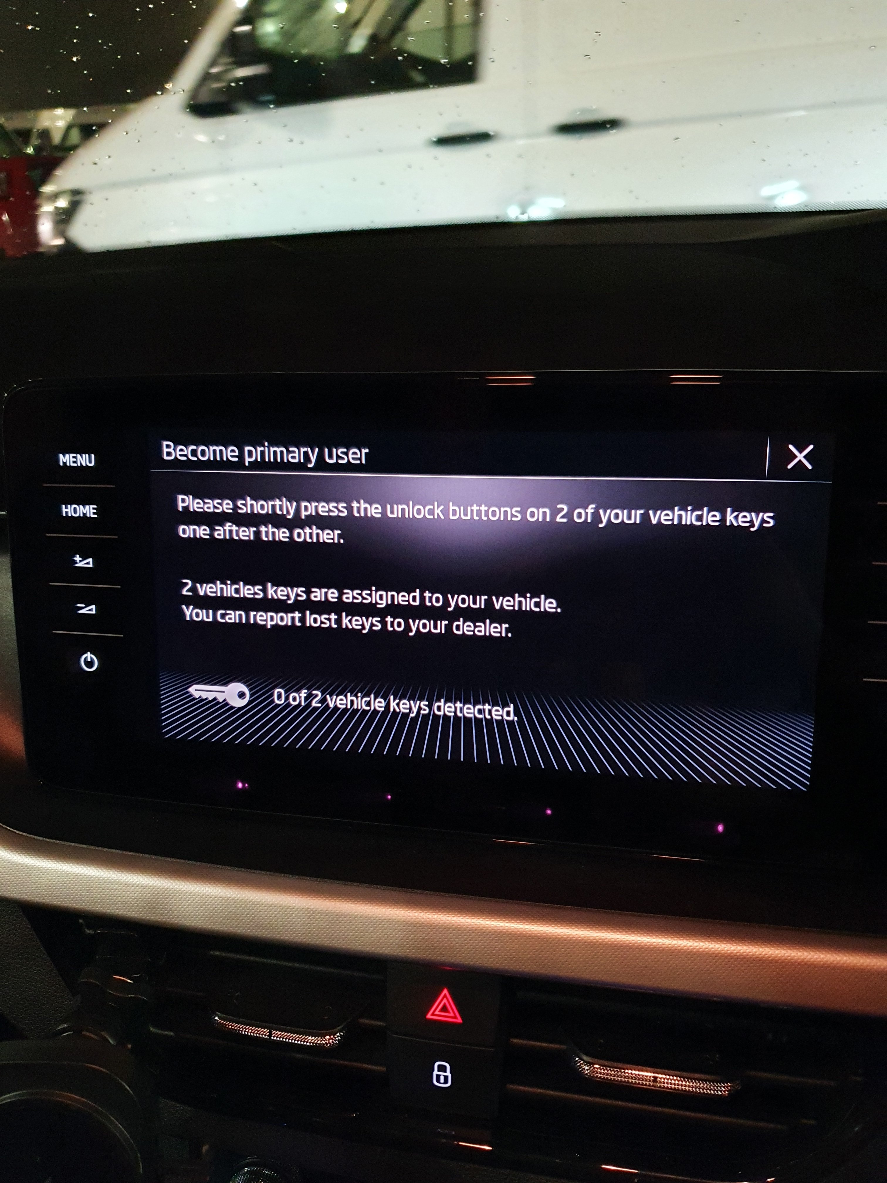

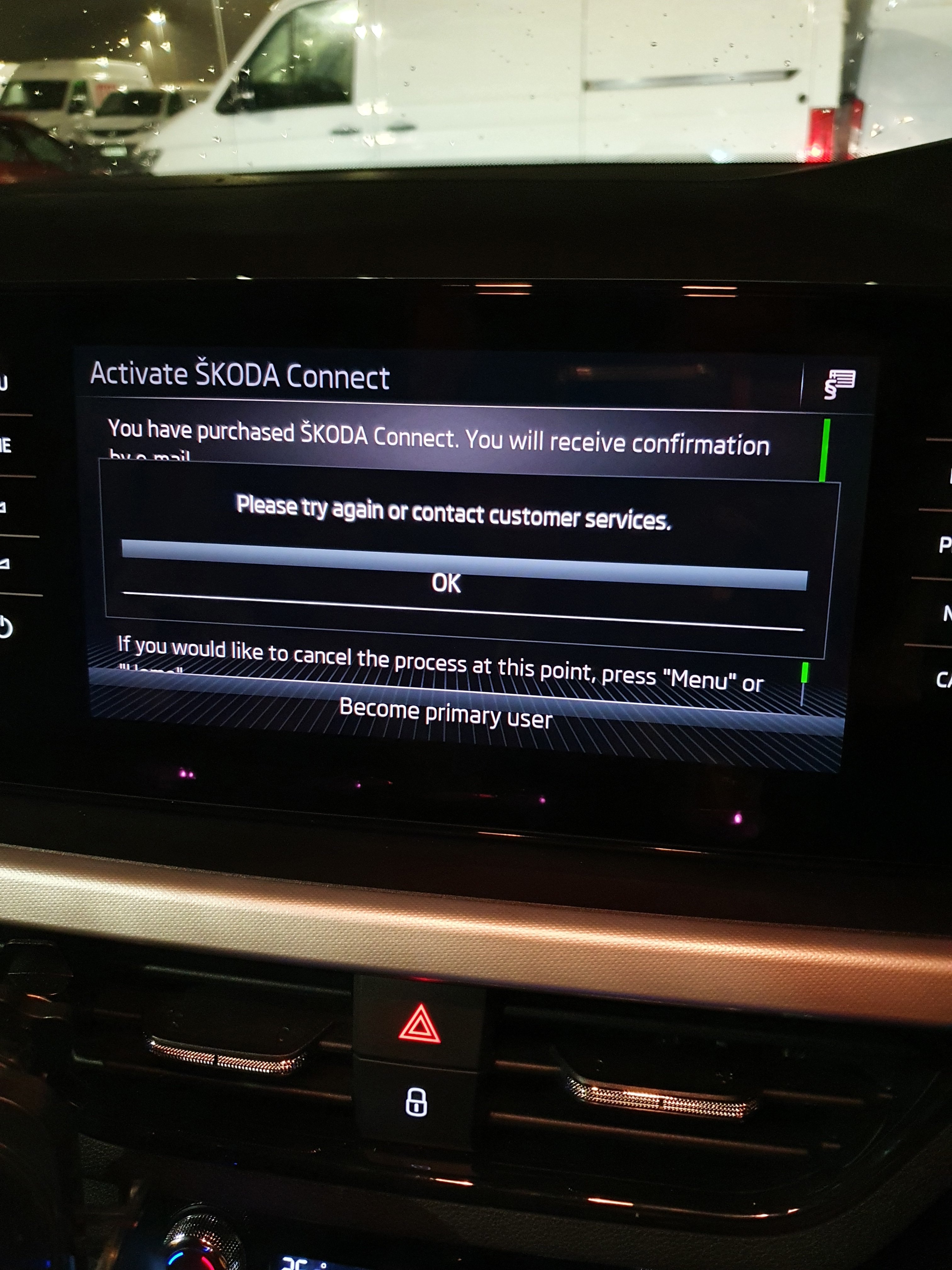

  3. UPDATE! My skoda kamiq finally went back to the dealer today for them to look at why my primary user wont activate. They did some tests and set up 2 dummy accounts to make sure its nothing I'm doing wrong and it's not my accounts causing the problems. Few hours later they phoned saying they are having the same issue and that it's nothing I'm doing wrong and that they will do some more testing. Couple of hours later they phoned with an update saying that they are going to have to replace the head unit and that I can keep the curtesy car till Monday. At about 4.55pm I had an email from skoda connect saying congratulations my car has now been activated for connect services 🙌 what a relief but they aren't open now till Monday so will have to wait till then to get my car back. Its been a long batter the past month and a half. My advice to anyone that encounters same issue is to go straight to your dealer as I wish I did as it was resolved in 7 hours. Thanks to everyone who tried to help I will definitely be staying on here. Will post a new thread on what I think about the new trafication app that's just been released for skoda
  4. UPDATE!! I had the manufacturers get intouch 2 days ago saying that they are going to do remote diagnostics on my infotainment system to see why my primary user wont activate. They reset everything and said it should work now. I tried again to activate primary user and still getting the same message. They don't understand why its not activating they can see i have done everything right. But for some reason the car is blocking the activation and dont understand why. They know the car is booked in for the 19th at my dealer. They said if the dealer can't get it to activate then I can have a new car.

  6. Hi I got my skoda Kamiq on the 25th of January this year and I can't activate primary user either. Done the same things as you and won't activate. Been in contact with customer service and they have been trying to get the manufacturer to help. They asked for video evidence of me try to set it up and the message coming up with when trying to activate. It has been a very frustrating few weeks with no results. The car is booked in for the 19th February for diagnostics to try and fix it but told them if its not sorted I want another car. I have paid 30.000 for this car and 17 features are blocked including the SOS button. I am disabled and the SOS is vital as it came in handy last year when I had the Karoq

  9. Skoda connect spoke to me with an update saying the Manufacturers want video evidence of me accepting the terms and conditions of the package I have for the car. They also said to delete my account and reset the car to factory settings. Then start from scratch recording me activating the primary user. To which it still came up with try again or contact customer services. 3 weeks I have had the car and still can't activate primary user. I'm guessing the head unit must be faulty and needs replacing
  10. I don't have a problem with android auto wireless its never faltered. Picked my car up on the 25/1/21 but I cannot get primary user to activate. No one at skoda connect or at the dealer knows how to sort it. Been battling with it for over a week tried creating new profiles tried activating over my own Internet rather than the cars own Internet but nothing. My profile loads up on the car ok but primary user wont activate. I need it to activate for all the advanced features so if anyone knows or have any tips then I would be grateful
