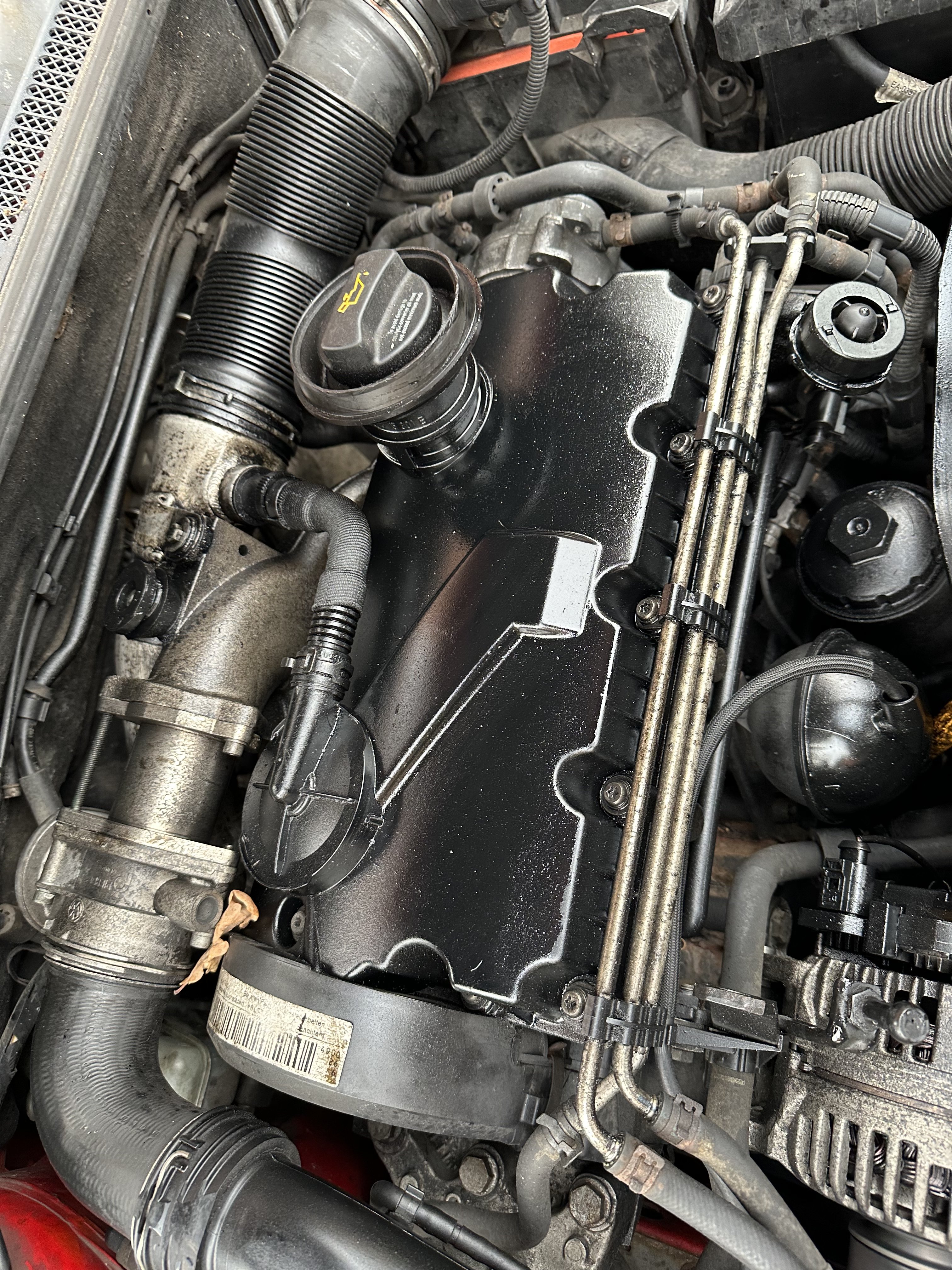

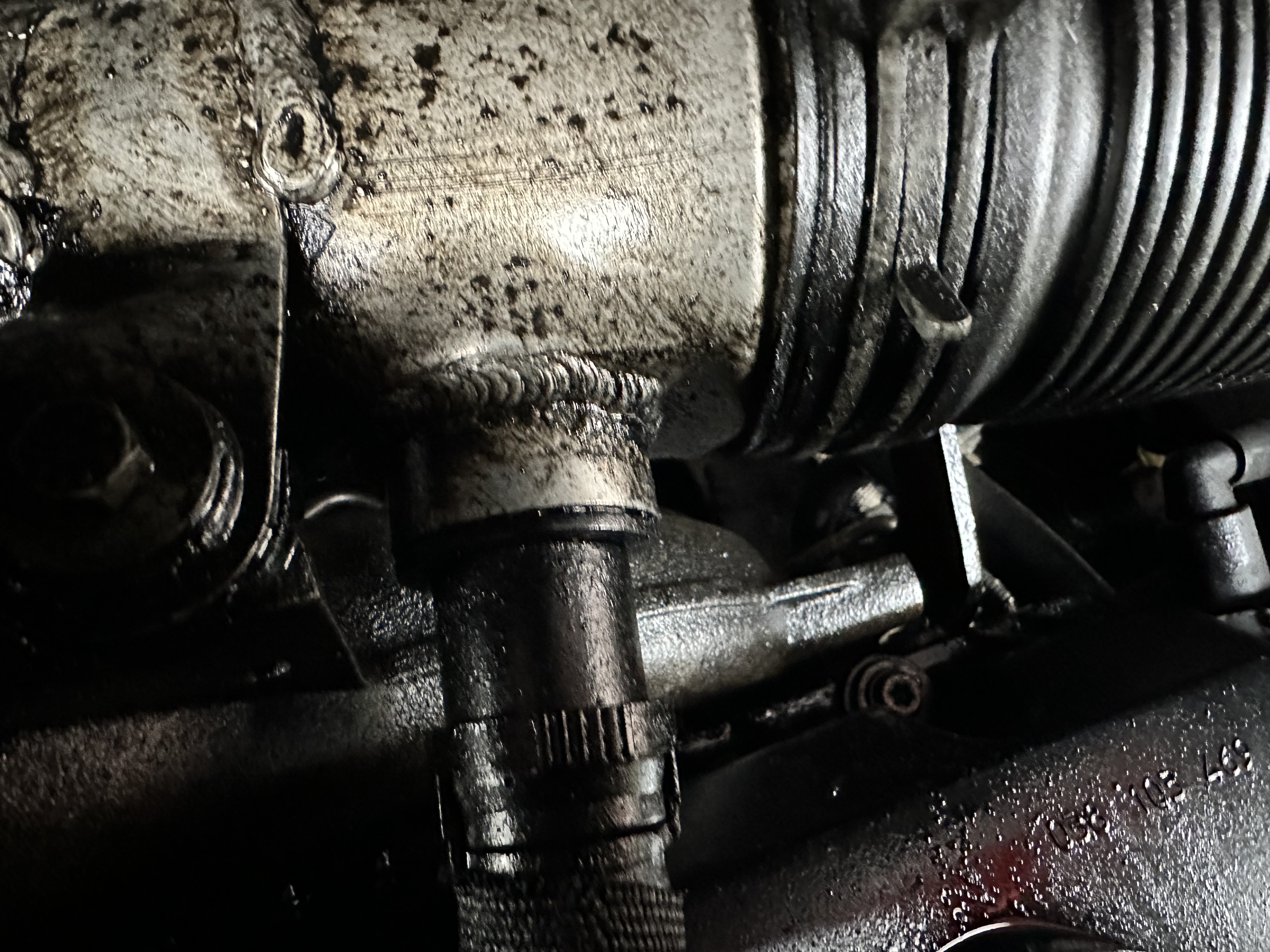

  5. So started noticing a bit of smoke on startup and my entire engine bay covered in oil, a little I can understand but this seems to be a lot. the filter is dry but the pipes have oil in them, I understand a little is normal but how much is too much? my turbo has always been a bit whistly but I am starting to think we may have a problem

  9. They don’t unfortunately, they are definitely 312mm as the previous owner got a kit and I measured them it’s just the offset which is different, he thought they came off a good gti or a Octavia vrs but now he is thinking maybe they came off the TT225

  11. I have just been looking through some of the stuff I was told about the car when I got it, man’s this is some of the oil that’s blowing all over the shop I think for the minimal mods it has it is pretty much at the peak of what it can do, he did say I could get a stage 2 map but after that I would need more. is it worth pushing any further on a 230k mile engine Xman 1752 turbo Air tech intercooler Air tech silicone boost hoses Pd150 head bolts Egr delete 312mm front brakes 215/45/16 Revo Stage 1 map

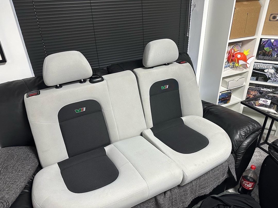

  12. I couldn’t believe the weight of the seat backs on these! I’m used to 90s sh*tboxes that are made out of recycled foam and tins.

  14. So I joined a long while ago and forgot, I also pretty much forgot to look after the car with everything going on in my life so decided now is the time to get her back up to a good condition I brought the car as a £1000 beater to commute whilst my other cars perpetually destroy themselves, in that time I have seen the prices rise and have really enjoyed the car so time to look after it. trouble is I have no clue about anything to do with these things, if it was a cosworth or a rotary no problem but this is all new to me, revently cleaned up the interior a bit as it was looking proper tatty, main issue (other than repeated new rear calipers) has been a amber traction / abs type light that comes on after a bit of driving that I cannot clear and just got a oil leak somewhere around the top end / boost pipes, are these a common problem / fix. also need to focus on the inter cooler / boost pipe work as it looks like it’s being held there with hopes and prayers. Don’t know if it’s worth putting the time in on a 230k car but she seems to be running sweet so May as well do some quick cheap fixes to keep it that way
