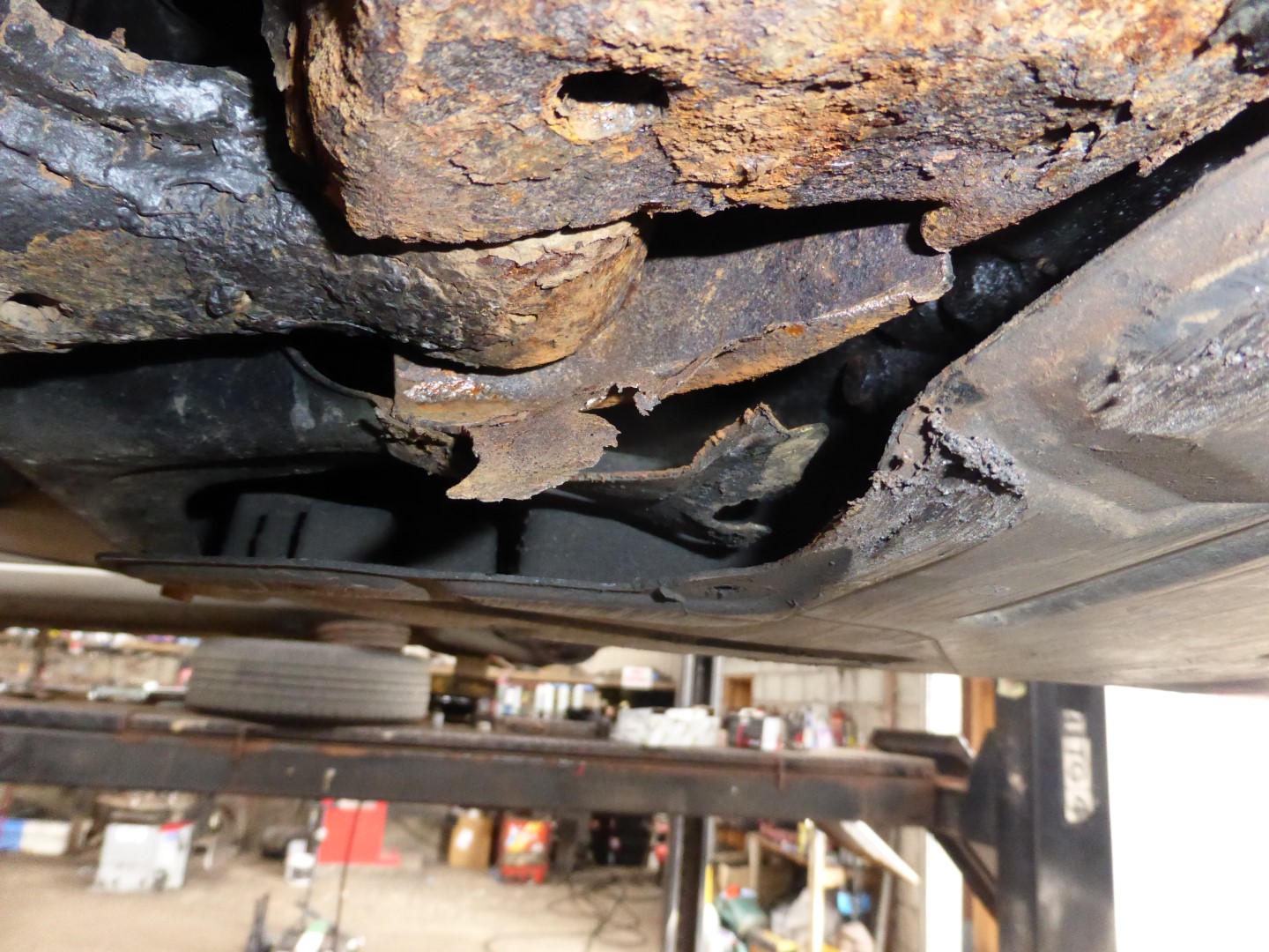

  12. Damage visable here
  13. No, right on topic my friend. I did contact the dealer, but they don't want anything to do with it, say it was old and sold as seen. As far as I understand it should be servicable for 6 months under the consumer goods act 2015. At this point it's registered letters stating demands then a small claims court battle; it's on my to do list. I have a note from a garage saying 'do not drive, dangerous rust', or words to that effect. I paid with visa debit If anyone has similar a similar experience trying to extract money from a deal, I'd be keen to hear!
