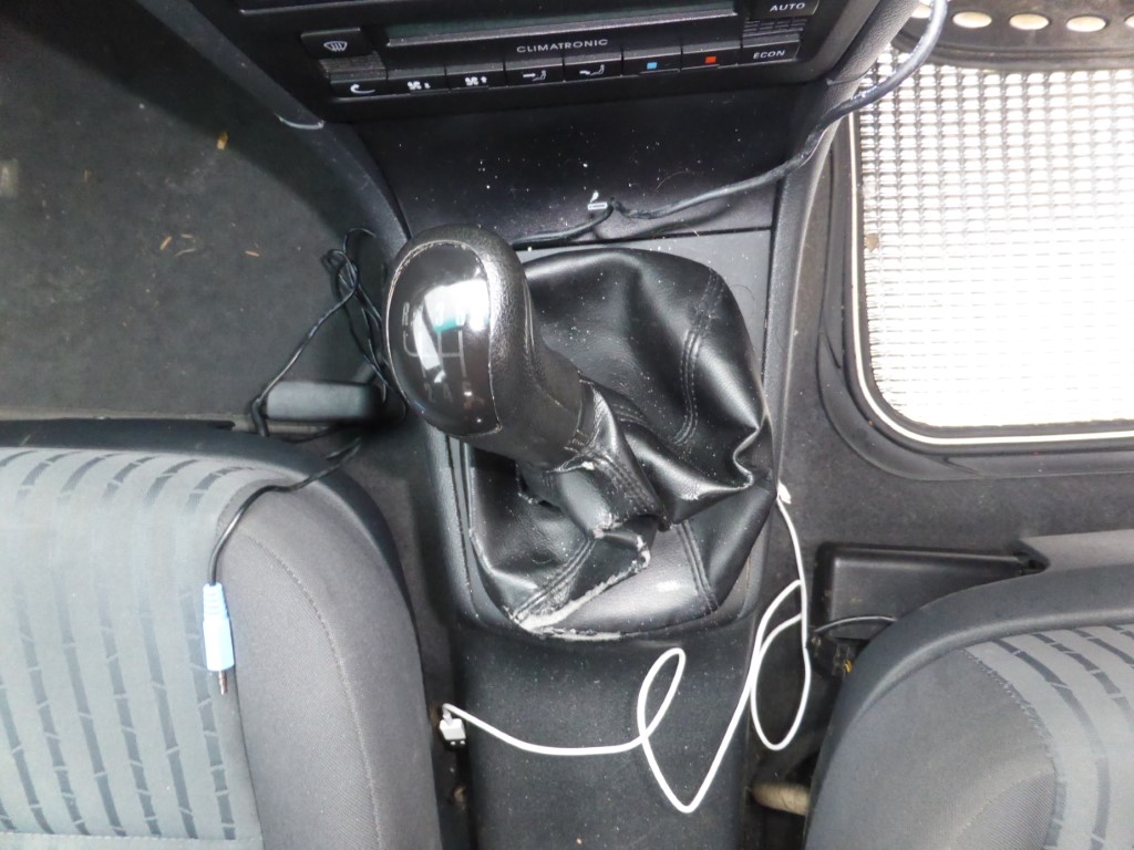

  1. Thanks, fixed it by taking out the Airbox and cycling through the gears at the gbx end. Greased pivots a bit and cleaned the top of the gbx too. There was an accumulation of crap around the linkages.
  2. Hi, I'm selling this vrs here and I'd like to make sure it's Ok for whoever takes it. It has a sluggish gearlever that doesn't really spring back to the centre. Like if your going from 2-3, you have to push it forward, drag it to center and then push to third. I guess that the linkages are a bit gummed up or something. The transmission itself feels solid so I don't think the problem is there. Any thoughts?

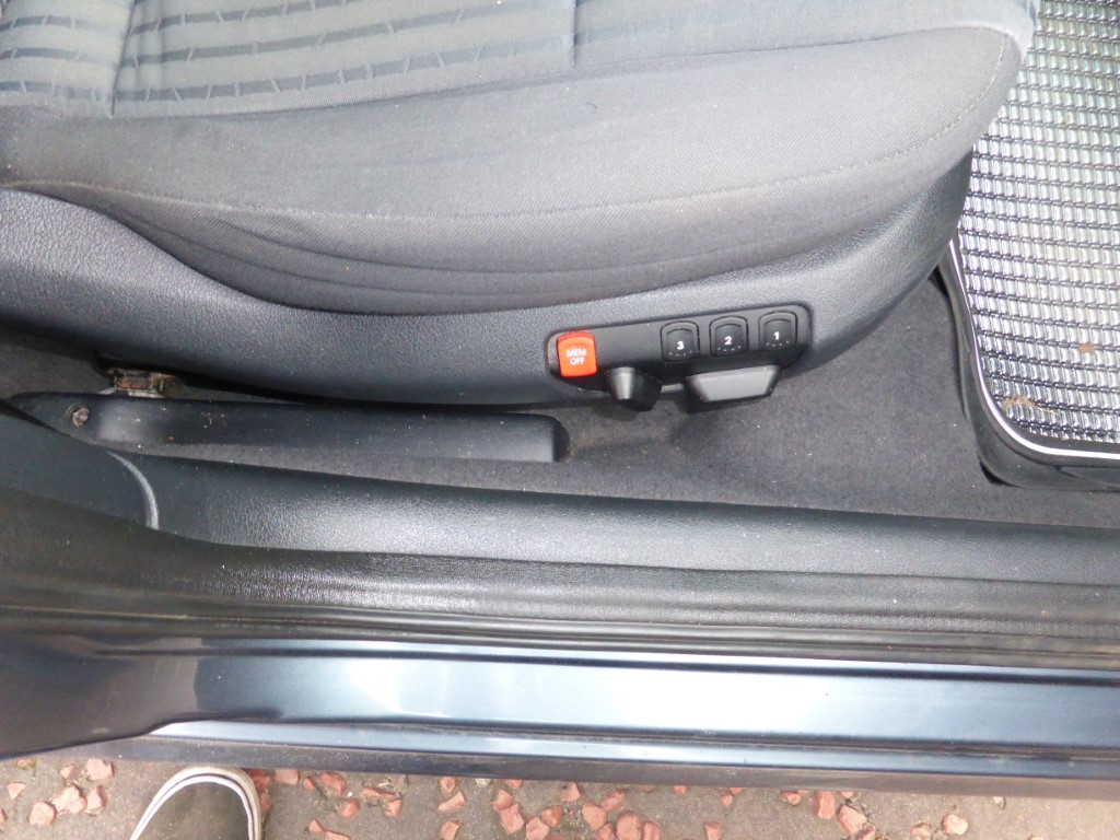

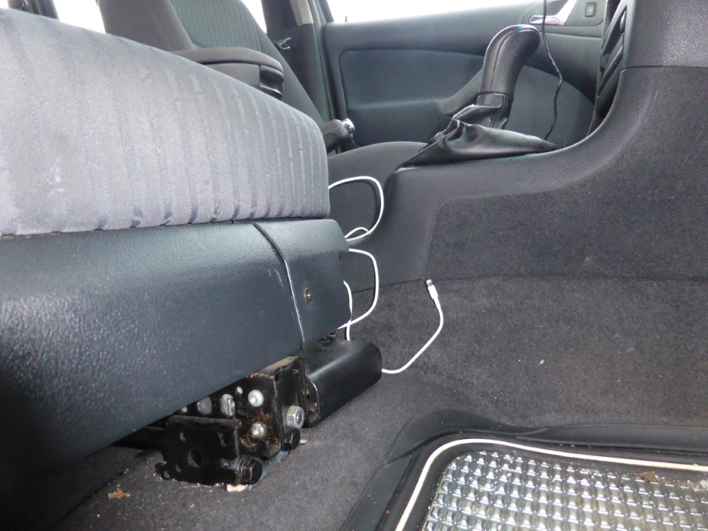

  11. OP here: Re heated seats - Mine were heated: definitely factory, swapped them for some gti leather seats in the end, also heated; plugged right in. The problem with the electric seats seemed to be slop in the mechanism. it was all bolted down correctly be it would shift while cornering. I guess whatever worm-wheel/threaded rod combination there was just wore out. worth knowing if you ever come across one

  23. I have a feeling I'll be asking a few questions about this car.... Its a TDI 130 elegance with electric seats as standard. There is a noticable rock in the seat when changing direction, accelerating or braking. When out of the car you can grab the seat and move it. It's a very small movement and seems to be related to the bit of steel in the front-middle, the one with the logditudinal bar going to it. Anyone experience something similar? should I be worried? TBH I don't really need electric seats and I wouldn't mind putting in some manual ones (golf leather ones or something) Is there any additional challenges to replacing the electric seats in the octavia with manual ones? Thanks in advance
