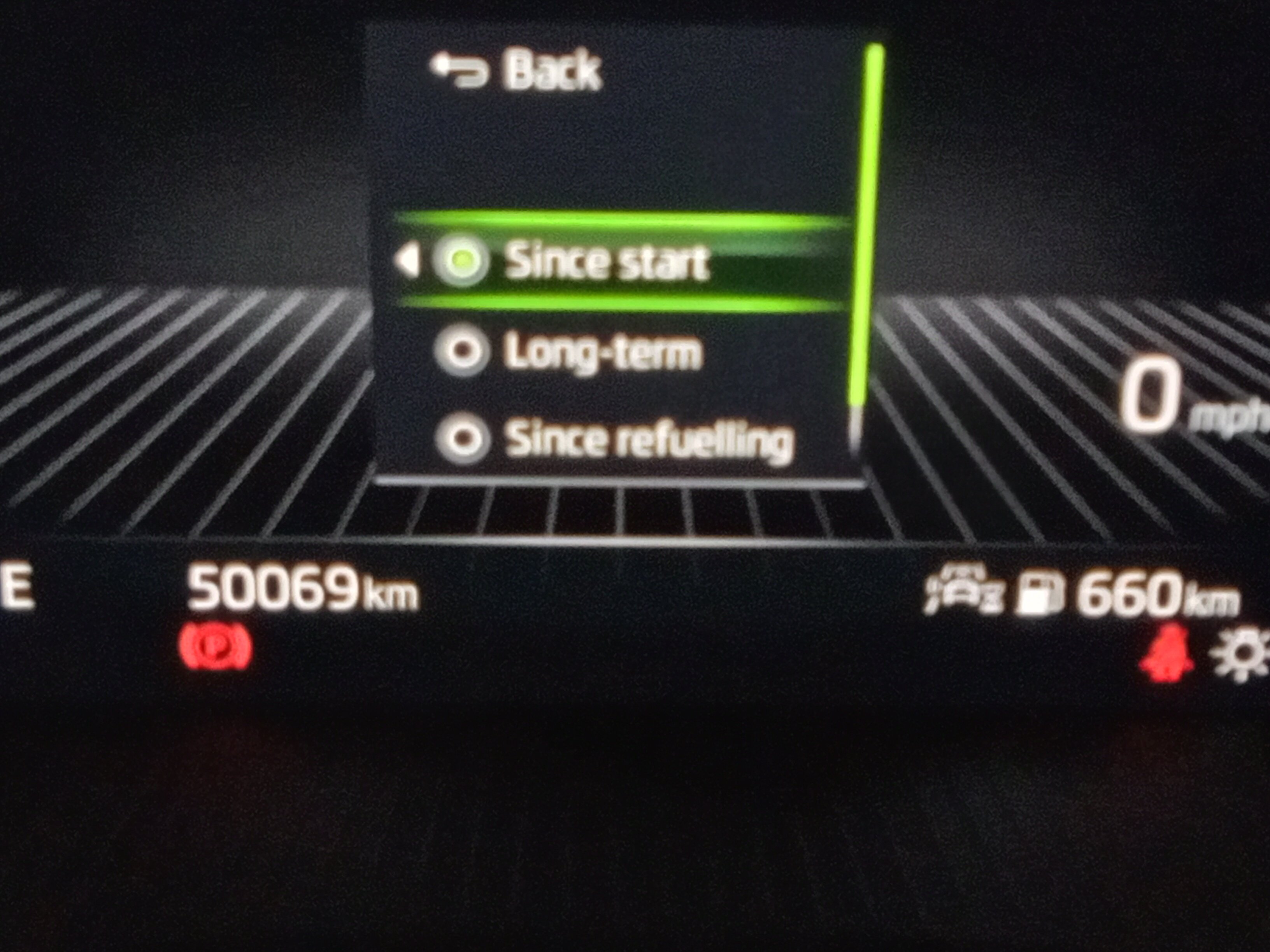

  1. The answer is because you used to do it. So did I. I had a yeti from 2017 and there was no "since refueling data" so I got used to reset it on my own after every fueling up. What's more, older Skodas reset data "since start" in slightly different way. Once you turn on ignition the data are cleared from the very beginning. I use my wife's Rapid very rarely so it's skipped me. Thanks, if not you I'd keep resetting manually those data after every trip.

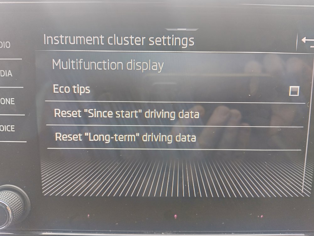

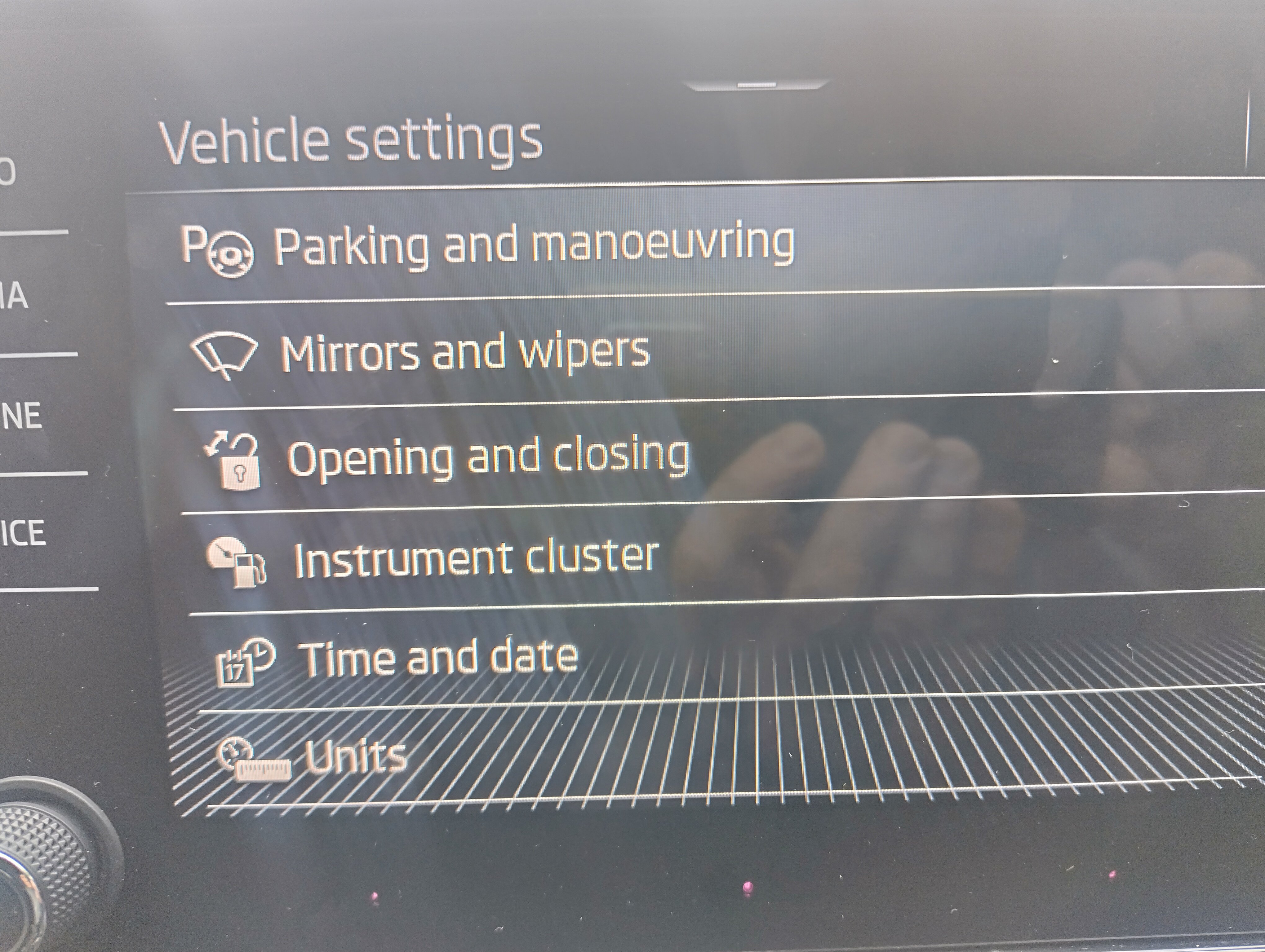

  2. This is sub-menu of my Karoq infotainment where you can reset specific range of trip data.

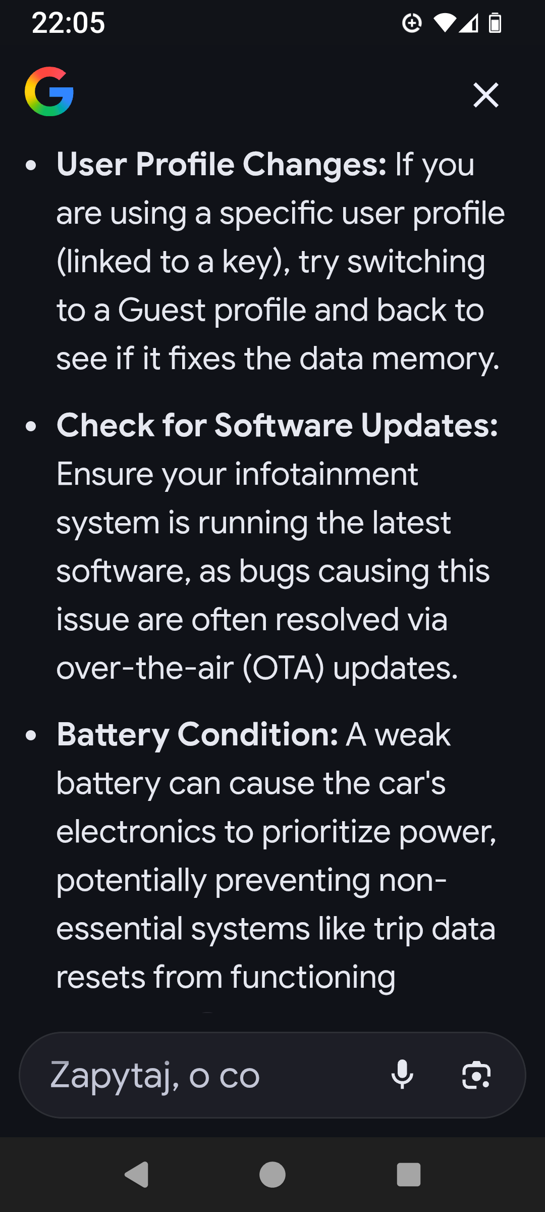

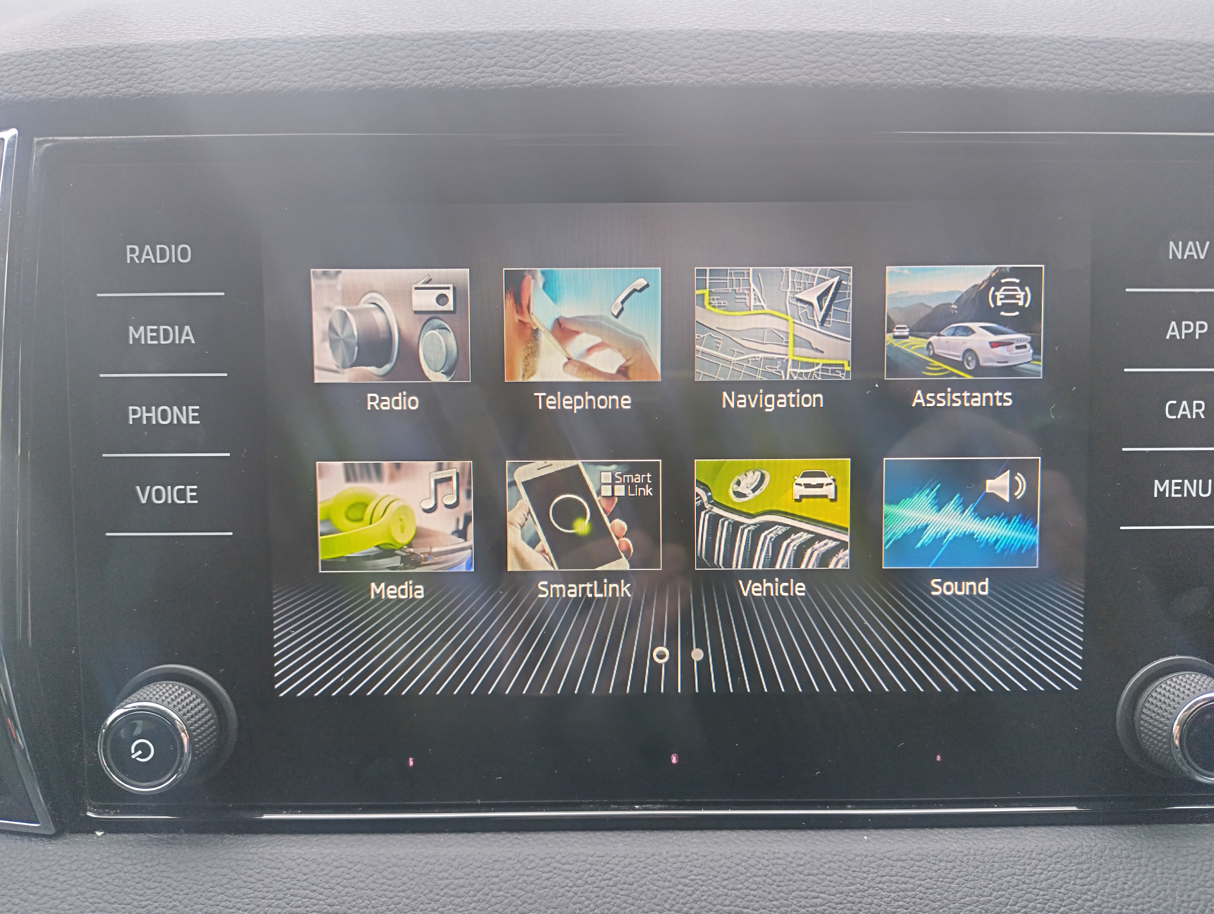

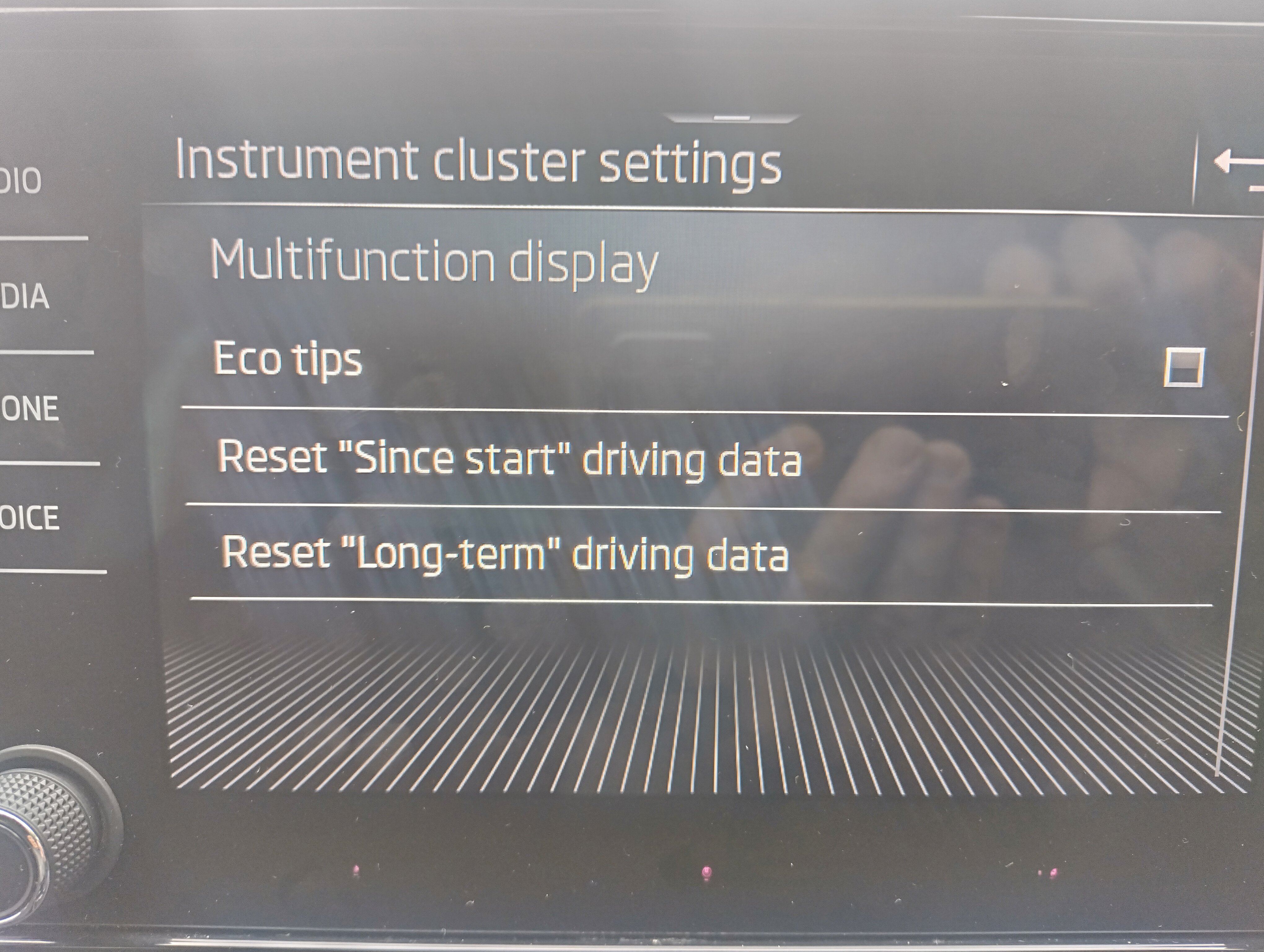

  4. Taking from your picture I guess you've got higher trim SE L, not just SE. It'd mean your infotainment could be Columbus not Amundsen. Netrhetles, why don't try to go through menus CAR-SETTING-INSTRUMEN CLUSTER. Someone pictures attached. Other way is to push right-hand roll on your steering wheel to get to DRIVING DATA, then push right arrow just below the roll and then scroll down to RESET DATA (either long or from start range)

  6. An update. The same request but different answer from AI. Now, there are three different reasons stated for such glitch with auto-resetting. No, no, the car is from British market. I just got used to kilometres rather than miles when it comes to mileage. According to Skoda catalogue SE trim is equipped with 8" Amundsen infotainment, so I bet I've got Amundsen indeed. Meanwhile I've checked up if any software updates are available but everything seems to be up-to-date. Secondly, got deleted all users profiles. The last thing, battery. Maybe that's the reason. The car stayed for a while in dealer's yard. I'll see how it works after a few trips, though start-stop system seems to work properly. PS My bad, attached wrong screenshot. Didn't mean to copy your answer. Just, once browsed online yesterday got an answer that there is some option to switch on or off auto-reset. Was sure, I uploaded screenshot with that feedback from AI. Sorry for causing the mess.

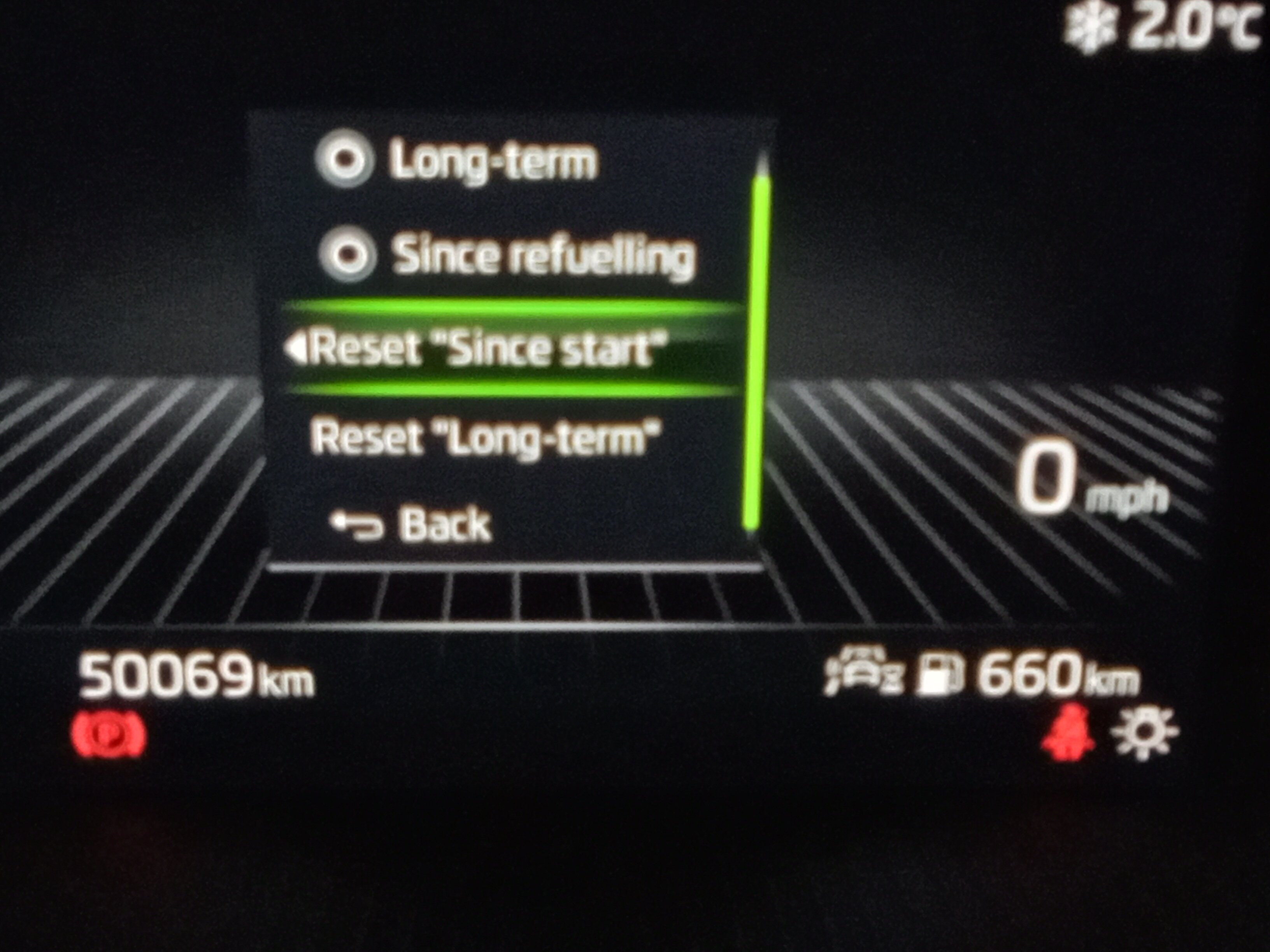

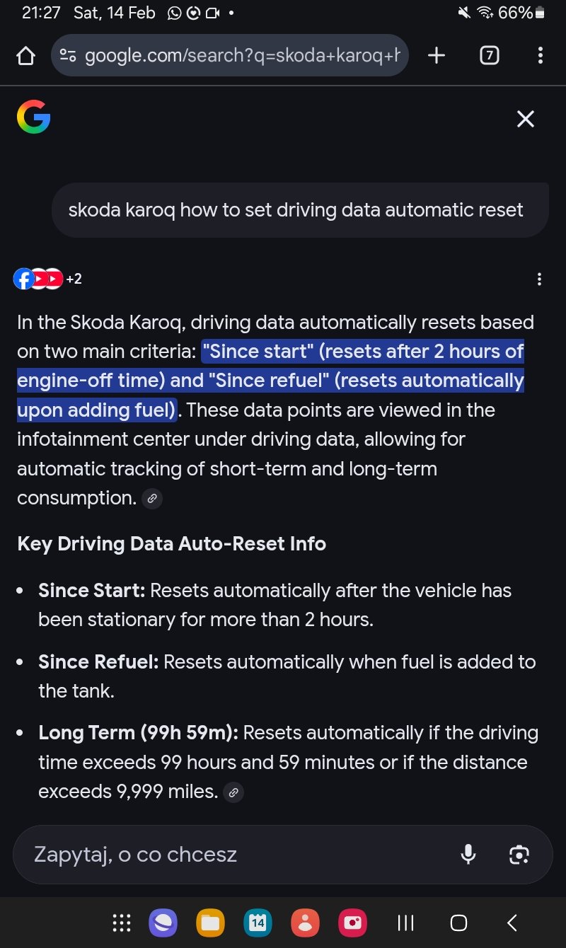

  7. Hi Thamestrader, Thanks for replying. Absolutely, "driving data since start" should be possible to get reset either manually or automatically. Manually over virtual cockpit or infotainment. The first way is shown on the attached image. In my case, the auto-reset doesn't work. Neitherless if ignition is off for two hours, all night or all day. Browsed on-line to get feedback as on the attached screenshot.
