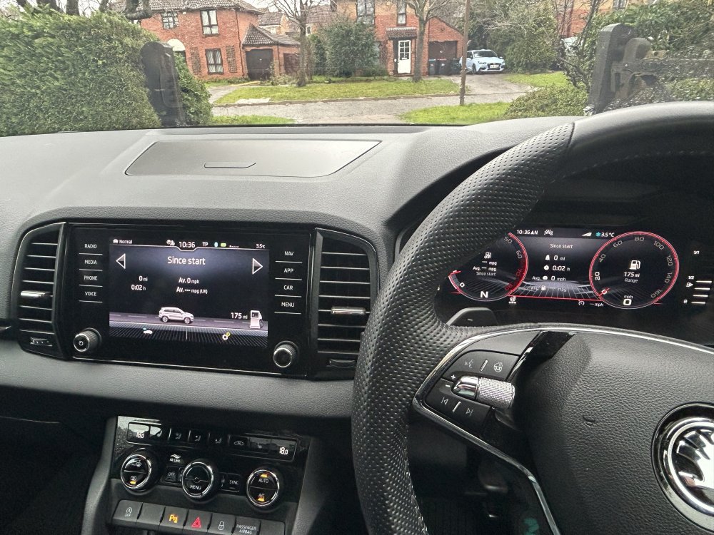

Photo shows my 2023 Sportline dash this morning (in the pouring rain). Something I discovered, which may resolve your issue. When I started the engine and selected Since Start on the Infotainment screen it showed my last journey and it was the same info on the centre of the dash, The Since Start data was reset when I moved the car forwards a few feet, I'd never noticed this before I'd assumed it was the start of the engine rather than the turning of the wheels that caused the reset.

Thanks for the detailed info. I have a Sportline with Amundsen and now you have shown me where to look exactly the same Reset options under Instrument Cluster, and the scroll roller behaves the same as you describe. The Scroll roller action is logical as I reset the Trip every time I refuel by pressing and holding the roller. I have to now question why I bother to do that as Since Refueling provides the same data.
The answer is because you used to do it. So did I. I had a yeti from 2017 and there was no "since refueling data" so I got used to reset it on my own after every fueling up. What's more, older Skodas reset data "since start" in slightly different way. Once you turn on ignition the data are cleared from the very beginning. I use my wife's Rapid very rarely so it's skipped me. Thanks, if not you I'd keep resetting manually those data after every trip.
