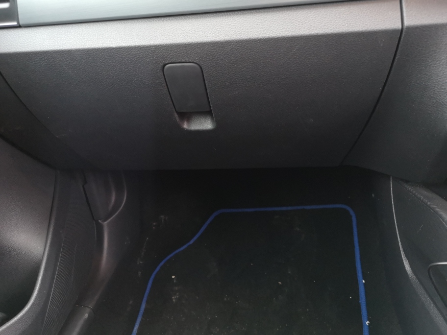

  8. Hi all I've had my Dec 2018 Fabia apart today trying to find the can gateway module J513 but I can't find it and the manual doesn't seem to be much use there is nothing where it says it is as in the Photo ....

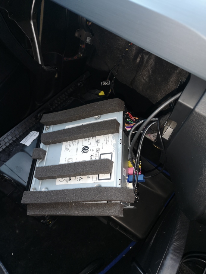

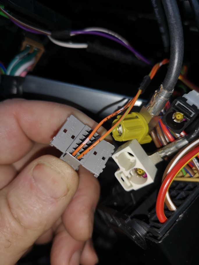

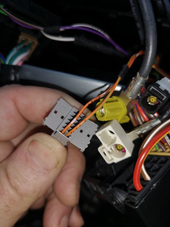

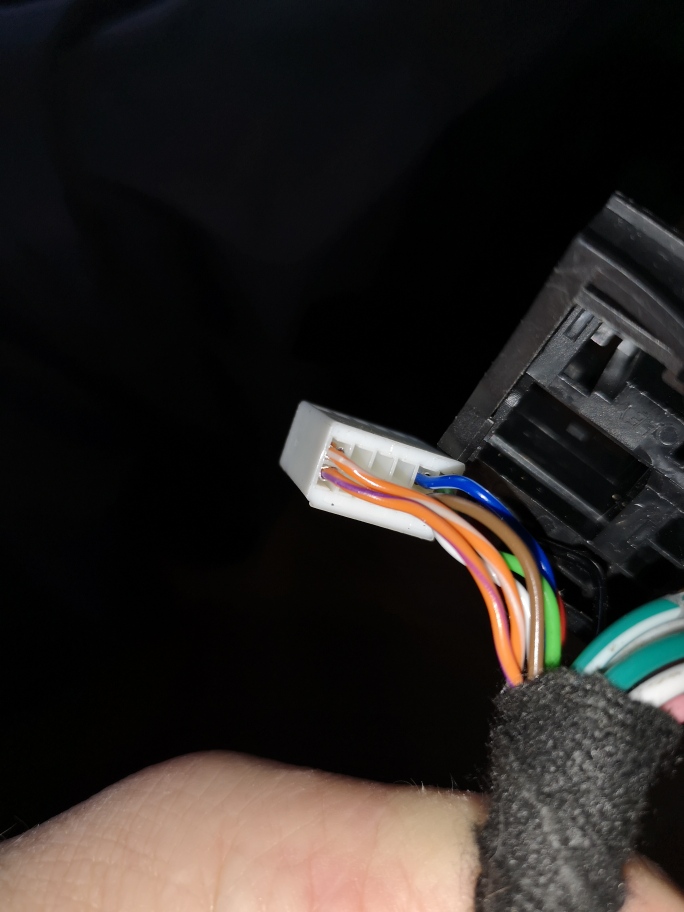

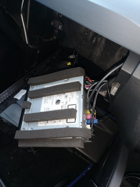

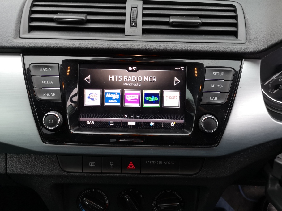

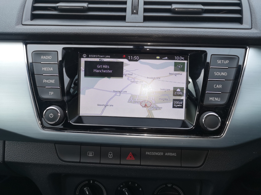

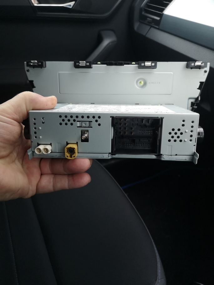

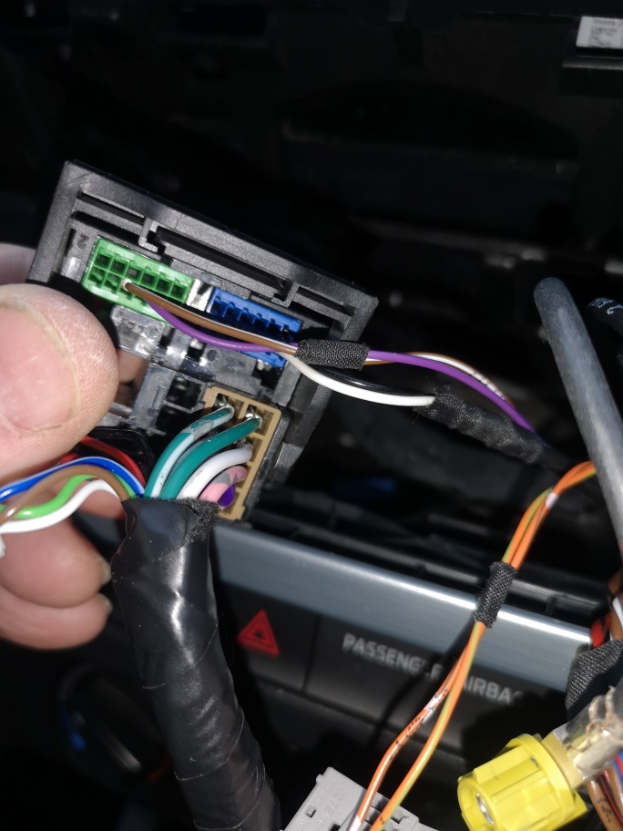

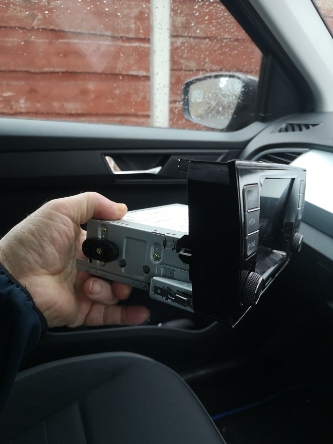

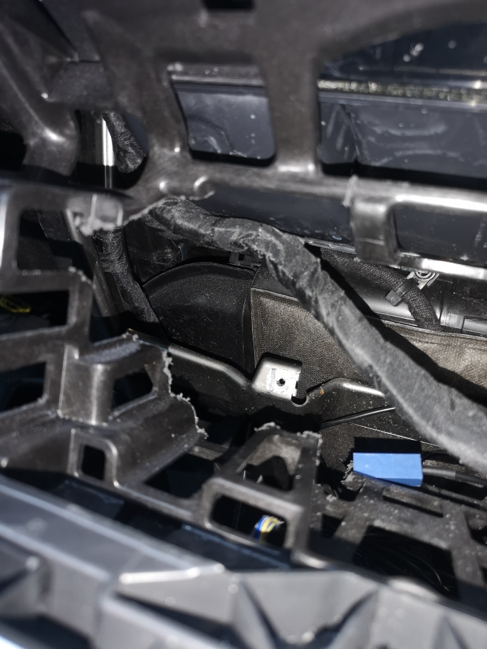

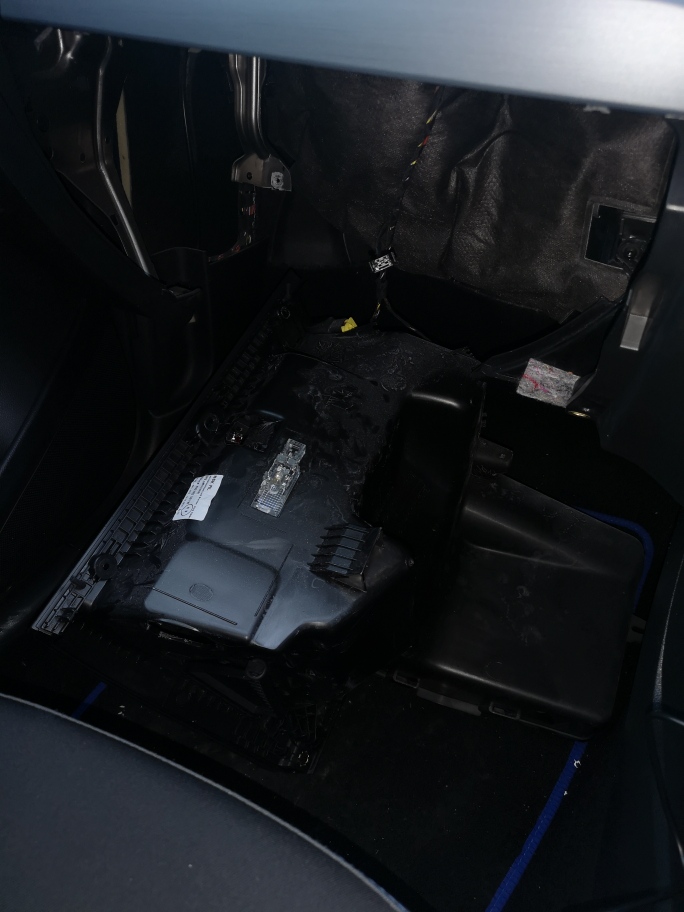

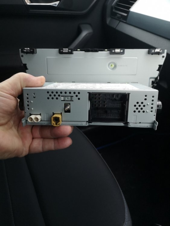

  10. I purchased a second hand MIB2 unit from Maciej Początek on face book ready coded plug and play.. 1.remove old head unit and glovebox Photo 2 & 6 2. cut away apart of the old head unit carrier as photo 7 3. move blue and green connectors from old quad lock into new wiring adaption loom photo 9 4. remove the 2 can wires from old grey connector and fit into new connector in the new quad lock ... see photo 8 & 1 5. slide wiring through into the glovebox area and connect to MIB2 unit... see photo 10 6. fit GPS aerial under dash ( onto of the heater) 7. slide MIB2 unit into the slot made into the old head unit carrier from the glovebox side 8. refit glovebox. 9. remove the upper 2 locks from the new head unit. you can be brutal and use a set of pliers. 10. slide new head unit into place photo 11 11. go through settings to make personal adjustments 12. code instrument cluster for nav with vag-com or similar parts used : MIB2 unit second hand : 5Q0 035 874 C conversion loom. https://www.aliexpress.com/item/4000232403998.html?spm=a2g0s.8937460.0.0.fdd82e0eCVlIZM head unit second hand : 6V0 919 604 B GPS aerial : Ebay

  13. Hi all thanks for all your help ... all completed .. MIB2 unit , updated screen with menu button, installation loom , bit of cutting behind the old headunit and small amount of coding..... perfect...
