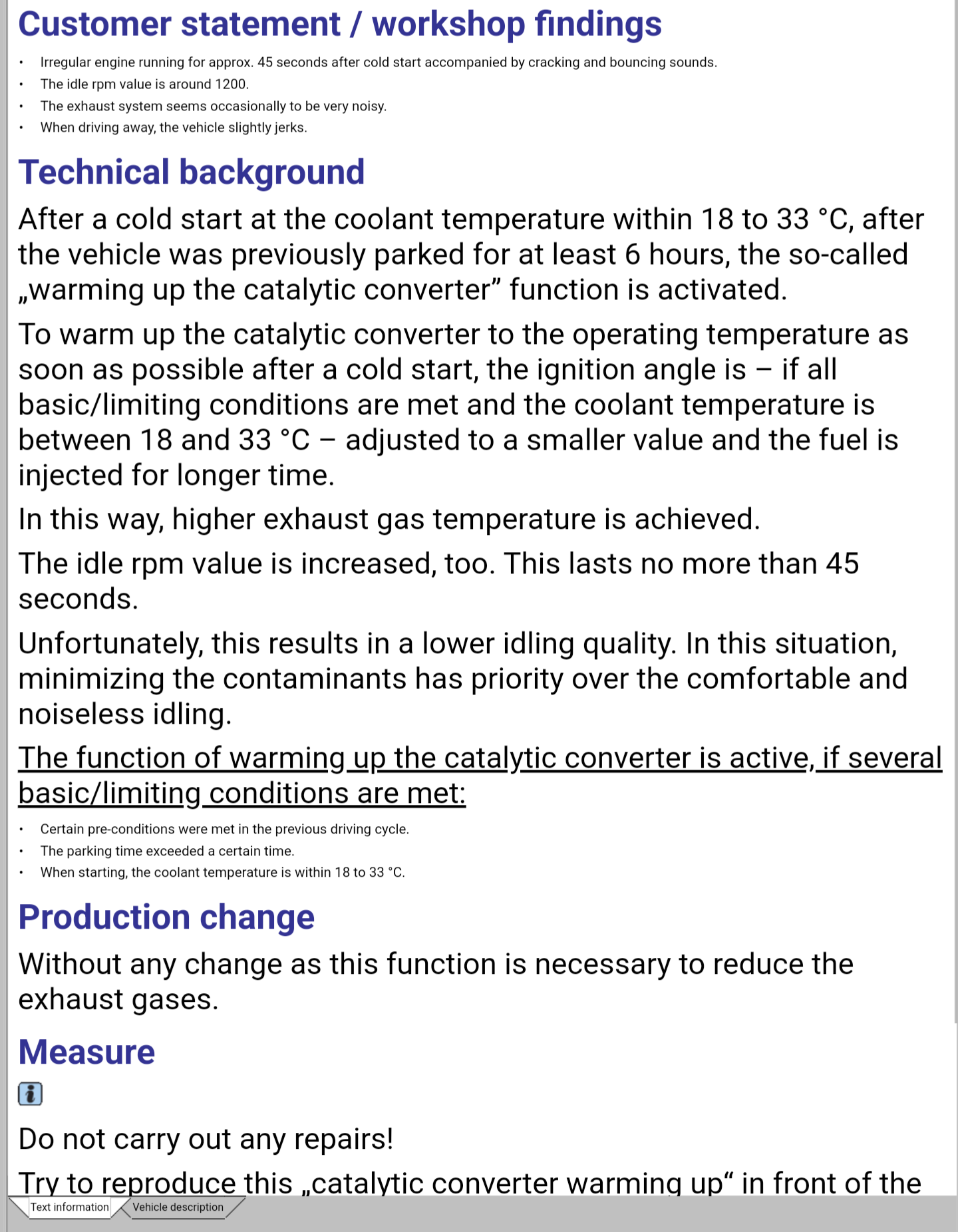

This is my first petrol car which could be why I noticed these things, I've only had modern diesels previously and they started and ran the same each time without any sort of hesitation or jittery idle.
It's a TSB that can be seen in Erwin, unfortunately you need to pay to access Erwin.
I got new coils recently and spark plugs, this completely solved the hesitation. Rough idle is only there with a hot restart after 2-3 hours but this is a documented (normal) issue to do with the catalytic converter. Cold starts are completely fine now. Note: I changed spark plugs at the start of this thread, that alone didn't fix the issue.
