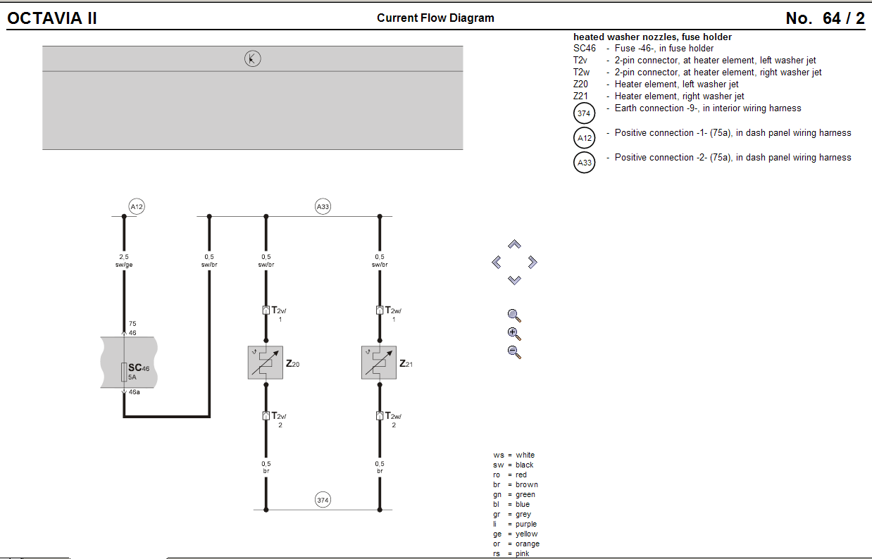

  3. For skoda octavia 2 preFL the electrical flow diagram for heated washer nozzles is:
  4. I found this topic and I want to contribute a little bit. So, for a skoda octavia 2 preFL the headlight washer electrical diagram flow is attached. I discovered that between preFL and FL versions exists two types of electrical module: for FL version is BCM with 3 connectors with 52 pins and for preFL is a module with connectors from A to L. As I know, the bumper has already a support for headlight washers but I'm not sure about the markings, probably yes.
