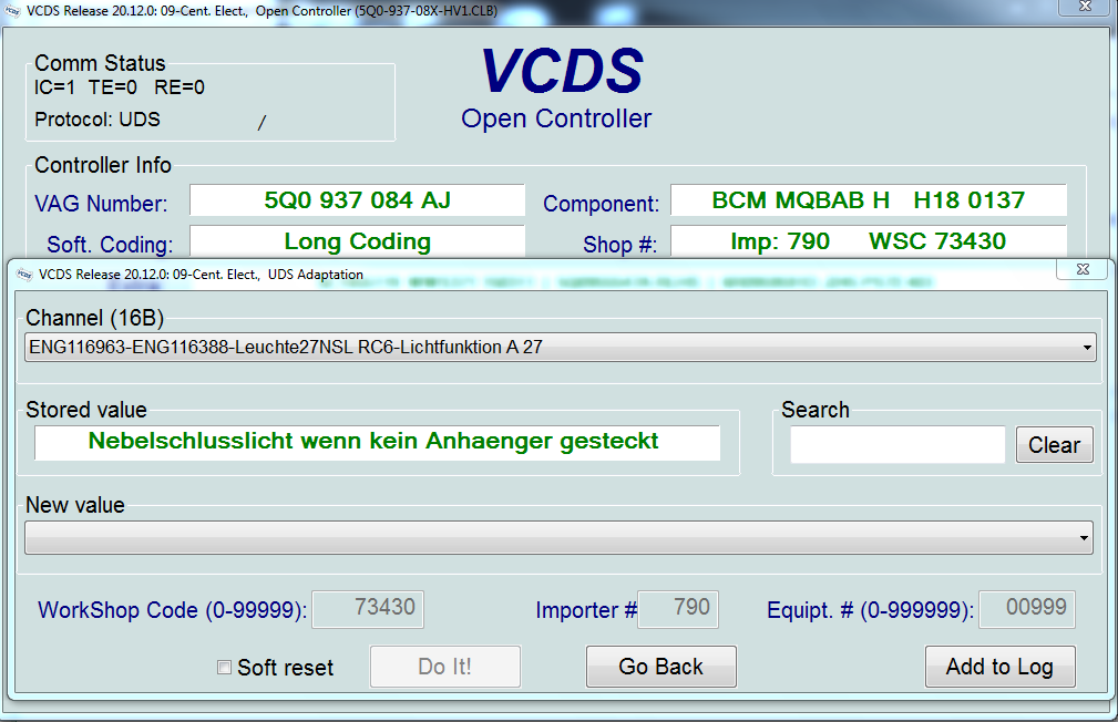

  3. Leuchte26NSL LA72-Lichtfunktion A 26 - Nebelschlusslicht wenn kein Anhaenger gesteckt und Rechtsverkehr

  6. Good evening to all . I want to share with you my experience with coding rear fog lights my car is a Skoda Octavia mk3 vrs MY2015 and during the coding of the first 2 parameters nothing changed. However, when I did the 3rd coding, then the right (left-hand drive) fog light was activated. I want your advice on whether I need to remove any coding from the 3. Best regards VV
