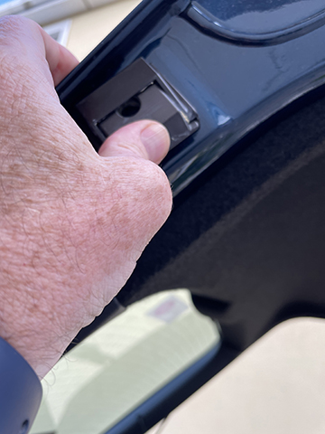

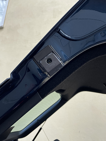

  4. Here ya go for location of the catches
  5. When you lft up the boot (So the back window i at head level....to the left and the right are the 2 catches...There is a circle in the middles. I just sprayed grease into there. I also compressed the spring with my hand by pressing the tab up and down and sprayed around the plastic that rubbed off the plastic outer. Hope this helps
  6. Thanks to all that replied. I went out and greased those two boot catch things. Hasn't made a sound since. Thanks again Gar
