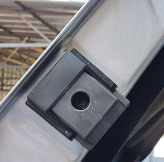

When you lft up the boot (So the back window i at head level....to the left and the right are the 2 catches...There is a circle in the middles. I just sprayed grease into there. I also compressed the spring with my hand by pressing the tab up and down and sprayed around the plastic that rubbed off the plastic outer.
Hope this helps
Here ya go for location of the catches
Awesome, thanks @GarHefDub, that's fantastic!
I can confirm that this is the issue, i have been in boot while my car was driven and that is boot lid that is rattling. very poor design in my opinion, there supposed to be rubber...
