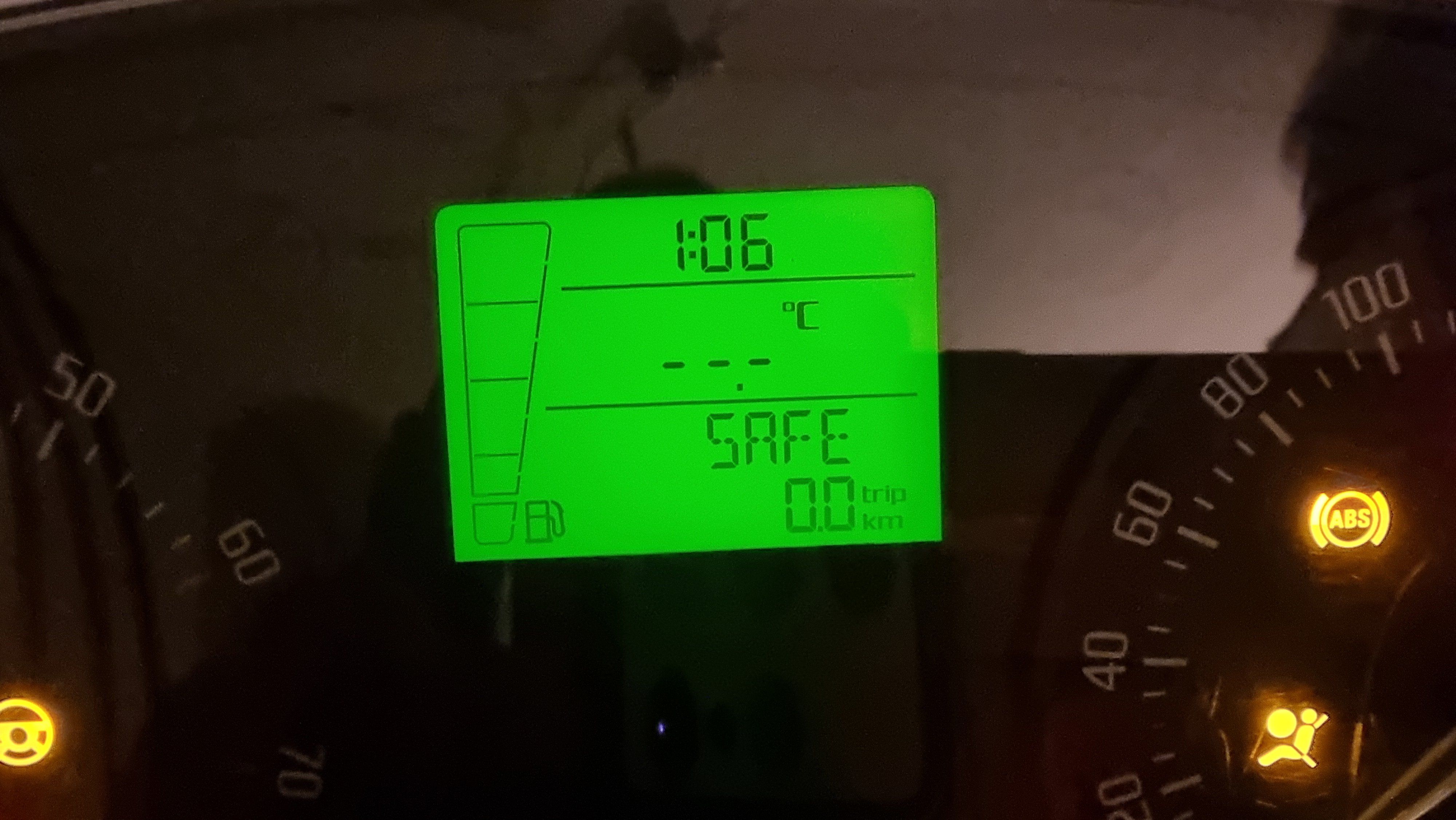

  1. My test platform is working. 🙂 Wiring Diagram This wiring diagram works for me, but I'm not sure if it's correct! Cluster Pins to BCM 28 - Drive train CAN high – T32a 19 - Drive train CAN high - T73b 29 - Drive train CAN low – T32a 18 - Drive train CAN low - T73b OBD2 Pins to BCM 6 - CAN high 23 - Drive train CAN bus high (switched) - T73b 7 - CAN low 22 - Drive train CAN bus low (switched) - T73b 14 - K-Line 37 - Diagnosis wire K - T73b Power T15 (+12V - Ignition) Cluster Pin 31 BCM T73a Pin 44 T30 (+12V) Cluster Pin 32 BCM T73b Pin 39 OBD Pin 16 T31 (Ground) Cluster Pin 16 BCM T73b Pin 38 OBD Pin 4/5

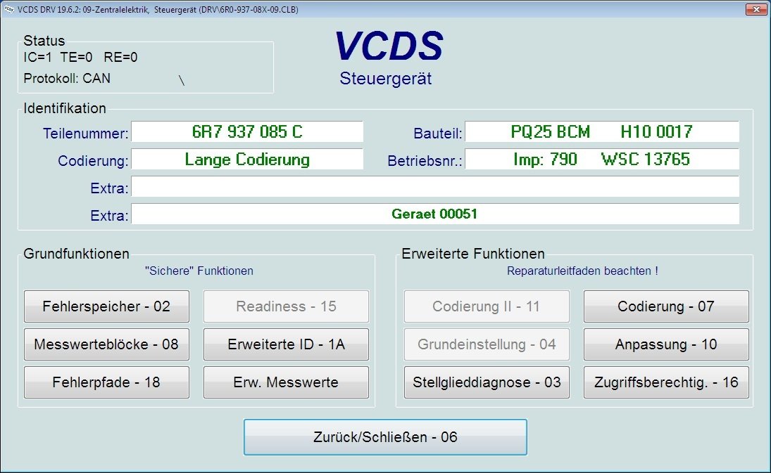

  2. @Cairus Thx for reply. Do you have more informations about this resistor "hack"? I'd like to try it, just for fun. 😅 Yesterday I connected a BCM and was able to query its memory. Today I'll also integrate the cluster and try it out.

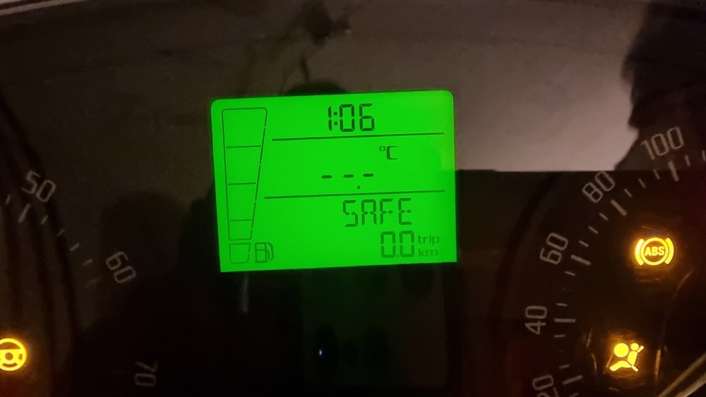

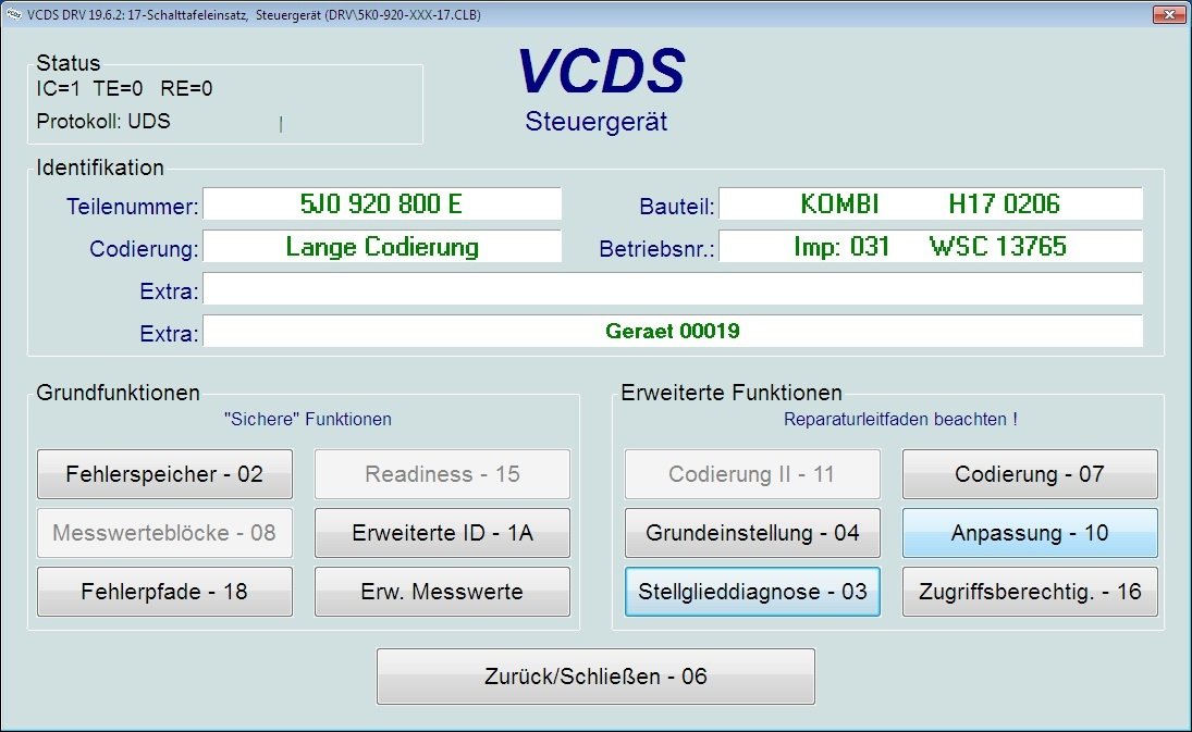

  3. Found a Pinout and it works for PWR ON, but no Diag direct to Cluster possible with VCDS. â˜šī¸ Cluster Pinout 32-pin connector -T32a- : 1 - Fuel gauge sender -G- 2 - Fuel gauge sender -G- 3 - not assigned 4 - not assigned 5 - not assigned 6 - not assigned 7 - Immobilizer reading coil -D2- 8 - Immobilizer reading coil -D2- 9 - Speed signal - Ouput 10 - Speedometer sender -G22- 11 - Oil level and oil temperature sender -G266- 12 - not assigned 13 - Rear fog light warning light -K13- 14 - Main beam warning light -K1- 15 - not assigned 16 - Terminal 31 - Input 17 - Windscreen washer fluid level sender -G33- 18 - Coolant shortage indicator sender -G32- 19 - Ambient temperature sensor -G17- 20 - Terminal 31 (sender mass) - Output 21 - Multi-function display -J119- - Function selection switch -E91- 22 - Multi-function display -J119- - Function selection switch -E91- 23 - Multi-function display -J119- - Reset button -E92- 24 - not assigned 25 - Handbrake warning switch -F9- 26 - Brake fluid level warning contact -F34- 27 - Oil pressure switch -F1- 28 - Drive train CAN bus, high 29 - Drive train CAN bus, low 30 - Fog light warning light -K17- 31 - Terminal 15 - Input 32 - Terminal 30 - Input
