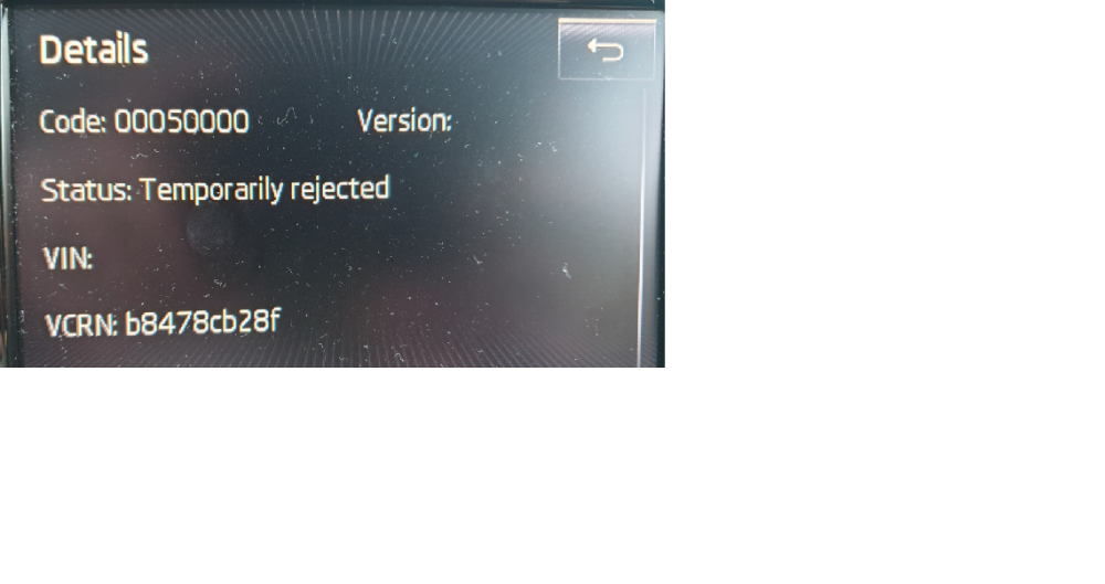

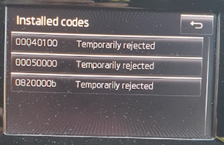

  1. Dear friends, I have Skoda Octavia MK3 with multimedia MIB1: 5E0035864A. In hidden menu (press and hold menu button) I have two Fec/Swap codes that are not activated: 00040100 Navigation and 00050000 Bluetooth. How can I activate these codes.
