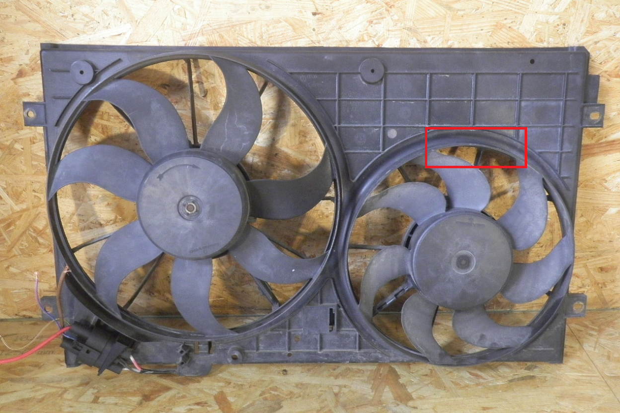

I found out what is wrong. A part of the right radiator fan is broken/missing. Looks like the right fan starts every time when the AC is on, and obviously when the engine needs cooling (more so when driving slowly with the engine warm). The part in the red rectangle is missing (picture from the web); I can't see much without having the radiator fan frame removed, hopefully neither the frame nor the radiator are damaged. I will definitely go to a service to have the fan replaced, but I was thinking of buying the fan myself. The only thing written on the visible part of the fan is "Siemens VDO" and after some googling I found out it's either VDO A2C59511338 or VDO A2C59511340. Both are physically the same (292.9mm), but the first is rated 150W and the second 200W. Browsing aftermarket parts shops, I see I get options ranging from diameter 290 to 295mm, with power consumption going from 150W to 220W. If what I'm now having on the car is 293mm and 150W, could I buy a 295mm 200W? Or should the wattage exactly match? I don't expect the 2mm diameter difference to be a problem. Also, there are quite a few brands available: Topran, Nissens, Autogamma, Mahle, Febi Bilstein, SWAG, NRF, Thermix. The price difference between these is not that big. Is there a brand I should prefer?

I was away for a few days, but today I arrived home and was able to drive my car again. I am now sure that the issue is not AC related. The AC works fine if the engine is turned off (with ignition on). I can now also confirm the last part of my initial post, when idling or driving very slowly, the vibration slowly kicks in. This is my first car, and I don't know much about the inner workings of a car, but it seems to me that the issue could be with some part involved in the system that adjusts the RPM of the engine in order to be able to produce enough current.

Hello, something bad happened today with Octavia 2 2012 1.4 TSI. I was driving in the city, with the AC turned on, when the car suddenly did a loud clunk sound. From that moment on, a loud vibration was to be heard and felt. At first, I thought it was related to suspension/steering, but after turning off the AC, the vibration disappeared. When turning the AC back on, the loud vibration resumed. Regardless, the blower/fan works fine with AC turned off. Until now, this sounds like some AC issue, but I think that I can also feel now a bit of the same vibration at idle, or when driving very slow in first gear. I'm not 100% sure about this last part, though. Any idea what went wrong? The vibration at idle is maybe just in my mind, I need to do some more driving/listening.

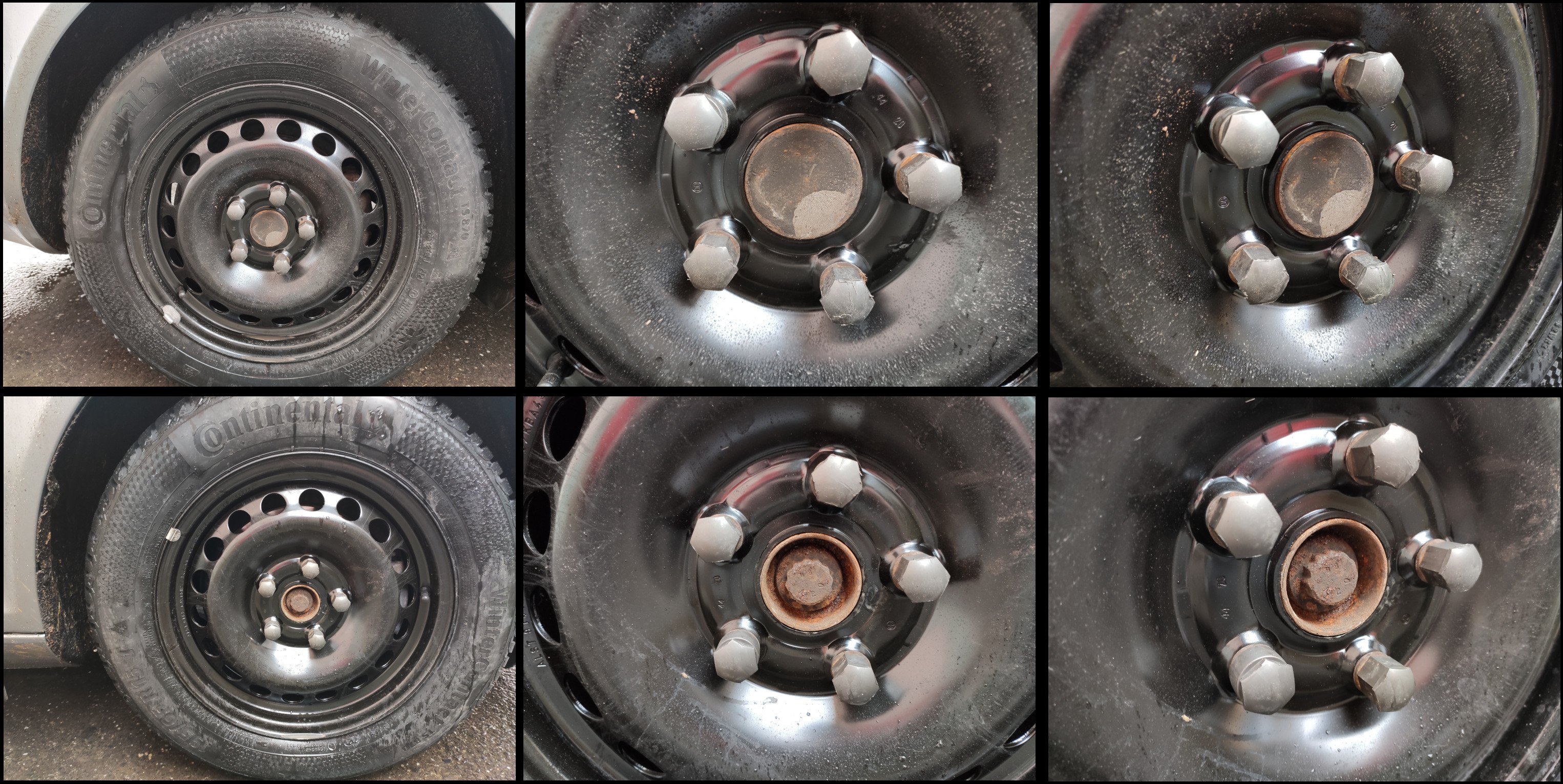

Thanks softscoop. Although quite expensive for what they are, I'm looking into centre caps. After some research, I believe Caddy caps with the code 2K0601149D9B9 would fit my wheels (15" 5x112). I like that the 'VOLKWSWAGEN' text is quite subtle on those.

Hi, I just swapped the alloy summer wheels with steel wheel and winter tires. I noticed that only the rear wheels have a cap that cover the central area, see the attached picture. Are there some caps I can buy for the front wheels? The area is quite rusted and doesn't look too good.
