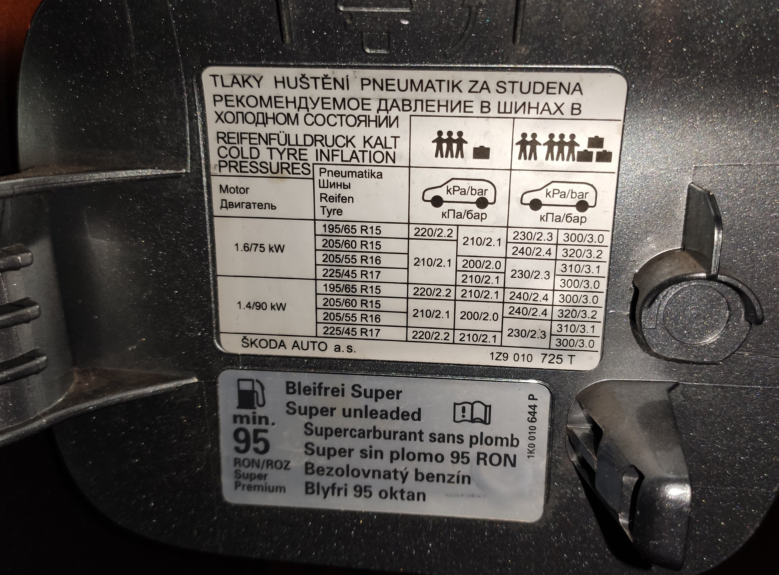

I didn't check the brake discs diameter yet, but I found this site showing different tire sizes for each engine. For my 1.4 TSI the listed wheel sizes are only 16" and 17", 15" isn't listed. Other engines like the 1.2 TSI or 1.6 TDI also list the 15" options. Is this any sort of indication that my car could not fit 15" wheels? Regardless, the tire options listed on my fuel filler flap include 15" tires:

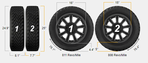

Actually I believe I'm gonna go with the Conti tires, that means the only two options I have left are: 6.5Jx16 205/55R16 6Jx15 195/65R15 This is how they compare visually (tiresize.com):
