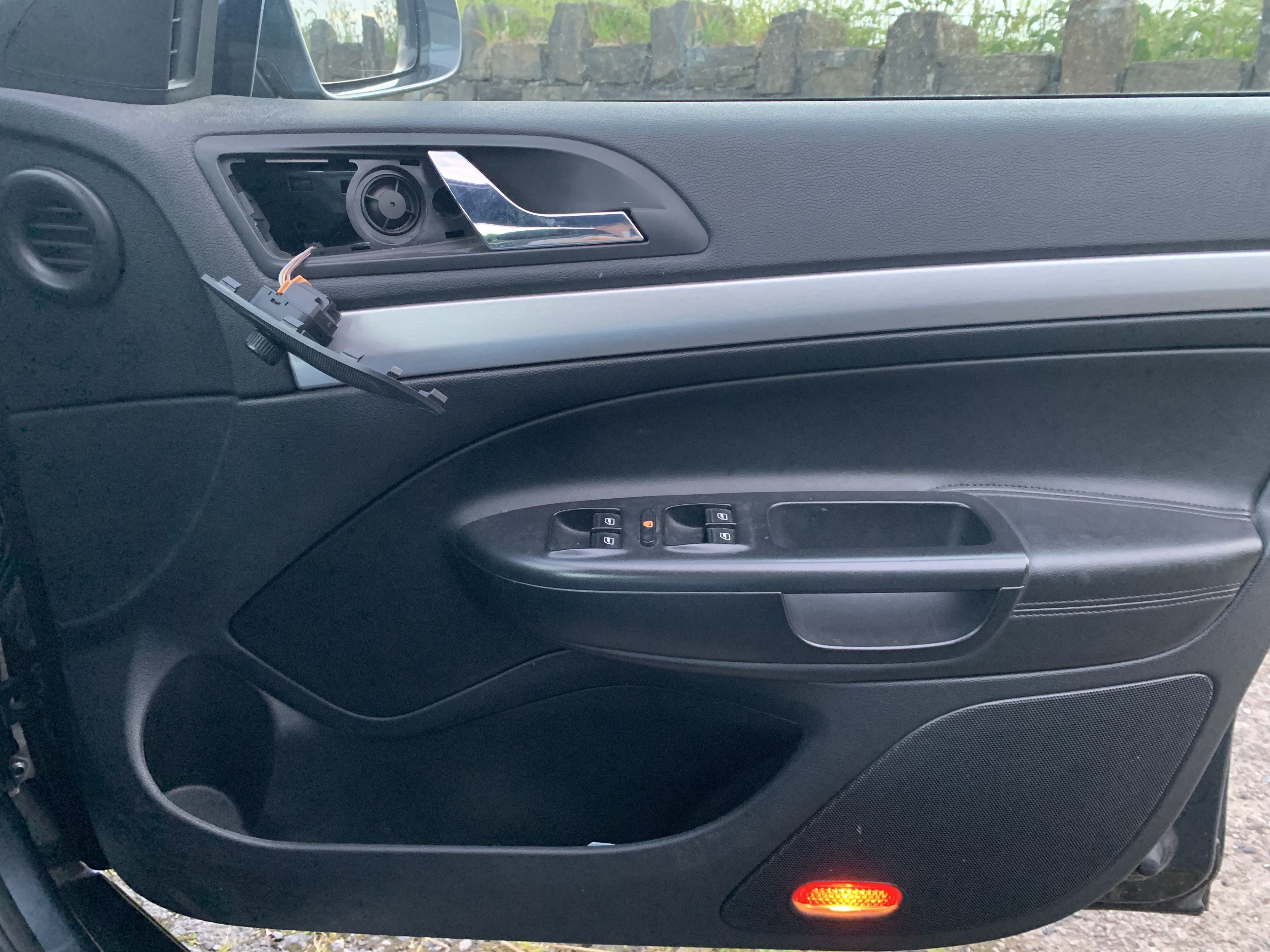

  3. Just found the parts guy in a dealership and ordered a speaker washer and front mids, he couldn’t find the suitable washer part for the rears. I’ll order a Chinesium 3 way crossover now and suitable holesaw and speaker grill once I know correct sizing.
  4. All nonsense like you don’t know what the words mean. An external amp would only be useful to make this louder and dsp is overly complicated.
  5. Seen that as googling for hours. Seems to be mounts shared from golf mk6 or superb mk2 but would involve making a hole in the vinyl then putting a grill over that.
  6. Has anyone done a 3 way component speaker mod on a octavia 2? I’ve been thinking about this way too long and the issue with the sound doesn’t seems to be that everything is played through the big 6.5” woofer so nothing sounds crisp and you end up turning the volume up to hear vocals. I think adding a crossover and a mid range driver and crossover to sort this. it would be awesome if someone’s already done the work.

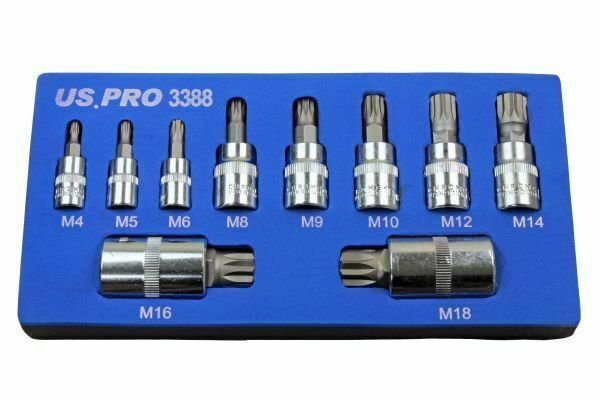

  10. Attempted to strip the engine down today to get to the thermostat and found I was missing triple square sockets which hold on the egr connecting pipe. I've ordered the relevant o-rings and gaskets so kind of annoying I got caught out so early. I dont see the need to mix triple square and torx.

  12. It's never had a DPF regen havent seen any lights and have had some extended motorway journeys though it only does a 12 mile motorway journey once a week with the rest being approx 3 miles and I've ran redex dpf. I really expected a engine light but fair enough I'll try. I'm in the UK are you sure they change fuel its labelled as b7 at asda/tesco and theres a gulf locally. I didnt want to switch to shell but if its going to be significantly better? All code I'll use google to translate. I've had a check brake pad message on the display in wet weather and they were serviced in march with new pads by the dealer. Hopefully theres nothing up with the calipers.
