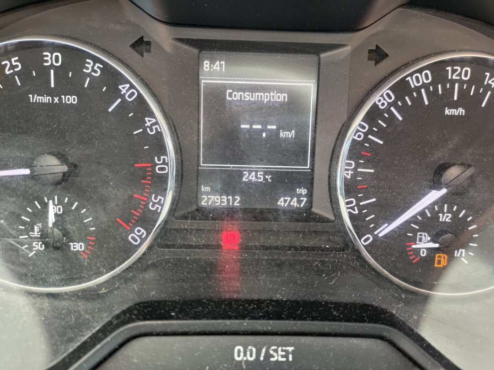

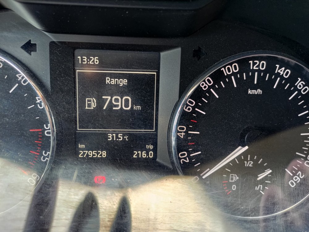

  4. A quick update. after applying dpf cleaner spray to the exhaust pressure sensor pipe (after removal of the sensor), the fuel consumption was back to normal and the fault didn't appear again after clearing. actual consumption picture attached before and after the cleanup and refueling-notice the reduction per the fuel quantity in the tank.

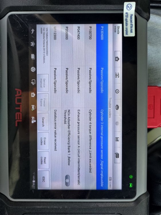

  5. Hello, i have Octavia 2016, taxi turned private. mileage 279k km. its previous engine was gone (cxxb, 81kw), replaced with dgte engine (85kw). had the dpf removed and cleaned using a special liquid. now, after a month of silence, the MIL light turned on again. scanning showed the following codes (image attached). does this mean the dpf is still clogged and needs special cleaning? why is the exhaust sensor fault constantly triggered? the sensor was replaced.

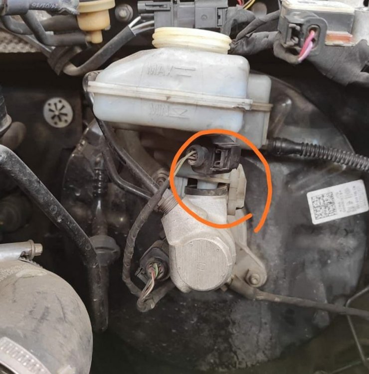

  10. Hi, From my experience with my car, there could be several reasons: 1. The brake fluid reservoir tank has small pin which it sits on which allows the pump to pump fluid from it. If the tank isn't sitting straight, the abs pump continues to pump fluid to the brake line but can't extract it back. The brake fluid continues to be added more and more until there is no more room, making the brake pedal very hard to press. 2. The brake fluid hasn't been bled well, leaving old fluid in the system. The old fluid continues to receive moisture, making itself more viscous and hard to move inside the system freely. I've attached a picture how it was in my car when the abs pump was failing to due misaligned pump reservoir with a broken pin.
