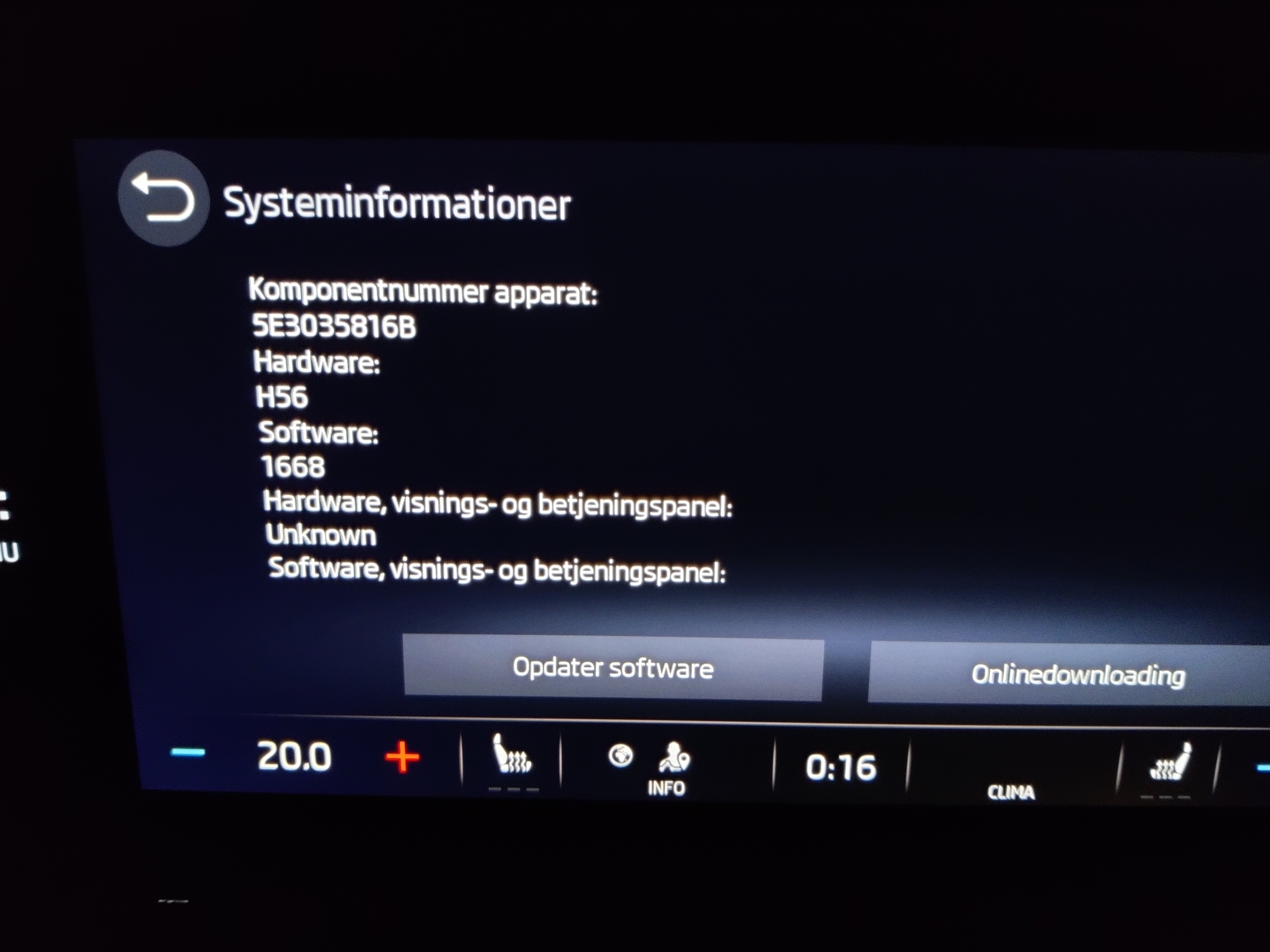

  17. Sorry for not answering you right away. But if you are still willing to check your SW-version, you can do that in "Settings > System informations". Mine looks like this (in Danish):
  18. I guess you have a newer software version? Mine is 1668. I've tried connecting with a OnePlus Nord too. Works fine with cable, but wireless is impossible.
