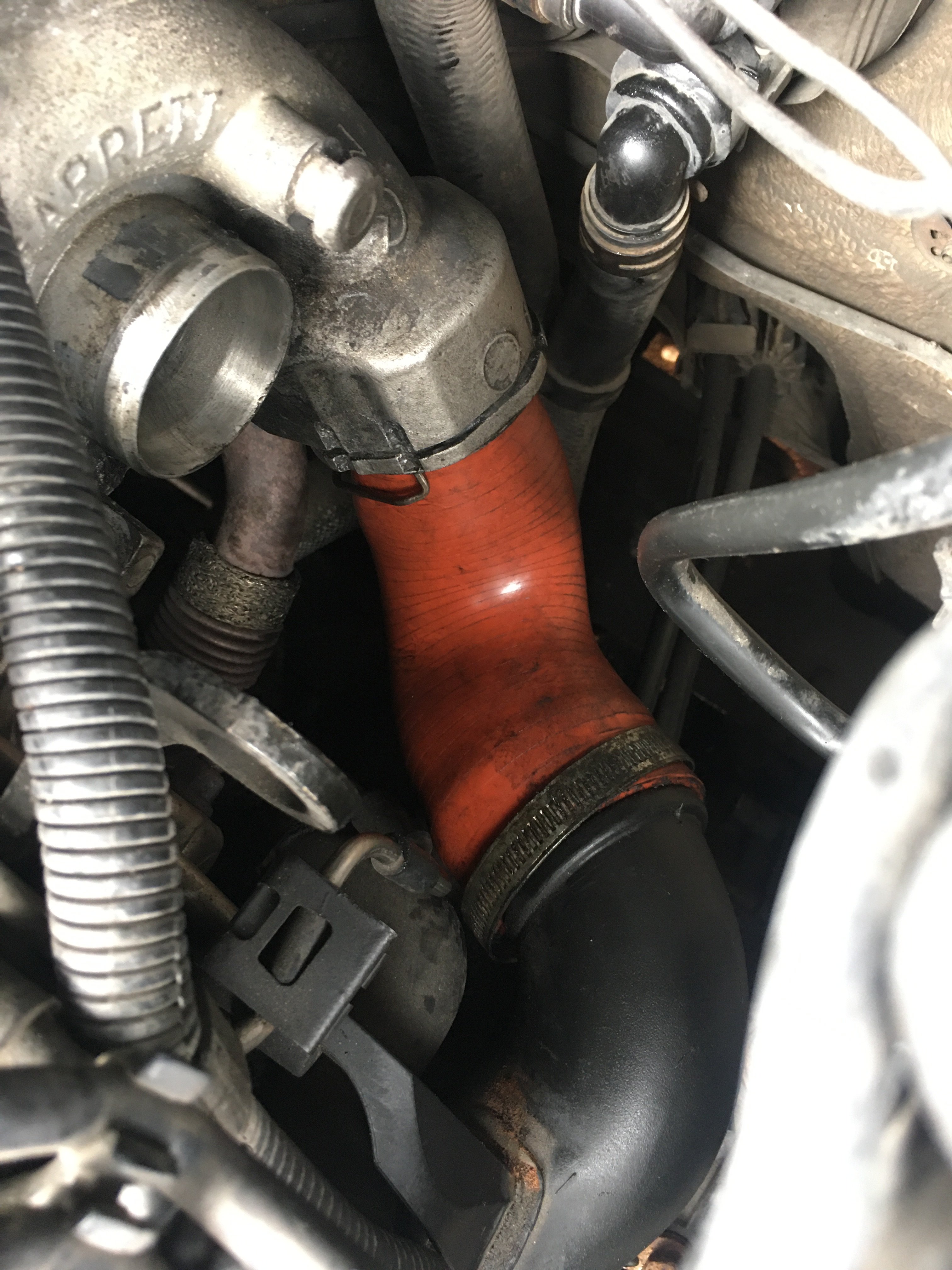

  1. Tried to probe the source but couldn’t pin point . At idle the noise just comes and disappears but on the run it’s starts around 1500 rpm . Certainly coming in the turbo or below the turbo area . There’s oil leak above the transfer case as well .

  3. I removed and had a look at it but I can’t see any split in that hose
  4. Is the orange/red hose ?

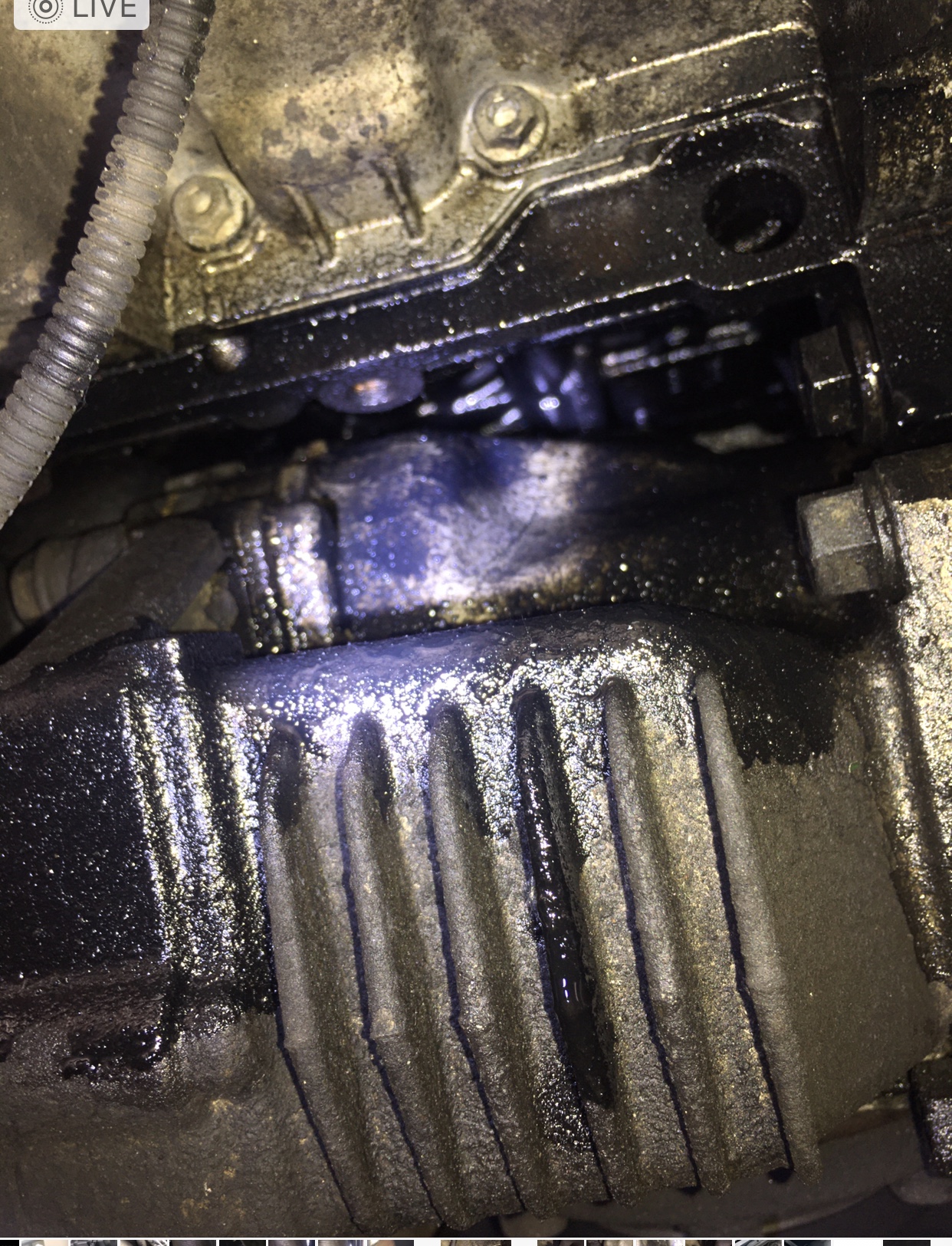

  5. I have a 08 scout with 2.0 bmm engine . From last week it’s making some weird noise and lacks in power . But no smoke and does gives okay mpg . Here’s some videos and pictures, had a look but I can’t pin point what is the issue . There’s some oil leak above the transfer case . https://youtube.com/shorts/Ekw2sCpZrDg?feature=share https://youtu.be/L8IEMWwvyLw
