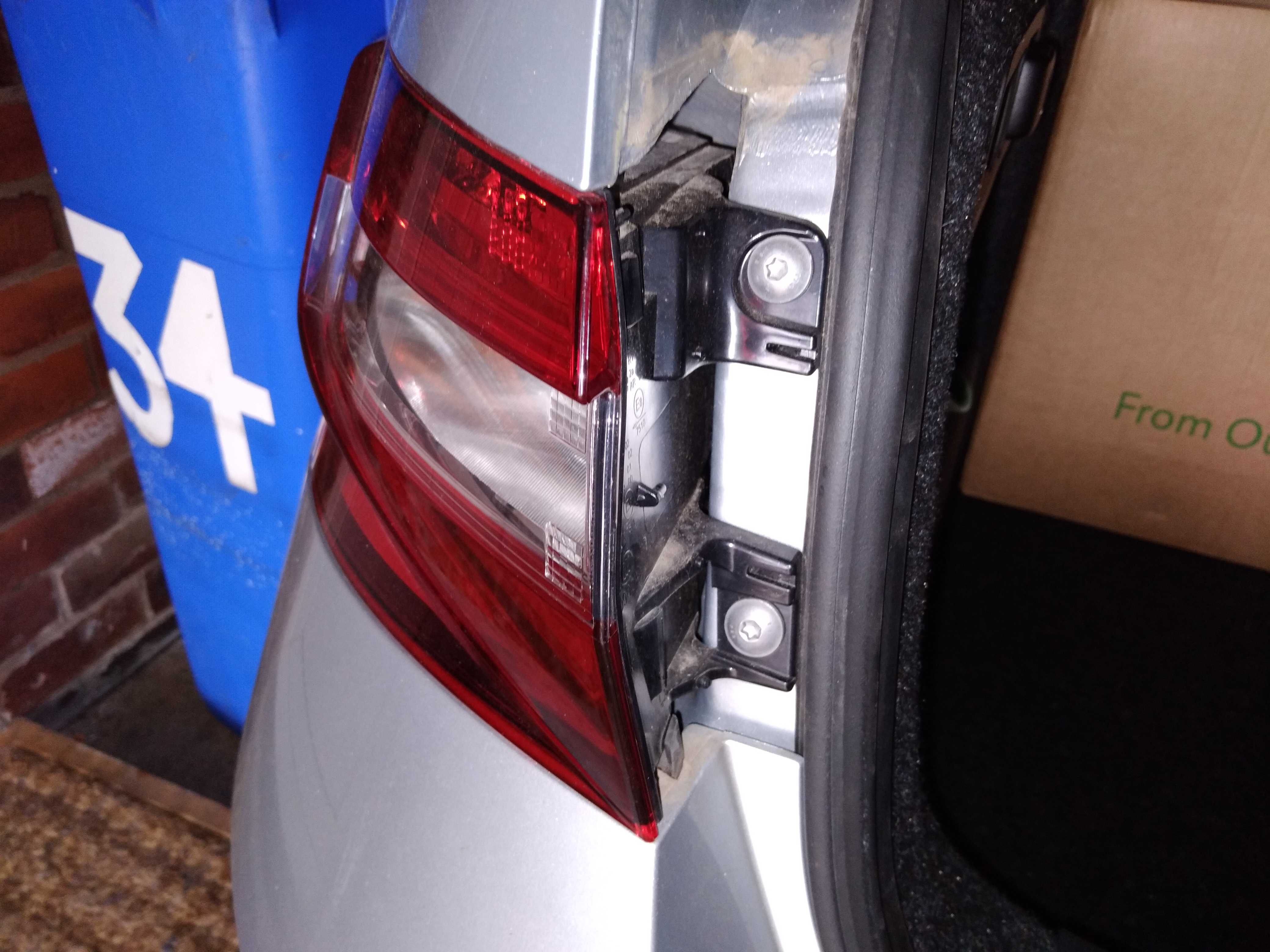

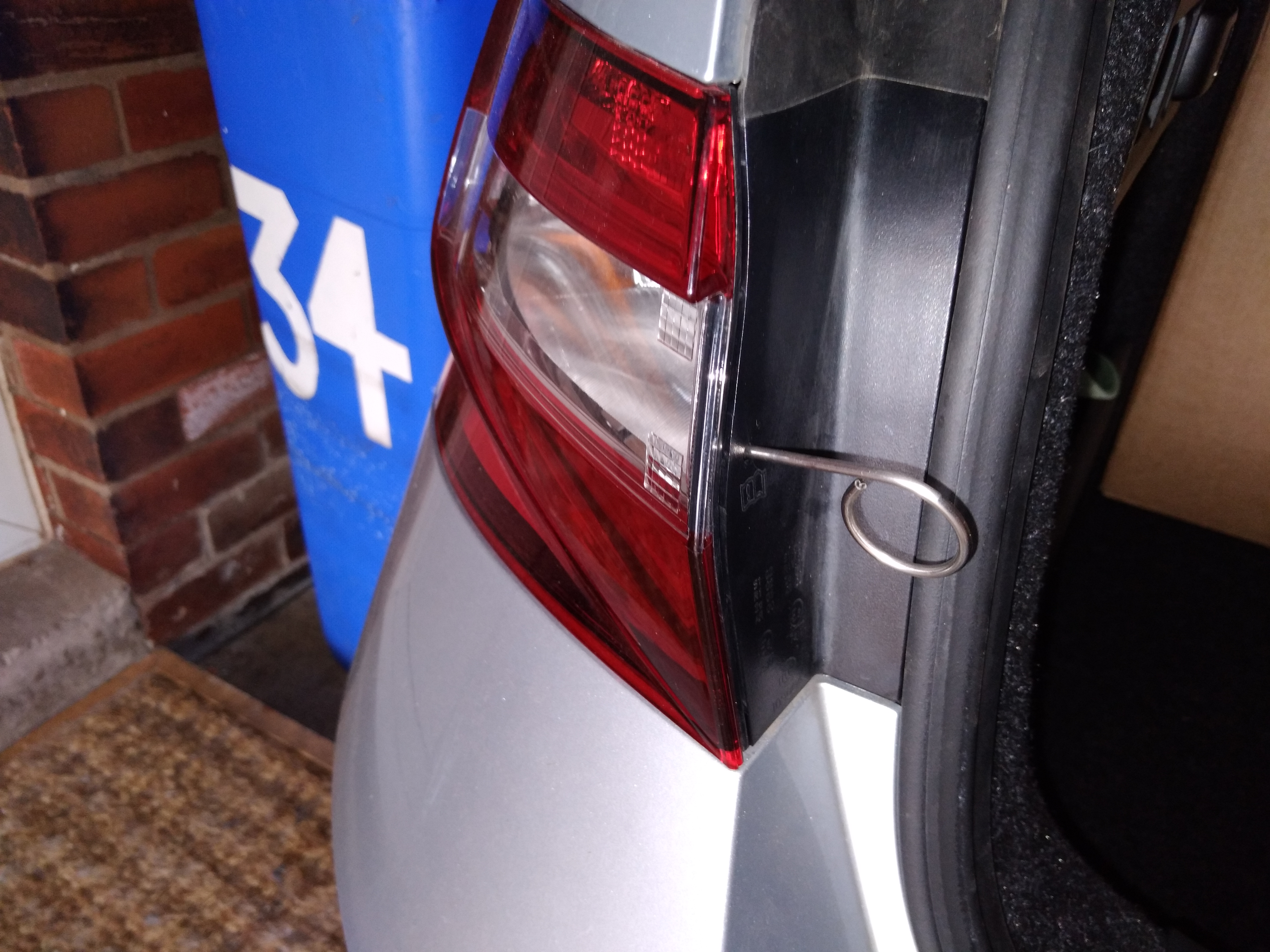

Hi Noms, the steel wire hook in the spare wheel tray is used for (besides other things) removing the plastic cover on the rear tail light cluster to get to the two torx screws, there is a small hole in the cover which the tool hooks into, insert the tool and pull towards the boot lock, It will unclip from the cluster revealing the two torx screws. BTW I thought it was for removing the plastic wheel nut covers untill I saw the plastic tongs in the spare wheel tray, DOH! Cheers Terry
