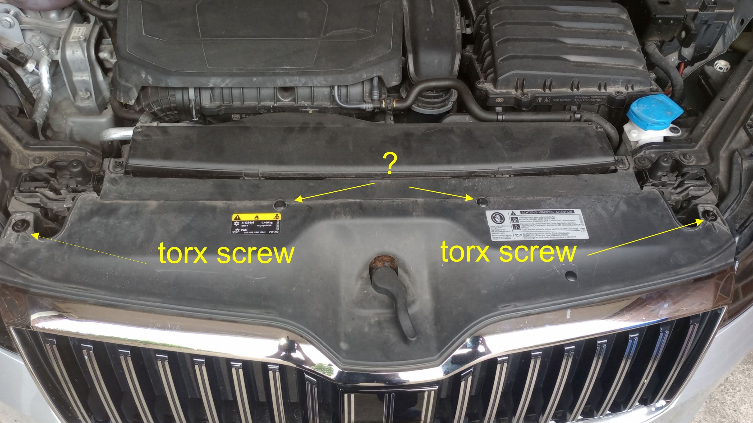

  1. Thanks for the the replies guys,I read one post where the bloke said, have a go at taking the cover off, if it does break the clips, just order another cover, it's easier than taking a bumper off and refitting it, especially if your on your own, his post was from a few years ago, and said it cost £13 for a new cover, who knows how much now? And why change it from the pre face lift which was far easier? bloody sadists these designers 🤬 I'm dreading when stuff starts giving up the ghost on this car, front and rear led lights, info system screen, 101 sensors on the car, and most of the stuff you can't do yourself, so labour costs are a big part of the problem.

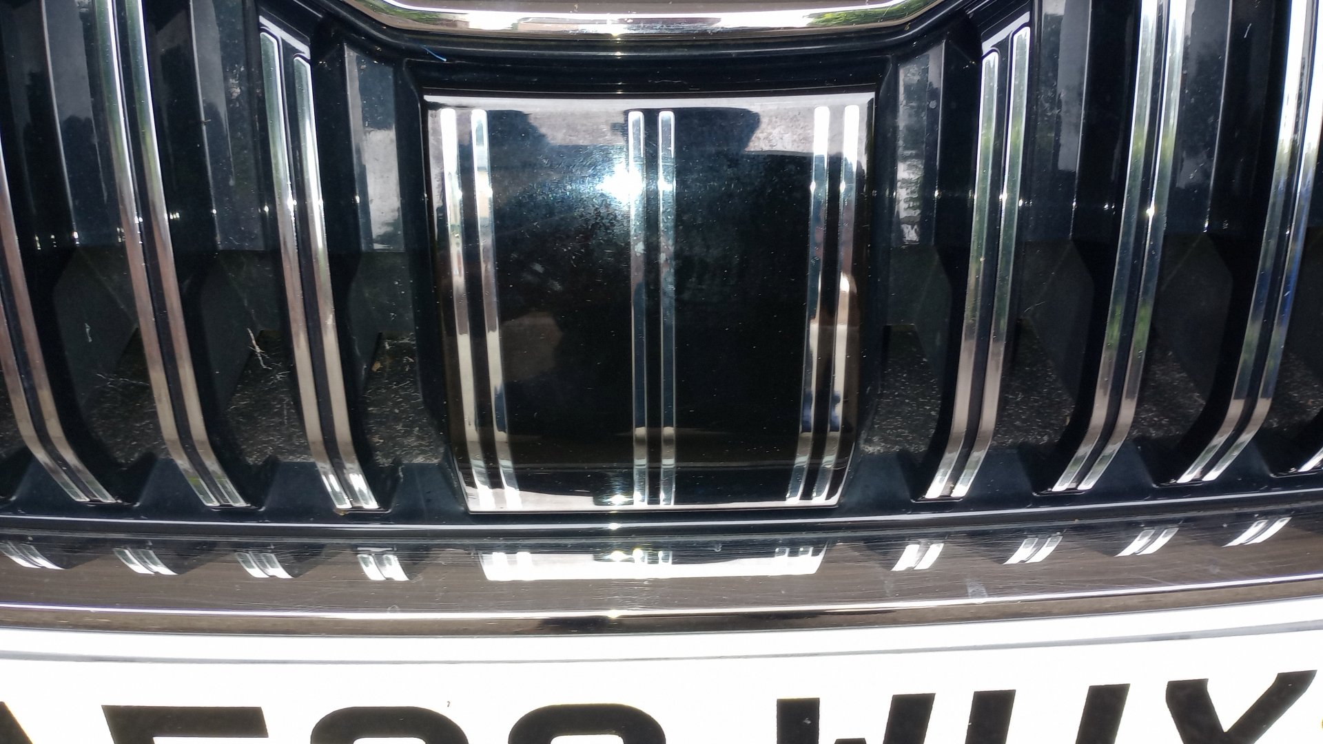

  2. Hi there, after I'd posted the problem this morning, I found more help on this forum eventually. The answer believe or not was to clean the sensor on the rear view mirror that looks forward, which I always thought was to auto dip your main beam for oncoming traffic. I was a bit sceptical but went out to the car, started it and the warning triangle was still there, switched off and cleaned the small square translucent sensor started up again, went through the motion of switching on and off the ACC and the Front assist, it started working s went for a short drive and everything worked perfectly. I can't explain why that sensor should have anything to do with the ACC and Front assist. I'll have to find that post again, it was from about 4 years ago, one thing I did find was that the front centre of the grill is a separate piece and can be removed but I'd not like to try it ! Also not surprised about it being out of alignment with all the potholes and some pretty severe road humps. Thanks for the reply
  3. Hi guys, quite a while since I've had to post something. Driving home yesterday and the Adaptive cruise control stopped working, got home and checked it out on the stalk and in the menu which gave a warning triangle saying "front assist not available" in the menu screen and on the dash, similarly the ACC said similarly "Sensor impaired". Checked on the web and this model year was a transition in 2020 so the sensor is behind the centre of the main grille, not behind the open grille below the reg plate. I did find a post for that on an older mk3 Superb Could be that the plug has worked loose or the unit has worked loose, I believe it is a Bosch unit, my problem is I can't access it through the top cover, took the two torx screws out it won't budge. The two in the photo with a "?" are rubber and won't come out, they may hold the plastic frame that the sensor fits in. The third one near the top of the main grille is a bung and can't see what it's for. Any ideas anyone? I'd like to take a look before running to a dealer to get it sorted Cheers Terry

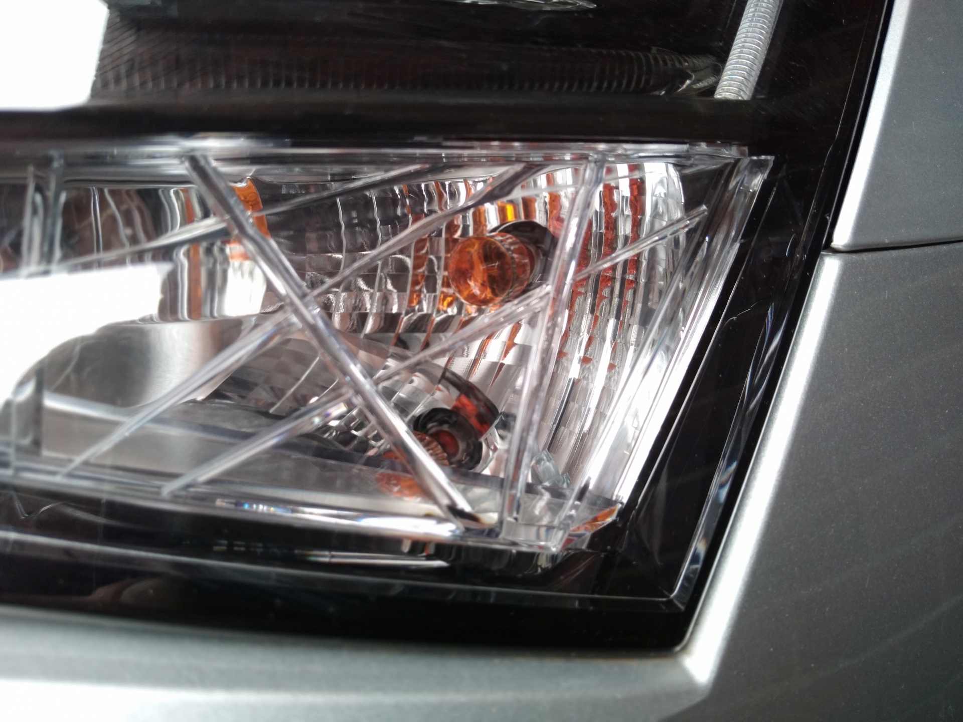

  13. Hi Xman, not on my 2020 Superb SE, it has a mix of filament and led lights, the only filament bulb on the front is the indicator a PY24W not that easy to get out, the rear filaments are indicators, PY21W cheap, and reversing lights, P21W also cheap, and both easy to get out. And as to edbostan and his original question H7 or H4, I think you'll find this useful, a youtube video on changing both headlight bulbs main and full beam, they both look like H7s, as they have 2 terminals, the H4 has 3 terminals as they have dipped and main beam in the same bulb Watchthe video and make you choice, hope this helps. Cheers Terry or Victor or Deedah
  14. Hi Xman, if the owners handbook is "not a maintenance manual" why does it tell you how to check fluid levels and top up, or how to change some of the bulbs? are these not maintenance items? The point I was making is that the information is limited As for the bulb fnders go to the first one you suggest and put my car in, a 2020 Superb SE and find the front indicator, while your at it try powerbulbs.com or Halfords or eurocarparts.com, all popular listings when entering "car bulbs" in any search engine. I did phone the dealer and get a part number but he would not divulge the bulb type, and if you put that part number in it kept taking me to any number of Skoda dealers who all want to take £38 pound off you, they might as well wear striped jerseys and a mask. I eventually found it because of the distinctive shape of the bulb, and verified it as the correct one because that particular bulb (PY24W) was developed by Philips and I went to their website which you list, but is not everyones first port of call, and it did confirm my car as being able to use that bulb.
