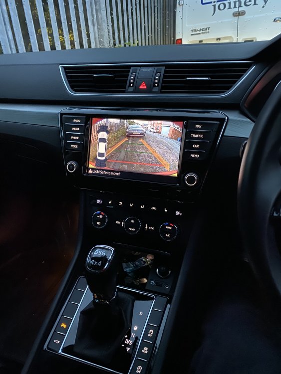

  4. Do you mean the camera image? It shouldn’t be flipped. For reference see my camera below. If it’s the same camera as Mine from Ali express, maybe try resetting it.

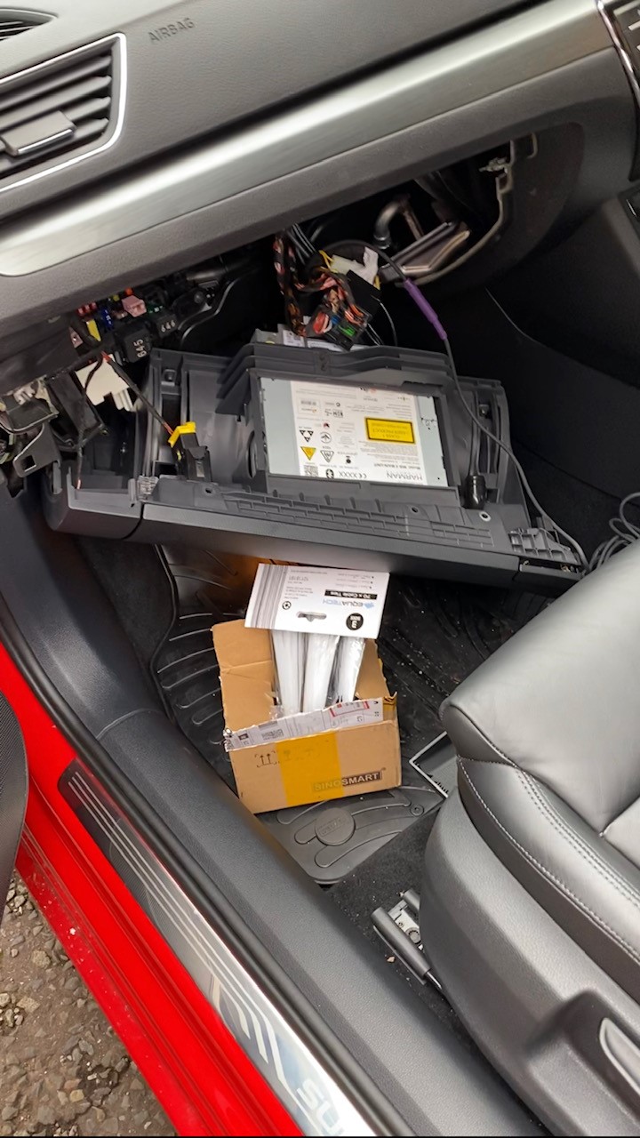

  6. I didn't completely remove the glovebox, I took all the screws out from the inside and underneath and then I let the glovebox dangle on the floor well. at this point you should be able to reach around the back of the stereo unit and unplug the main block, then attach your harness and plug it back in. just managed to find a picture, hope this helps. If you're near Warrington, happy to provide some assistance.

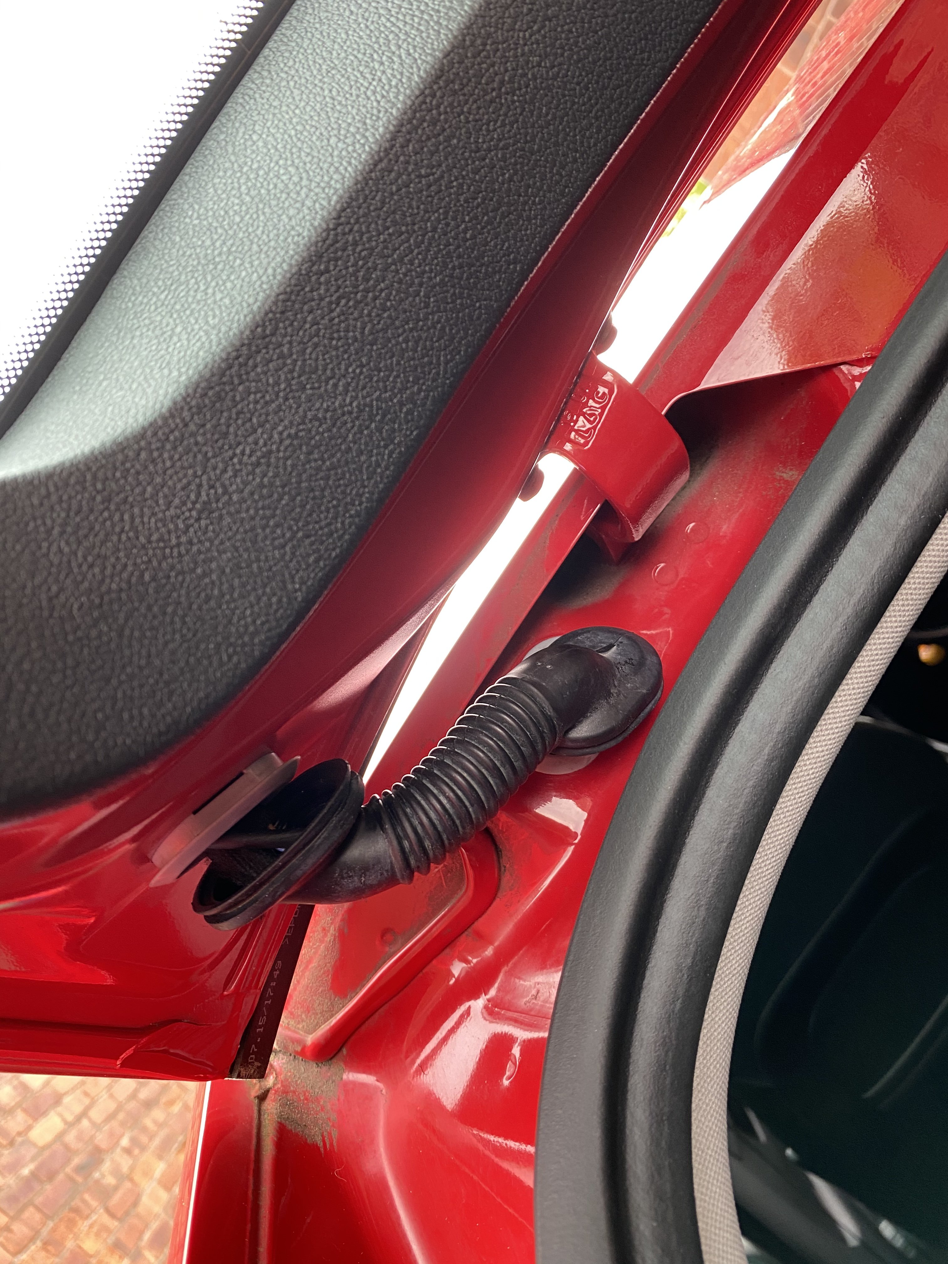

  8. i routed the cable through the C pillar into the roof, I followed instructions from the thread below. Very helpful guide and credit to the op.

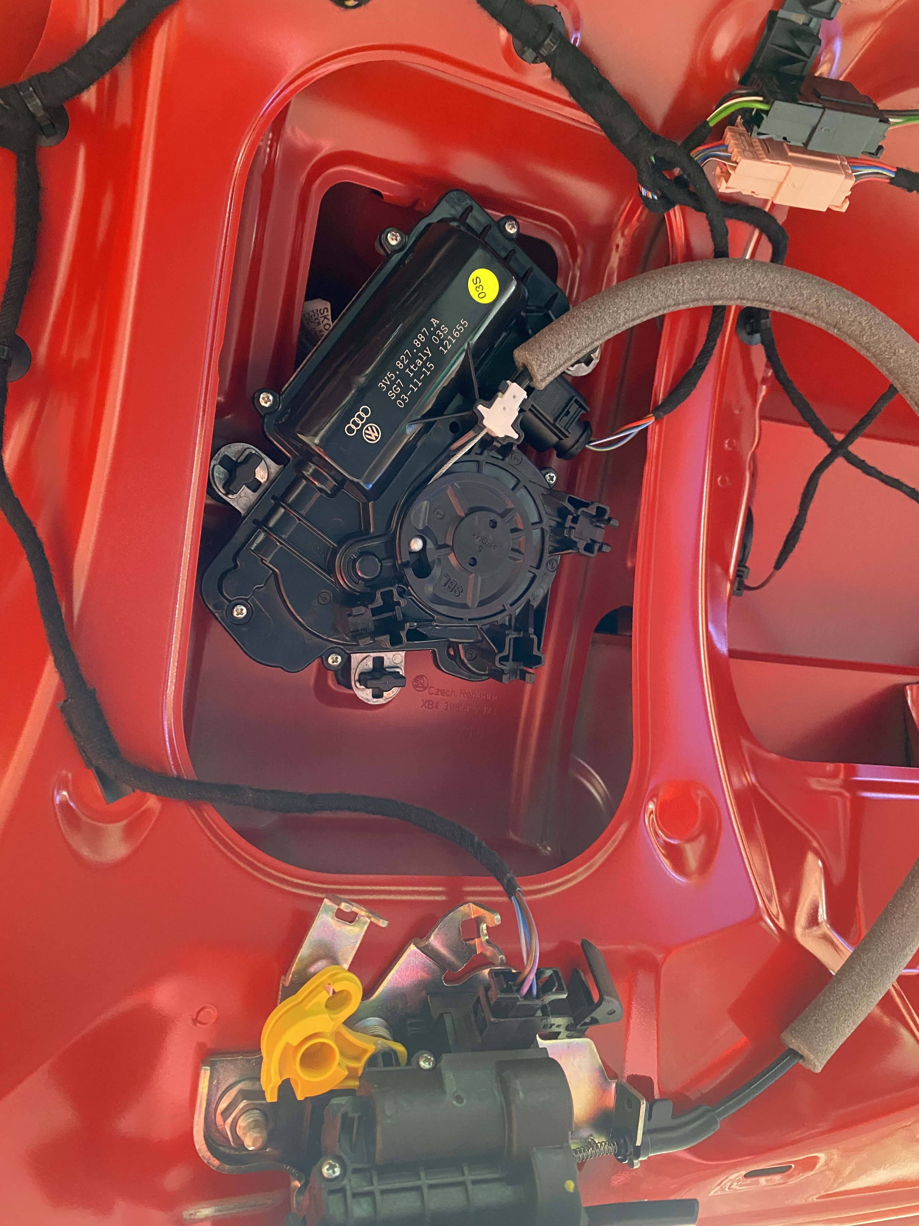

  9. Thanks for the suggestions, I’m struggling to find a screwdriver thin enough that I can leverage behind the pin to release the grommet. Will keep trying 👍 thanks I‘ll try this later, currently I’ve been using fairy liquid lol
  10. Does anybody have any tips for getting the rubber cable tubing back onto the plastic grommets? Really struggling with this

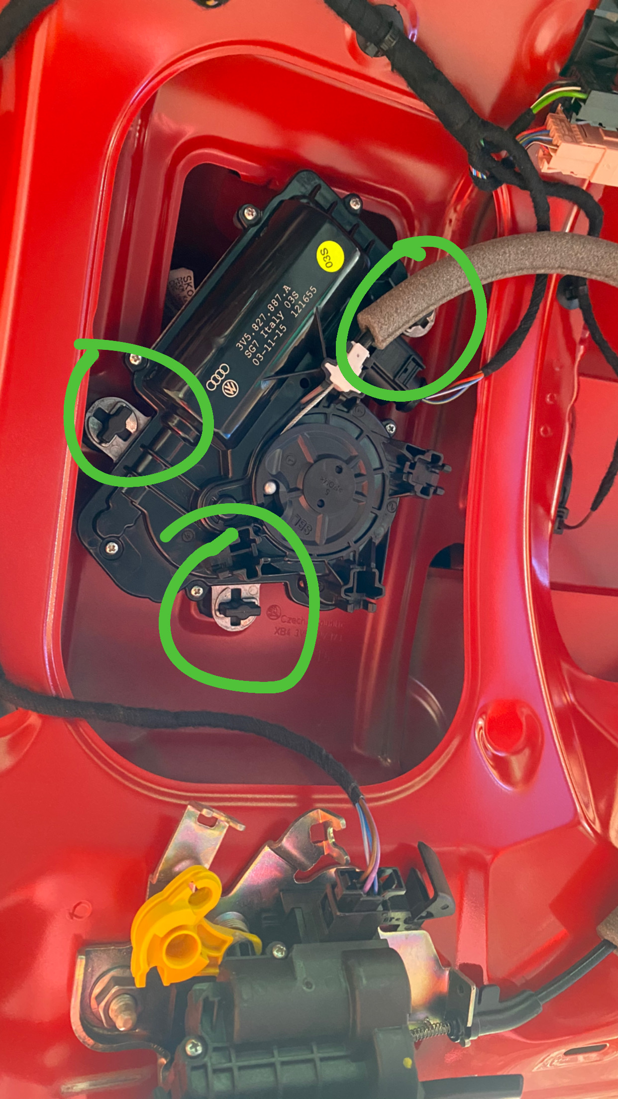

  11. Does anybody have any tips for reattaching the rubber tubing from the body to the bootlid? really struggling to reattach.
  12. Thanks all managed to remove it by twisting the black prong and it pulls right off. This then gives you access to the handle. unfortunately there’s no other way to access the handle other than to remove this part.
  13. Hi, I managed to get a reverse camera for my Skoda superb and have come a little unstuck when attempting to fit the handle. I believe it’s the locking mechanism in the boot lid. Does anybody have any idea how to remove this?
