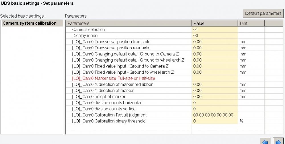

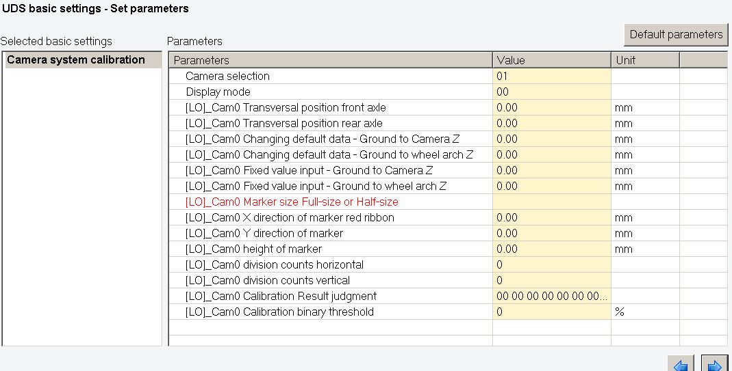

@JR RS you did an amazing job calibrating, would you mind sharing your calibration figures? I also have a notchback, and don't care about perfect calibration, just want to get rid of the no basic settings error
Sorry buddy but I haven't done a reverse camera install before, so I have no idea about the calibration or parameters involved.
