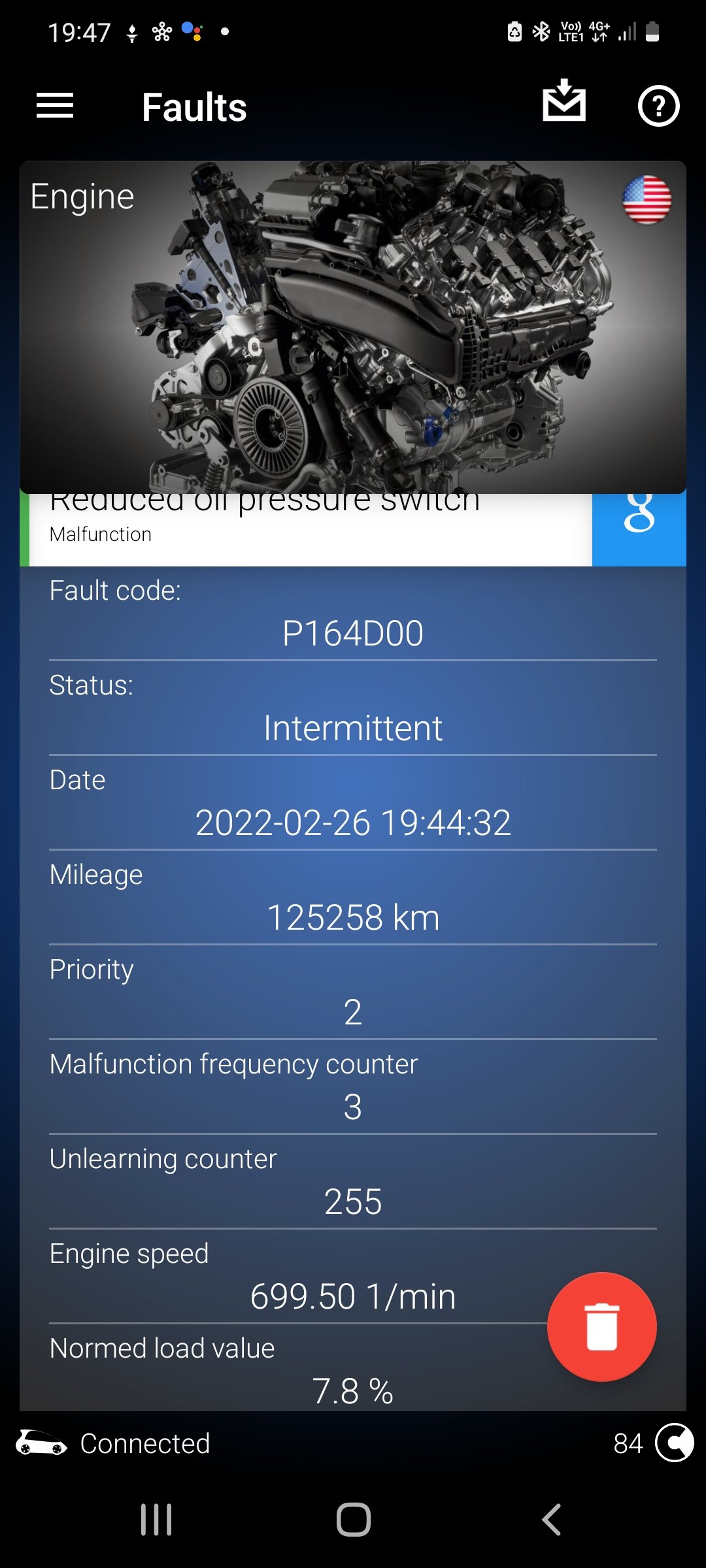

  3. Hello, is there any update to this topic please I'm having the exact same issue. Ever since I did my oil service a year ago same exact thing. I've changed oil pressure switches 2x, filter, filter housing updated to the newer type with return valve. the next step os to remove the sump and pickup. One odd thing I have noticed is that when the fault comes on and I press the interior heating it turns the fault off I'm guessing from the slightly higher revs.
