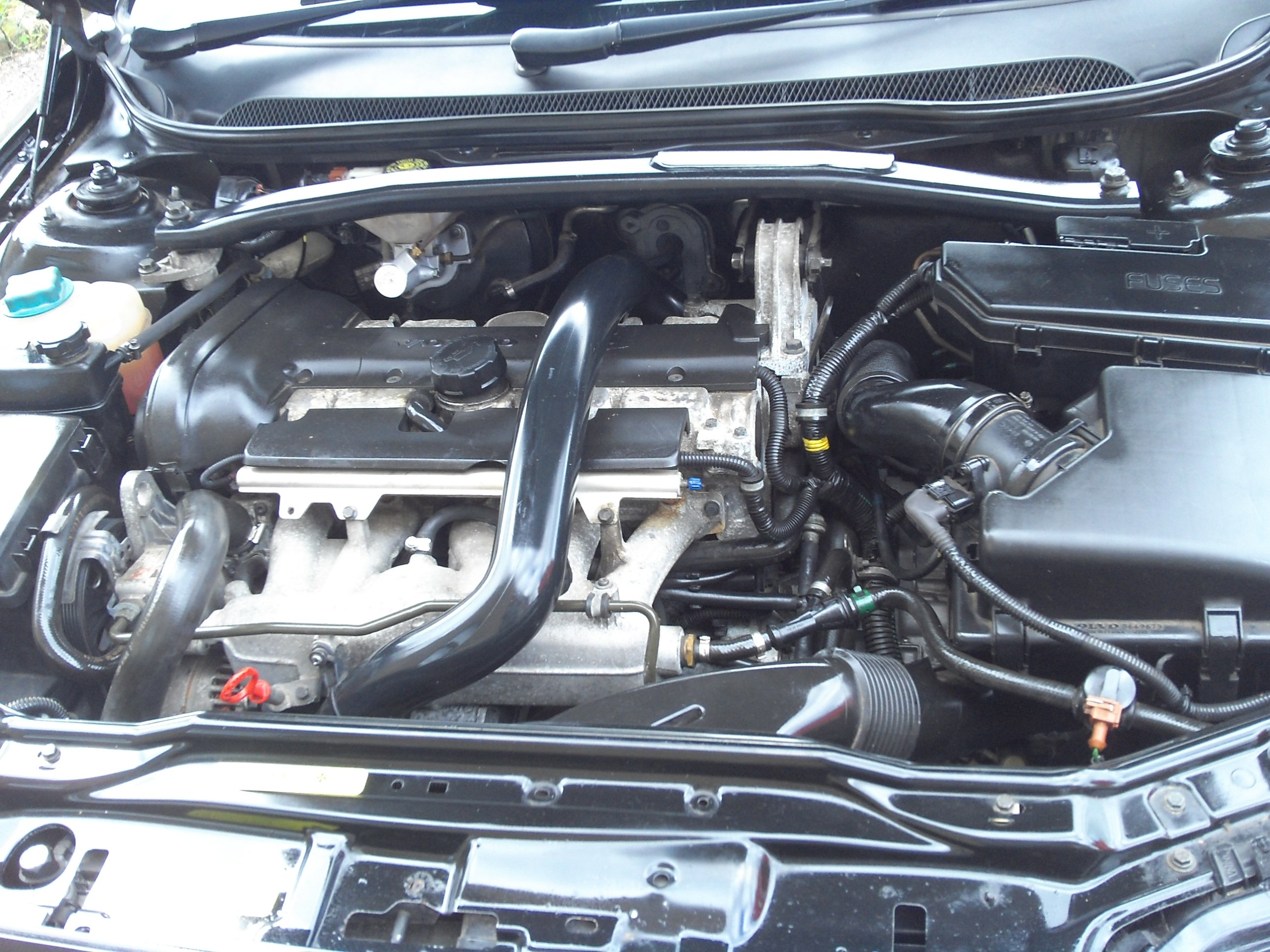

New-used / Replacement engine in my Volvo S60.
Drove quicky someplace for 140 miles and on the Motorway the 'Low Oil Pressure Light' came on,
openned the bonnet, dipped the oil, removed the Oil Filler cap, put it on correctly then no issues for another 3 years.
Not even an Oil change.
Sometimes life and car problems are the simplest of things that have you ready to cry.
Edited by Roottootemoot

What's the relevance of the oil filler cap George?
Ah, I see, this was on a Volvo. No idea how their oil pressure warning systems operate, but I wouldn't expect that a Skoda would necessarily be similar. Worth a free 2-second check though.
