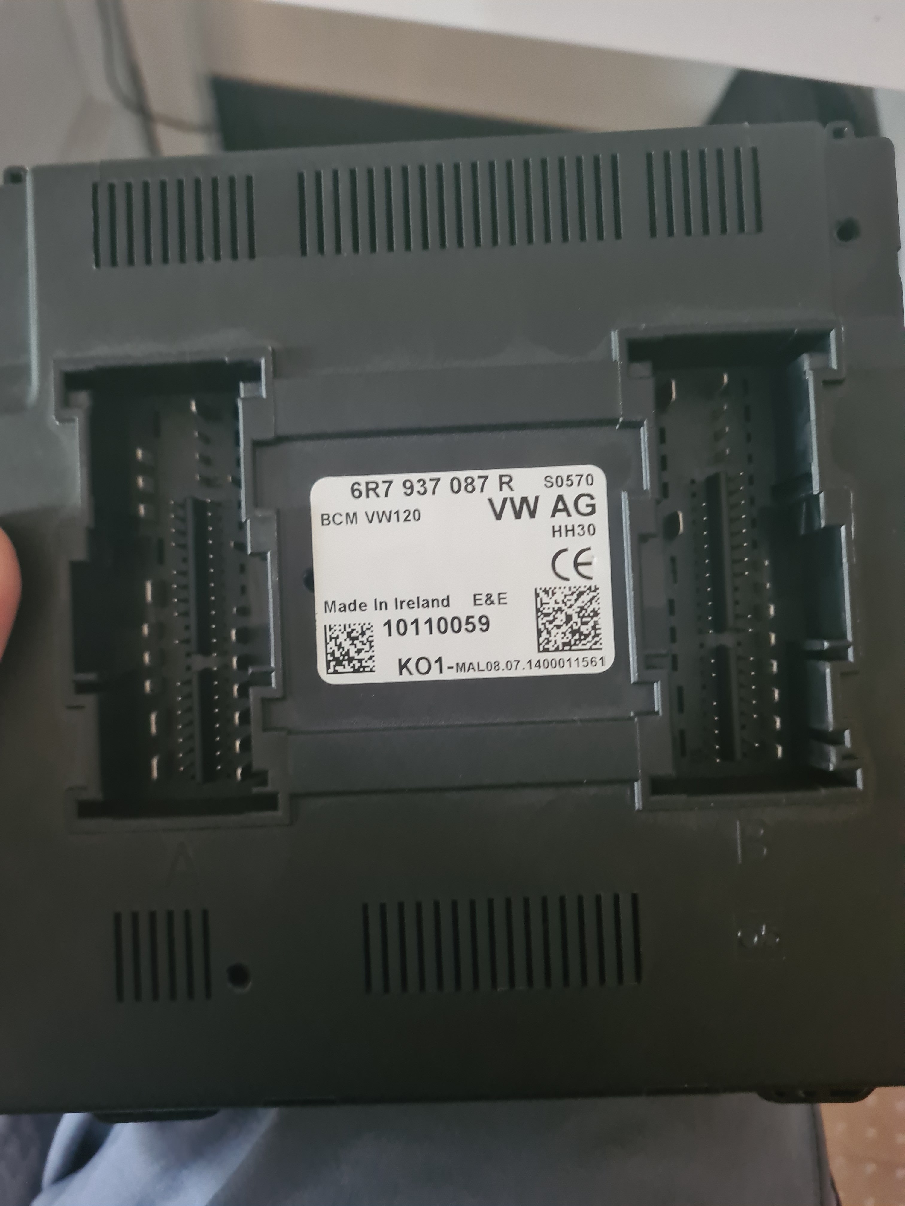

Hi Guys, Quick update; Replaced BCM with 2nd hand one, exactly same part number. Replaced 3 month old battery with brand new one. Replaced starter switch. Car starts on the button, left overnight with battery connected no drain, car started. Fault codes showing: sterring angle sensor, TCM and media system? Completed manual reset of steering, turning left/right, and reset fault codes. TCM and media still showing? Also since changing BCM, the remote central locking doesnt work, but all locks lock from drivers door. Does the BCM require coding? Few more checks then the big dash reassembly begins!

Slightly different number, but has 2 additional pins on top right to mine - would this matter? Do these need to be coded to the car also?

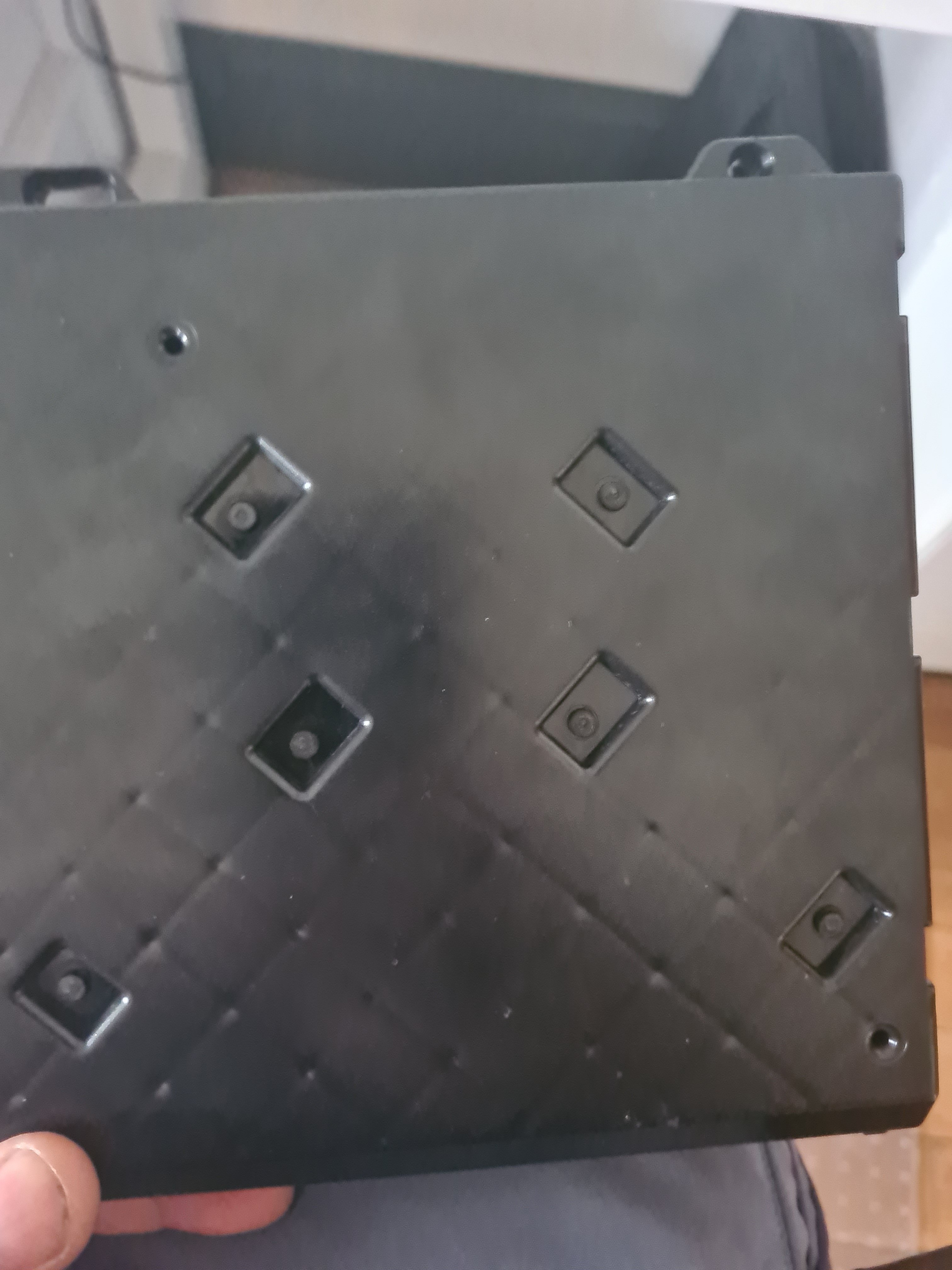

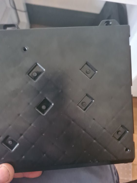

Definately wont come apart without breaking it - tried everything

cant seem to find a match online, neither...:( Similar numbers, but the last letter being an M or H Part number: 6R7 937 087 R- Fabia 5J, Mk 2, 1.2TSI electrical problem

The car that keeps on giving! Battery fully charged, connected to car, hazard lights flashing, Hazard lights switch disconnected and all 645 relays removed, BCM clicking away; is the BCM gone? - Fabia 5J, Mk 2, 1.2TSI electrical problem
