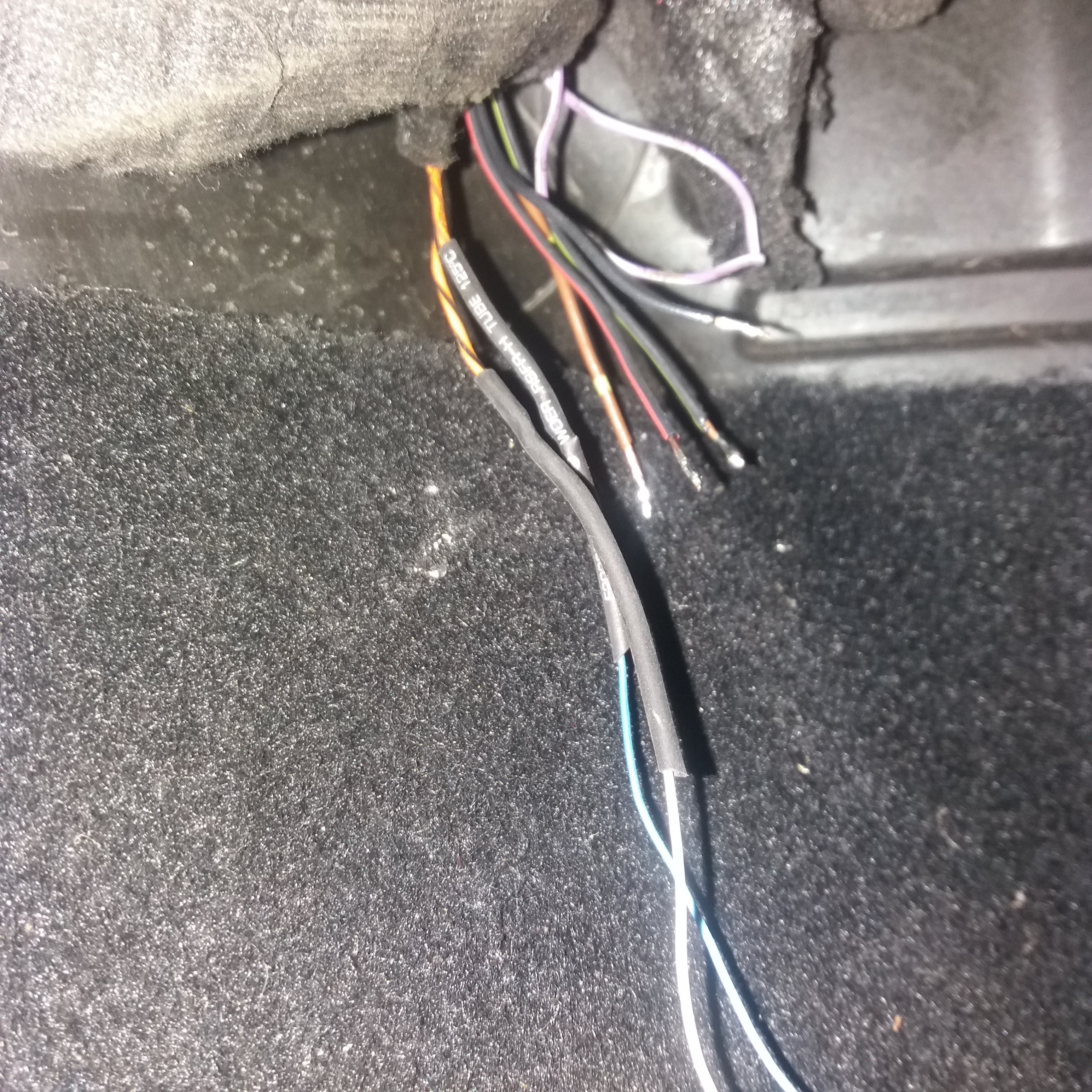

  3. Apologies, on my car there was a small fuses units added for trailer lights etc by the previous owner. This is not part of the standard build. The loom damage was behind the side panel of the car boot.
  4. Clearing the airbag light was a bigger problem than anticipated. The rodents damage was at 3 separate sites, the engine bulkhead, the roof near the airbag crash sensor and at the rear of the car near the rear fuse board. Wiring repairs were required at all 3 sites to clear the airbag light. The car is now fully repaired and operational with no fault codes. The next task is to find a good rodent repellent as I have also detected some rodent activity on my daughters VW caddy. P.S. the dog was frequently jumping up on the car front wings and may have detected the rodent activity before I did.

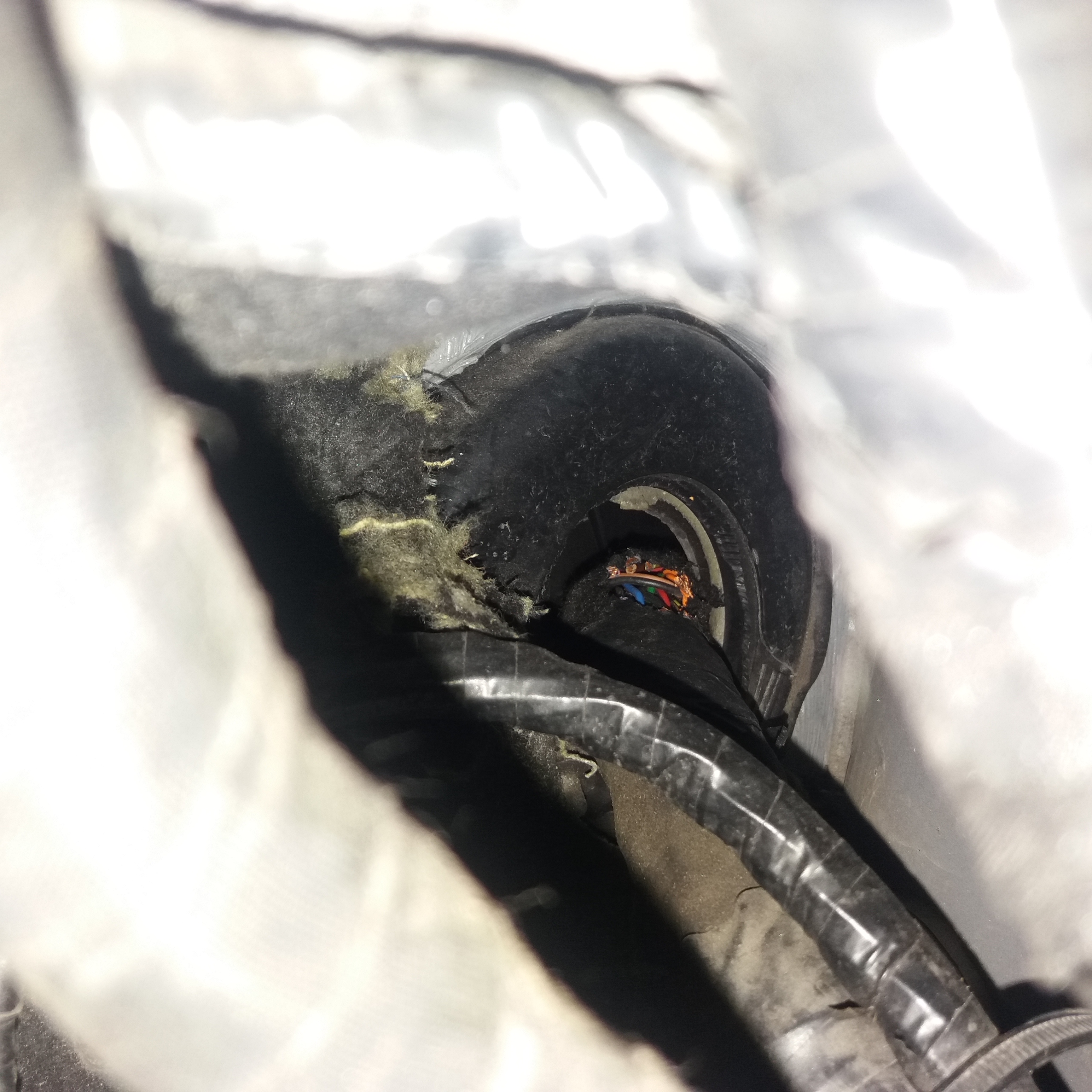

  6. Thanks Austin 7. Yes, I have decided for the moment not to remove the dash and blower housing. I am essentially following your strategy. I have identified the 6 broken wires by colour code and can pick them up on both sides of the bulkhead. I have stripped the cable loom cover 50mm on each side of the bulkhead. access is still difficult but I think it should be possible to solder and heat shrink 6 interconnecting link wires. Broken wires are now visible under the pollen filter (see photo). Will try to solder tomorrow.
  7. Tony, many thanks for the pointers. I will check them out this evening and give a progress update later.
