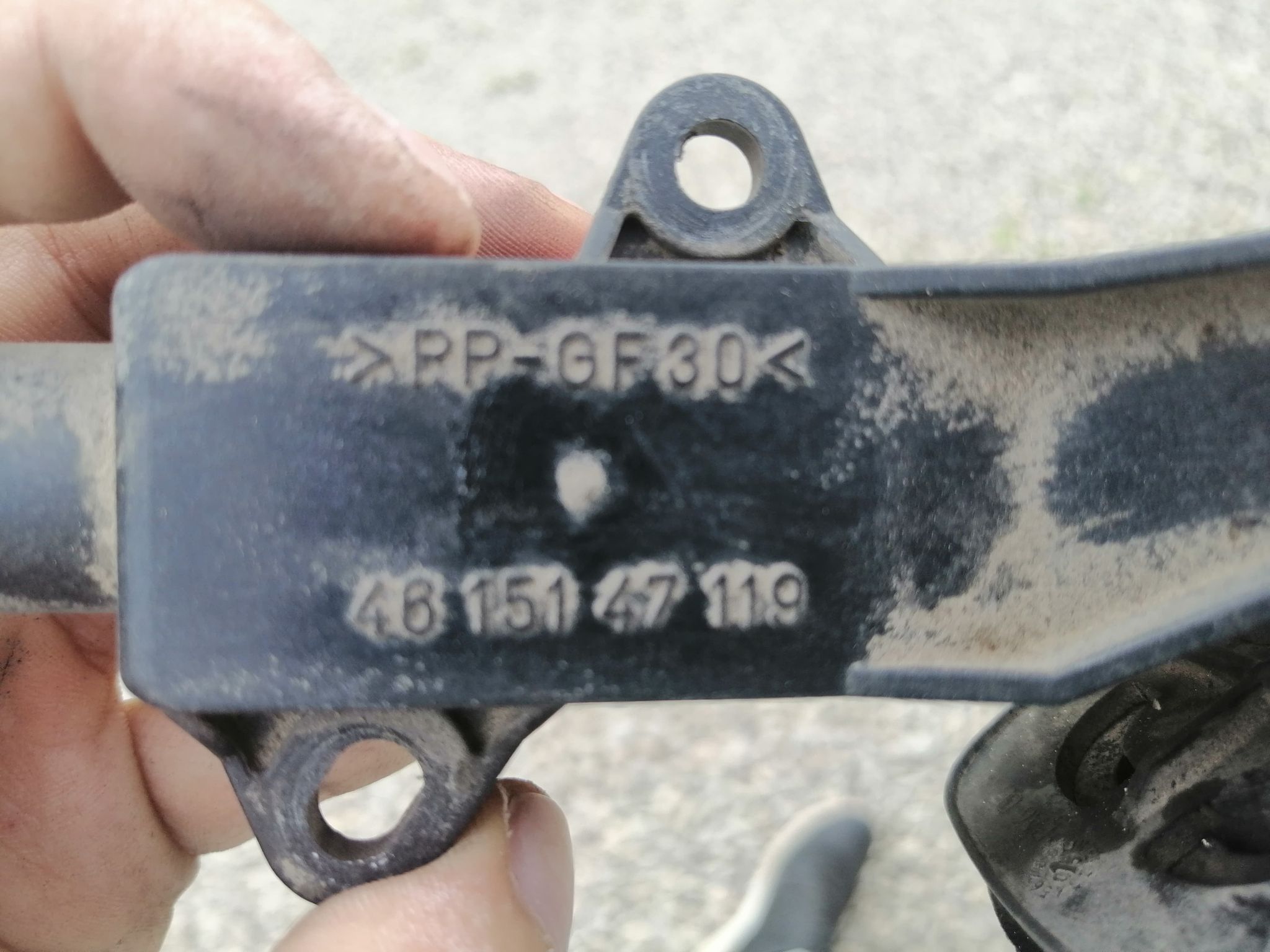

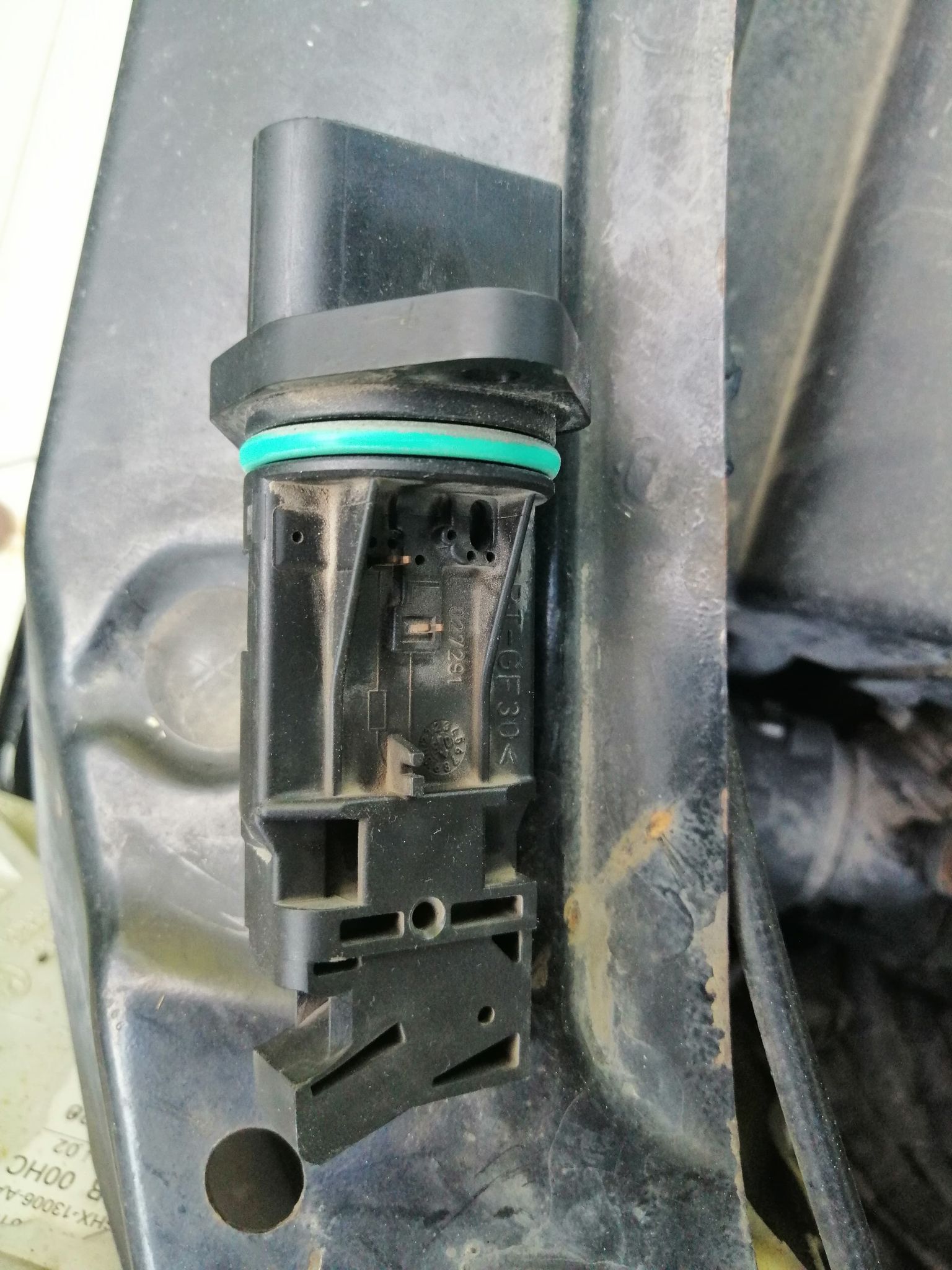

  4. Someone please help as I need to buy the part to have my car ready for a trip
