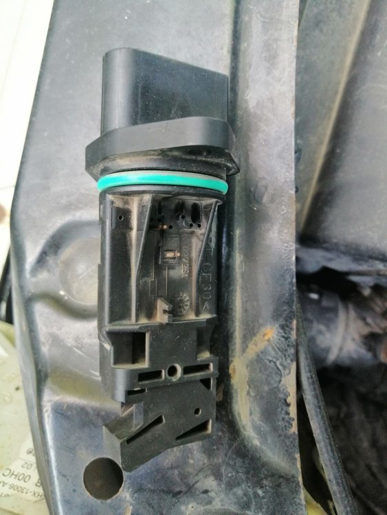

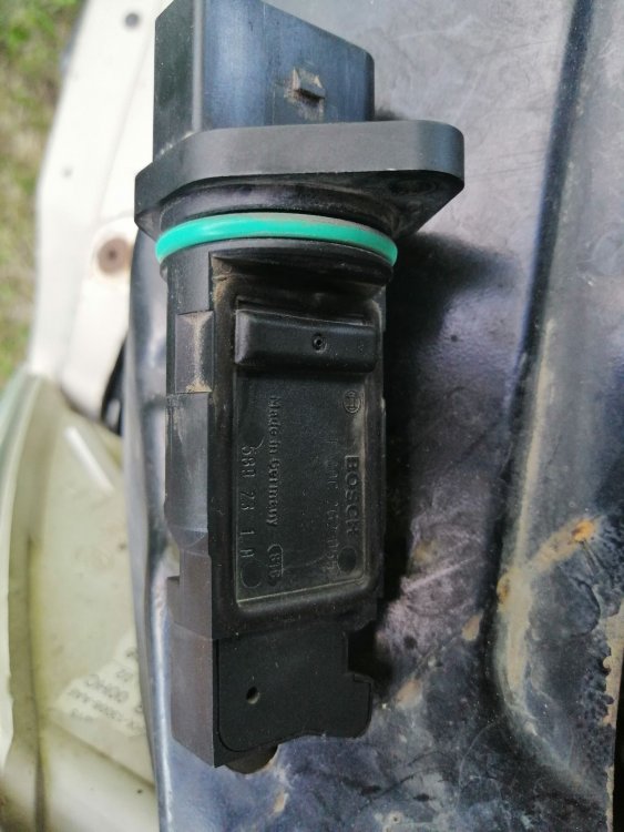

But the issue is with buying a new one, I took it out, went to a parts store and they couldn't find a match by the part code, or one that looked like mine. I'm leaving some pictures below, of the one that I have and wanted to know how to tell which would be okay to buy as I won't be able to return it.
 197539244_534401887969122_6020353402502581836_n.thumb.jpg.83027ab1ad1f2e76958b0e56b8d75fe4.jpg196525492_341383124012807_1112867979114495181_n.thumb.jpg.0e0e732fe54191d1d1c9fd1aa456e948.jpg
^ Sensor in my car^

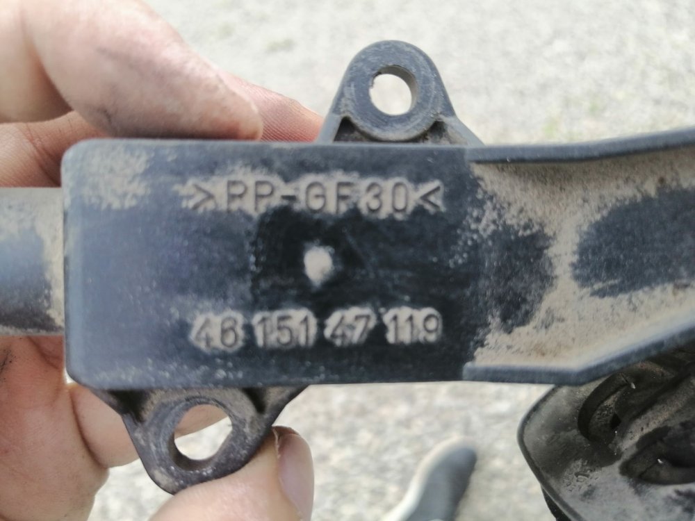

And another thing I wanted to ask what's this part? Some sort of gate in the bottom of the airbox, couldnt find it online and it seemed to not be working properly as it just flops around. And where does that air go as the hose that it leads to is full of dust and anything else that goes below the filter (which is probably not great)

I would trying taking off the plastic pipe which the MAF goes into as there should be part number there as some of the Bosch replacement ones come pre-installed, so you replace the complete pipe rather than just the insert.
  • Sponsor
The Bosch part number of the MAF is F00C262055. Written just below the word Bosch. Copy/paste that into ebay or ask your preferred local motor factors to get one for you. All the 0's are noughts not letter 'oh'.
Dunno about airbox thing but almost certainly safe to ignore for now.
