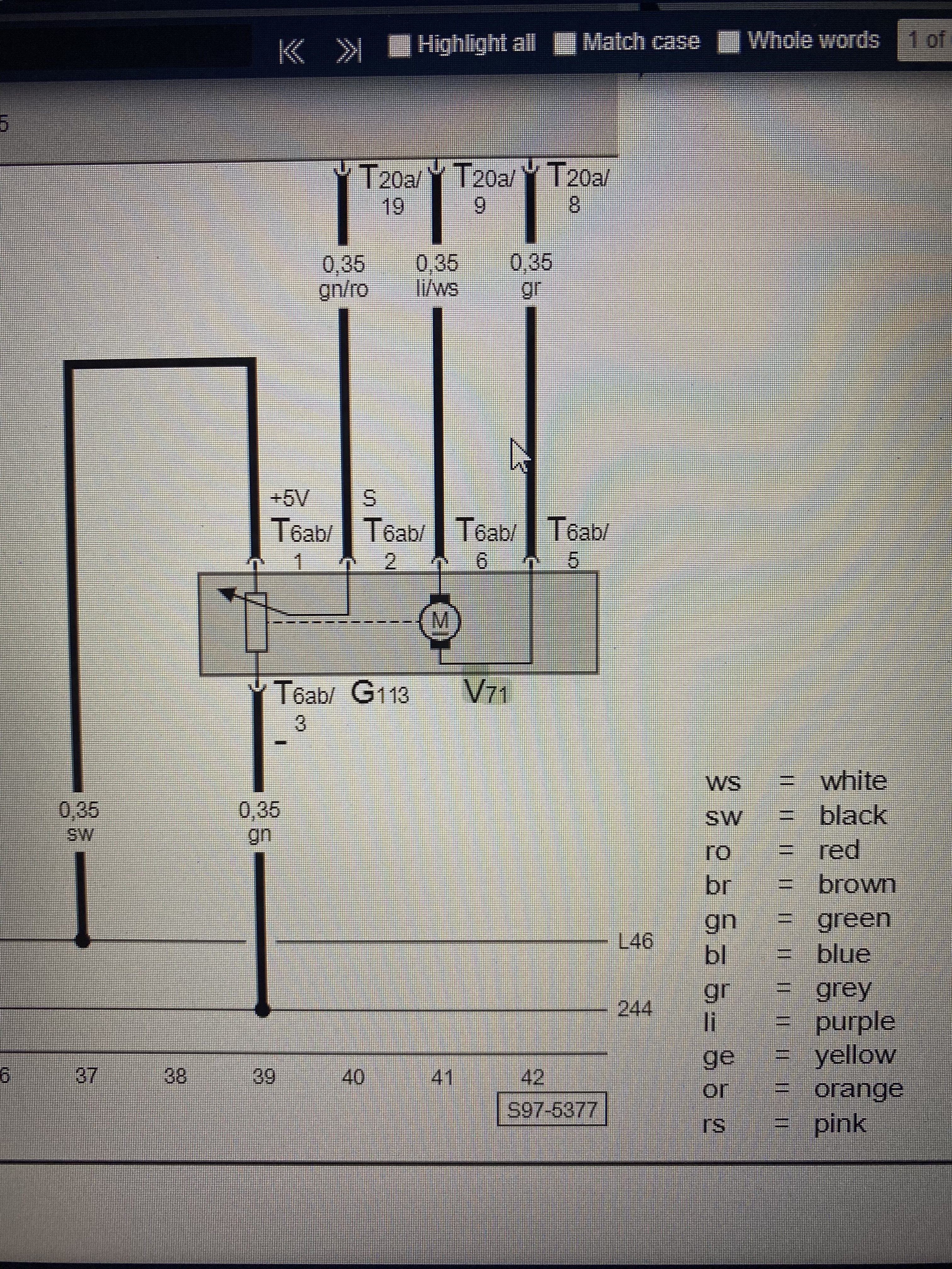

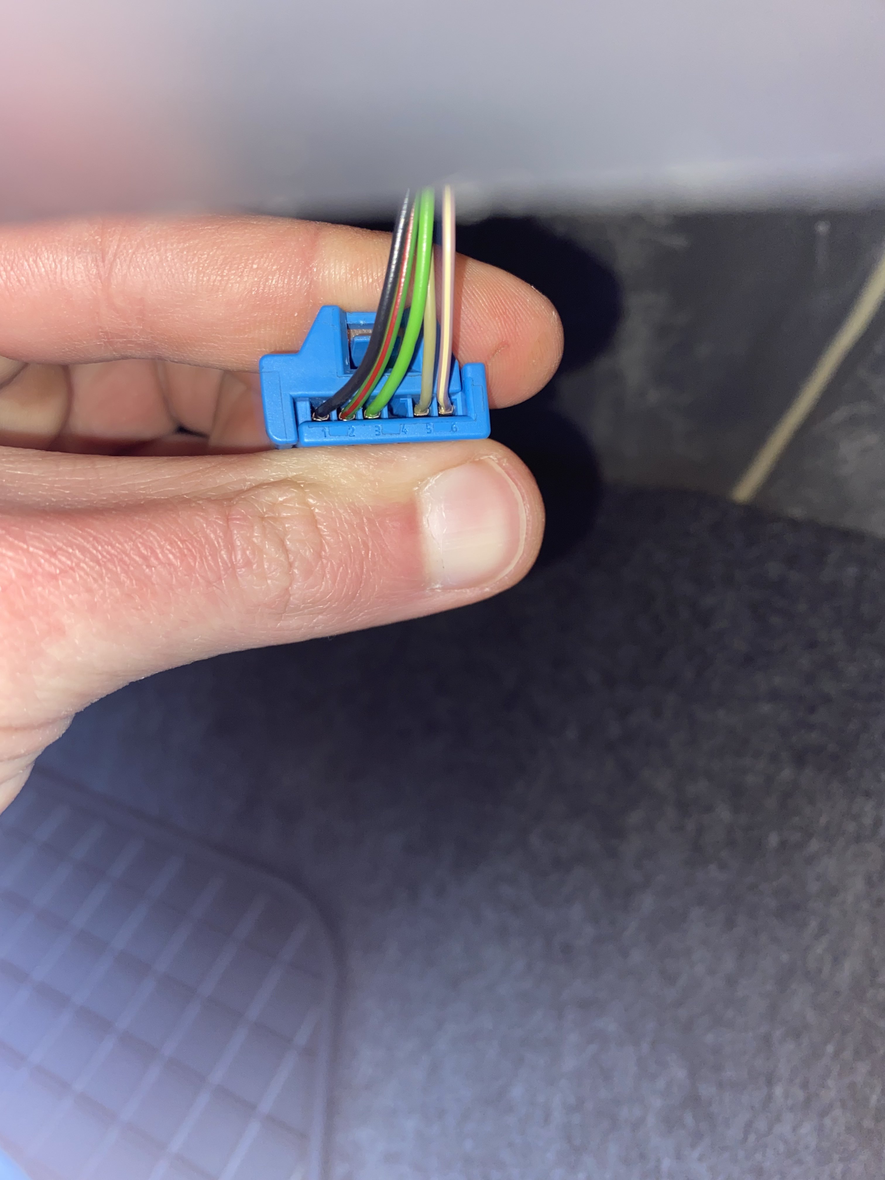

  6. Update: It turned out that the pins are 5 and 6. Two of the motors are working and one is not working. So the problem is not in them. I guess there is a broken cable somewhere or the problem is in the climate control module (although when you press the recirculation button, the potentiometer G113 does not remain a constant value, so it accepts the command to press the button in my opinion).

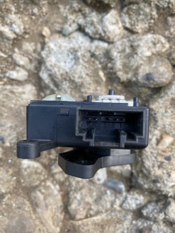

  7. Can I test them manually? Through pin 1 + 5V and pin 3 ground. With a small scooter battery.
  8. Can I test them in any way if they work?There are a total of 5 pins in the socket.

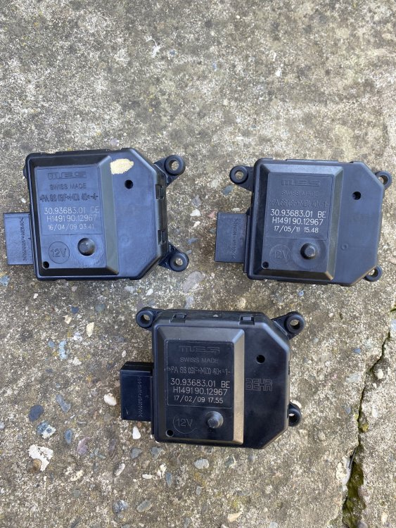

  10. No, V71 air recirculation motor. Tomorrow I will attach a picture of the motor.
  11. Is it possible that both motors do not work? I know there is no guarantee that they work.
  12. Yes. Every time I installed a motor, I returned it basic settings. I will attach a video tomorrow to see how I measure them.
  13. Hello, I own a 2009 Å koda Fabia 1.4 TDI. Even with the purchase there is an error in the climatronics - 01274 - Air Flow Flap Positioning Motor (V71) 000 --- Intermittent I replaced the recirculation motor, but the error remained. I bought another one, but it didn't work out either. I bought them second hand - according to the sellers working. I have VCDS, read Auto HVAC in Measuring Blocks: Potentiometer G113 116.0 specified (with the recirculation valve switched on), 17.0 (with the recirculation valve switched on), while the value of actual remains the same (16.0). When installing the other two motors, values of specified are (114.0 and 113.0), but value of actual are constant 10.0 and 12.0 I apologize for my English. I guess the problem is with the wiring or in the climate control module. Has anyone encountered a similar problem? Thanks!
