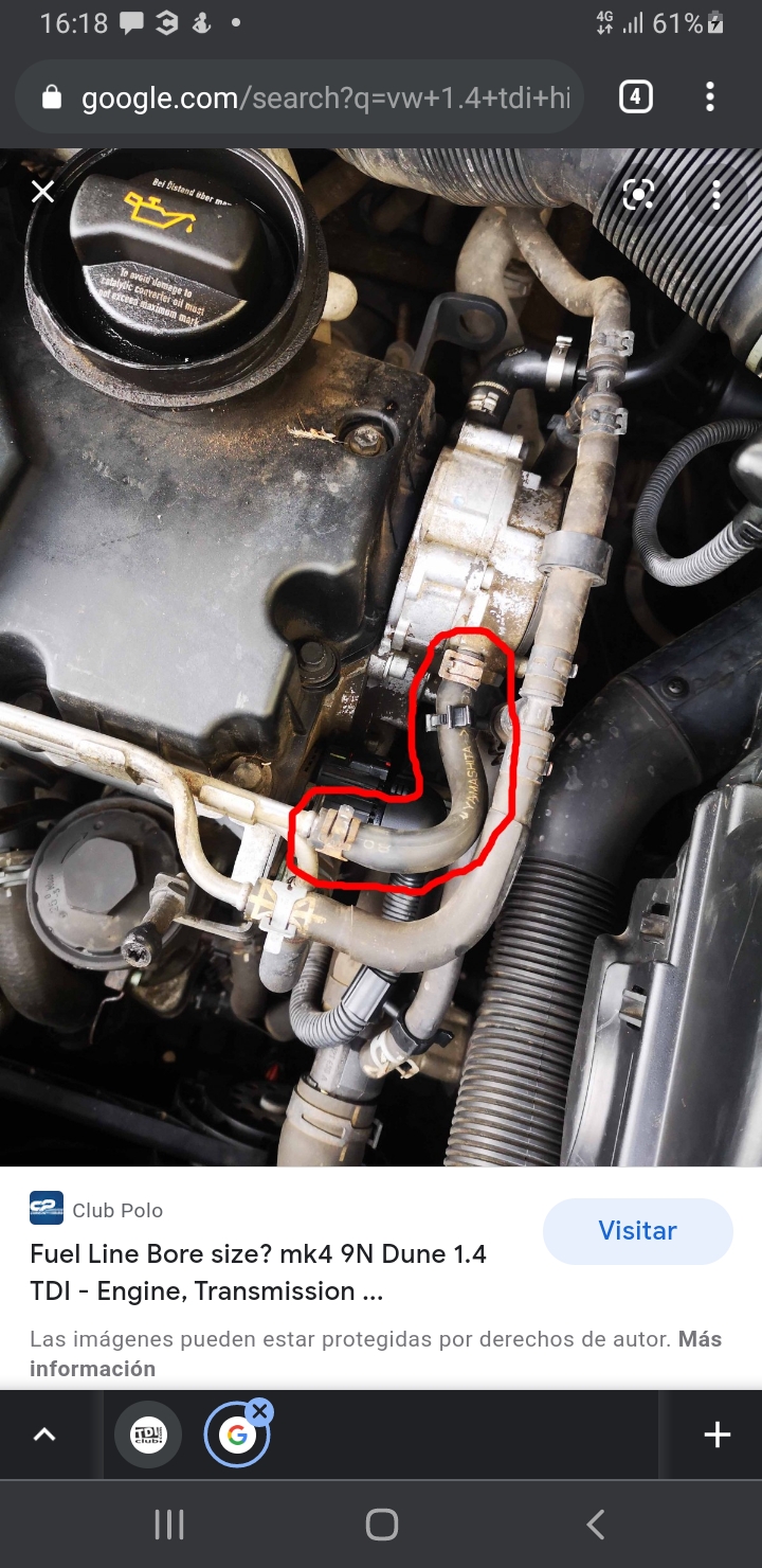

  7. dear friends i have to change the hose mention in picture , do i have to prime diesel after changing this hose or it will prime automatically.

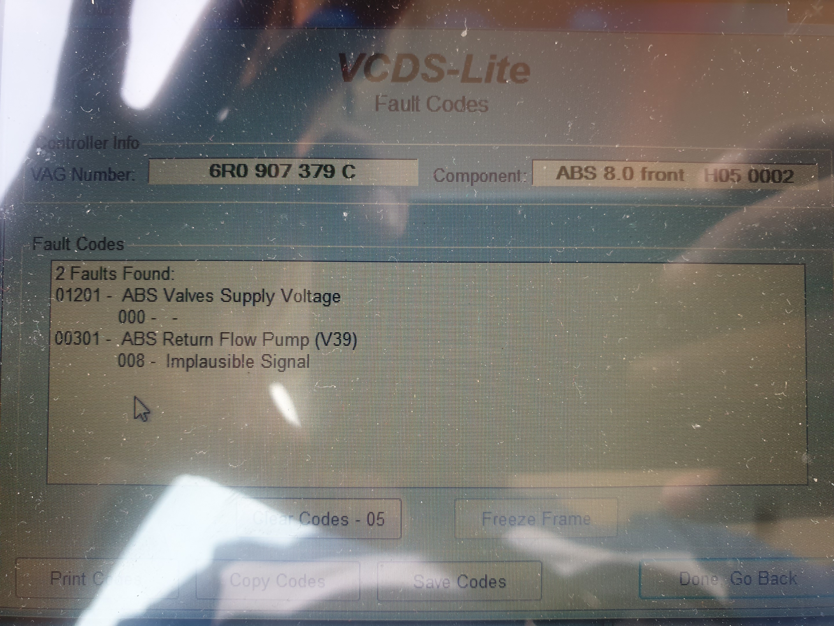

  12. i try with vcds found these 2 codes attaching pic
