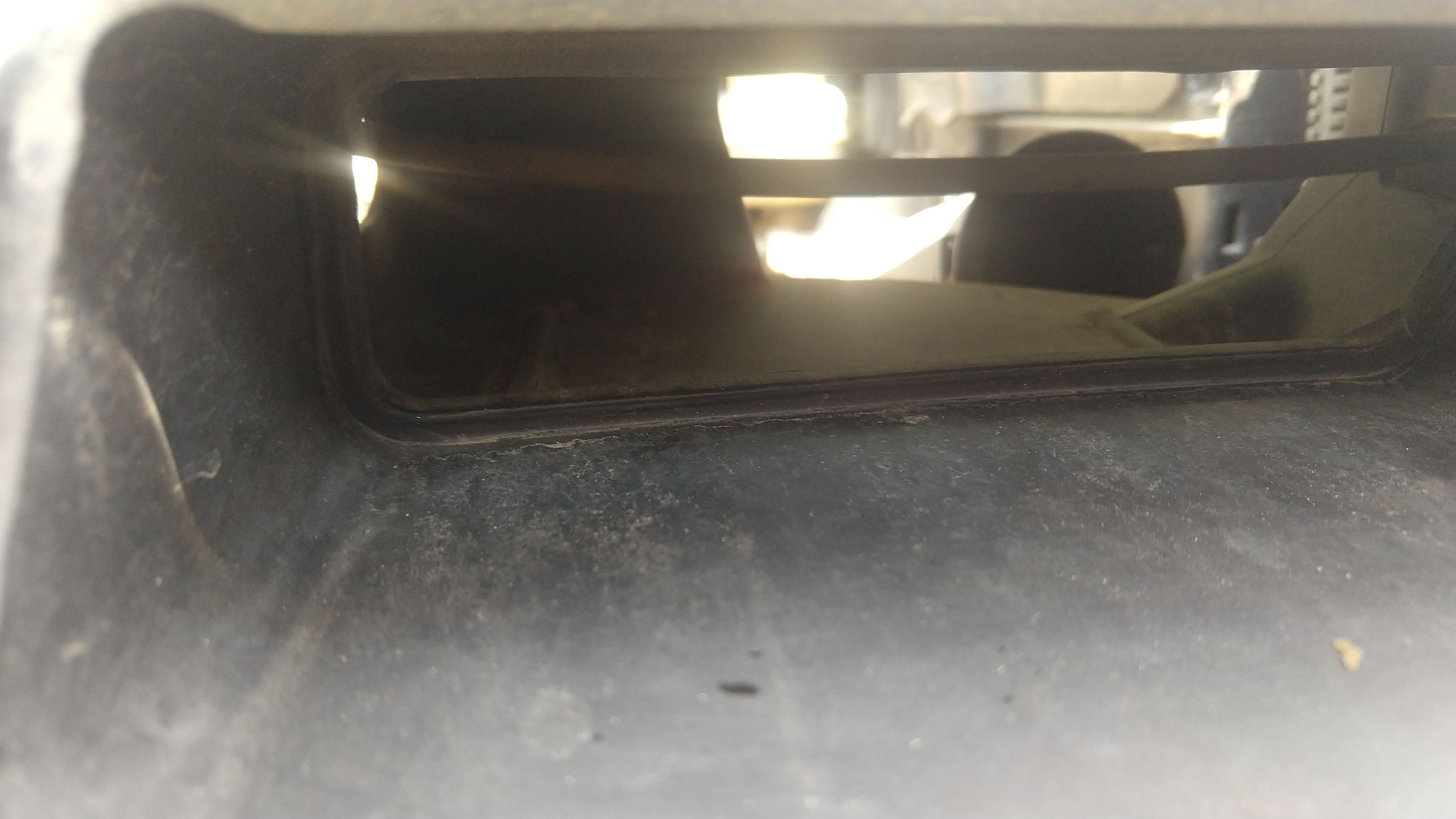

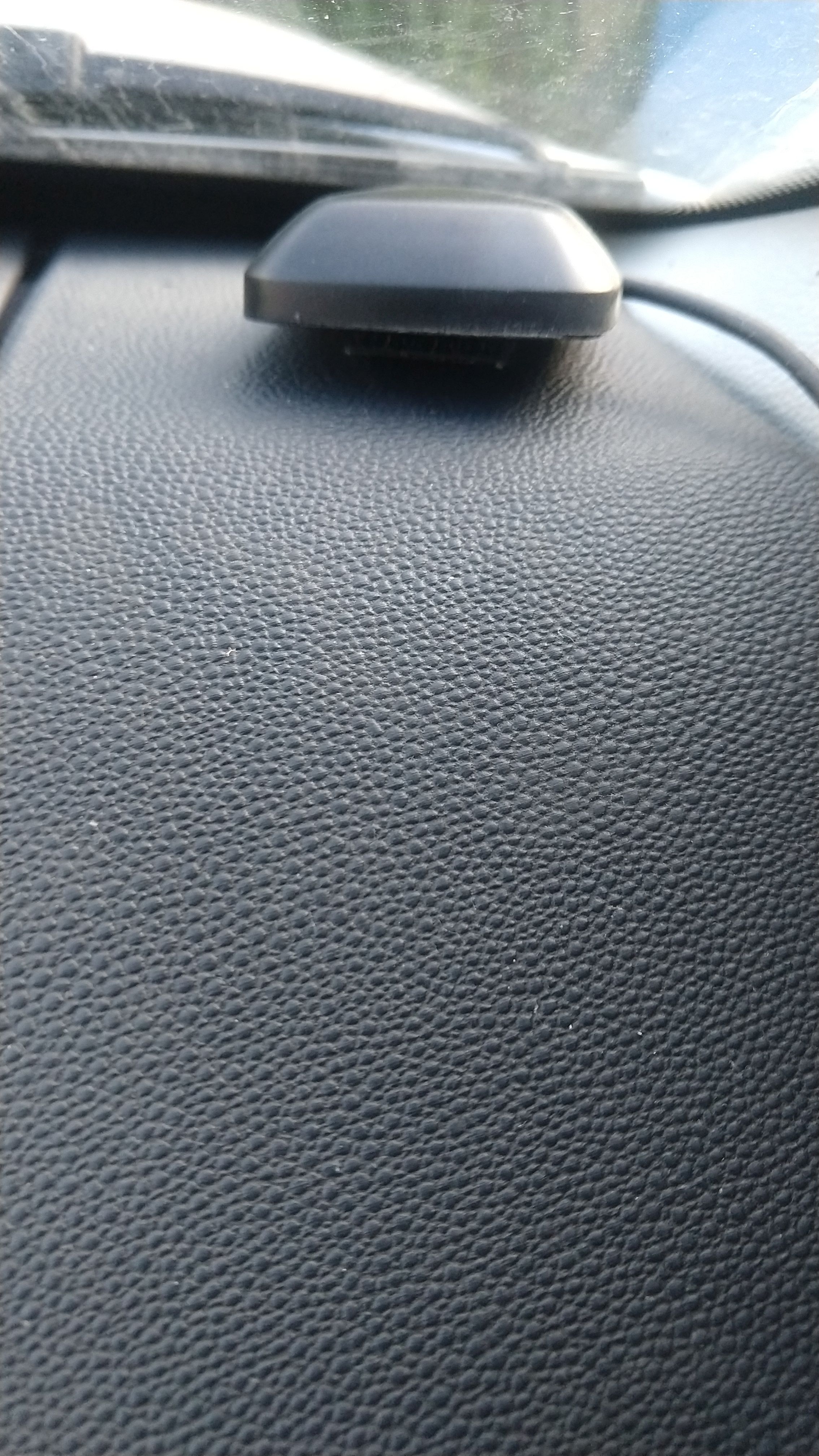

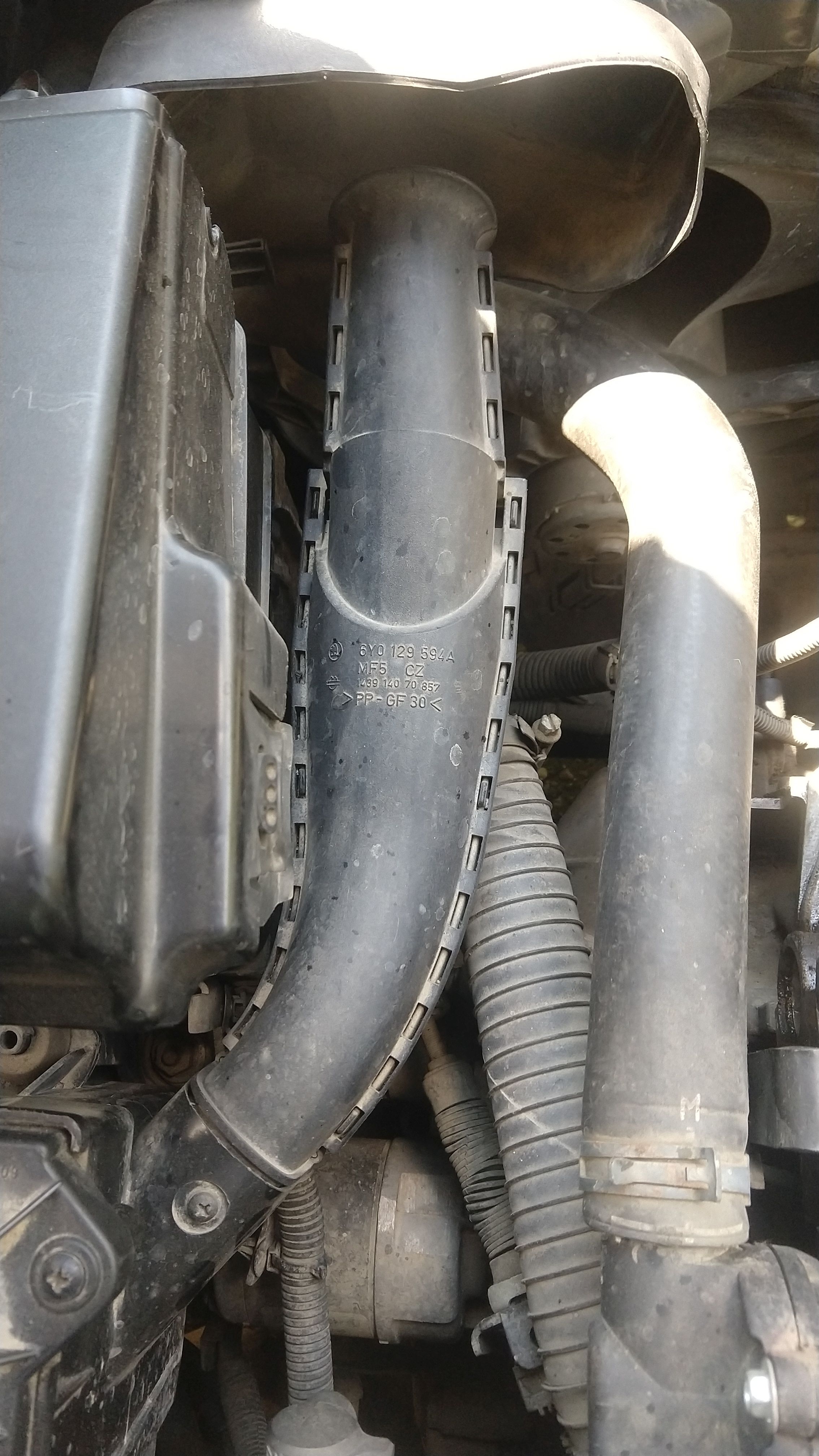

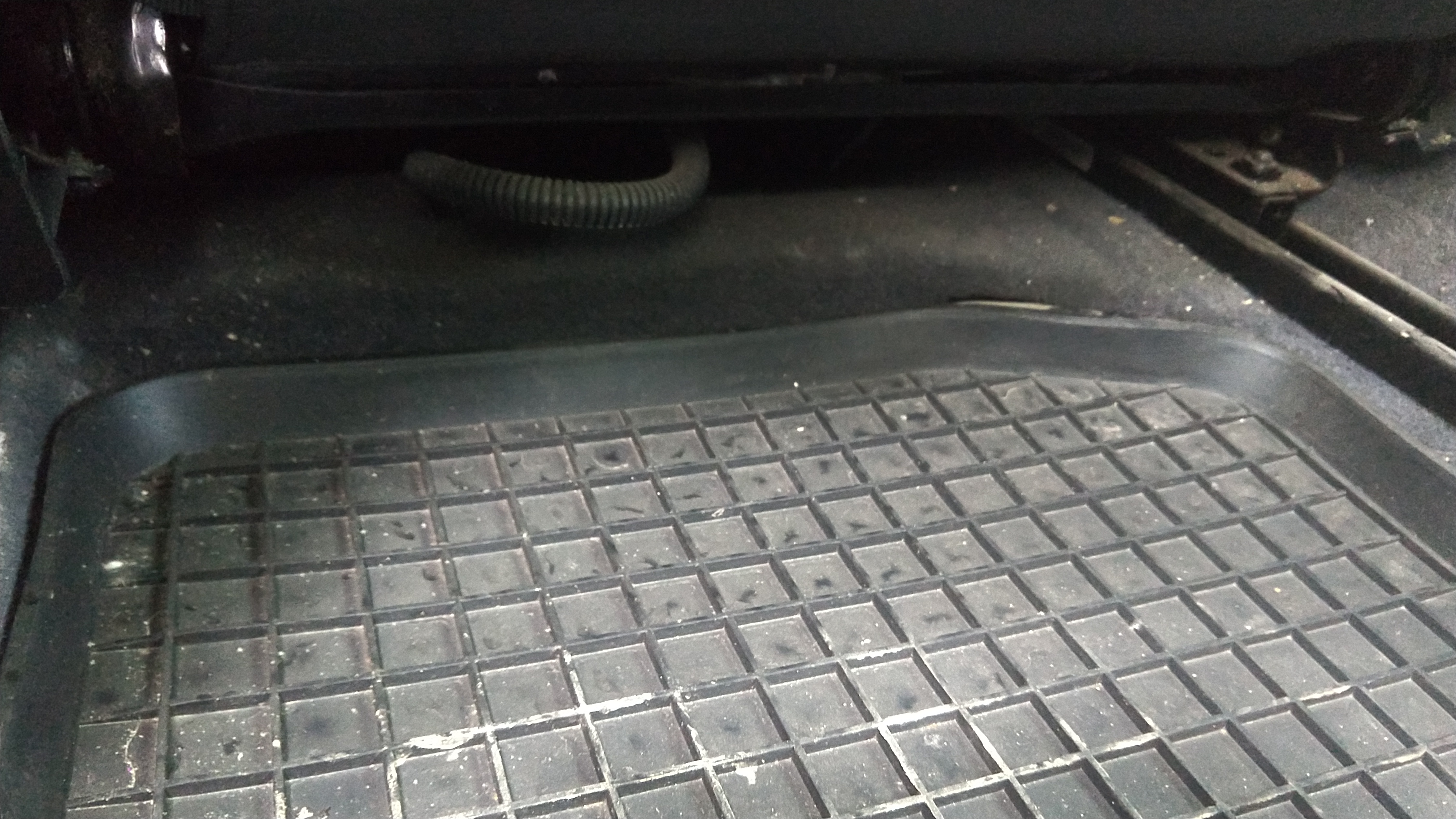

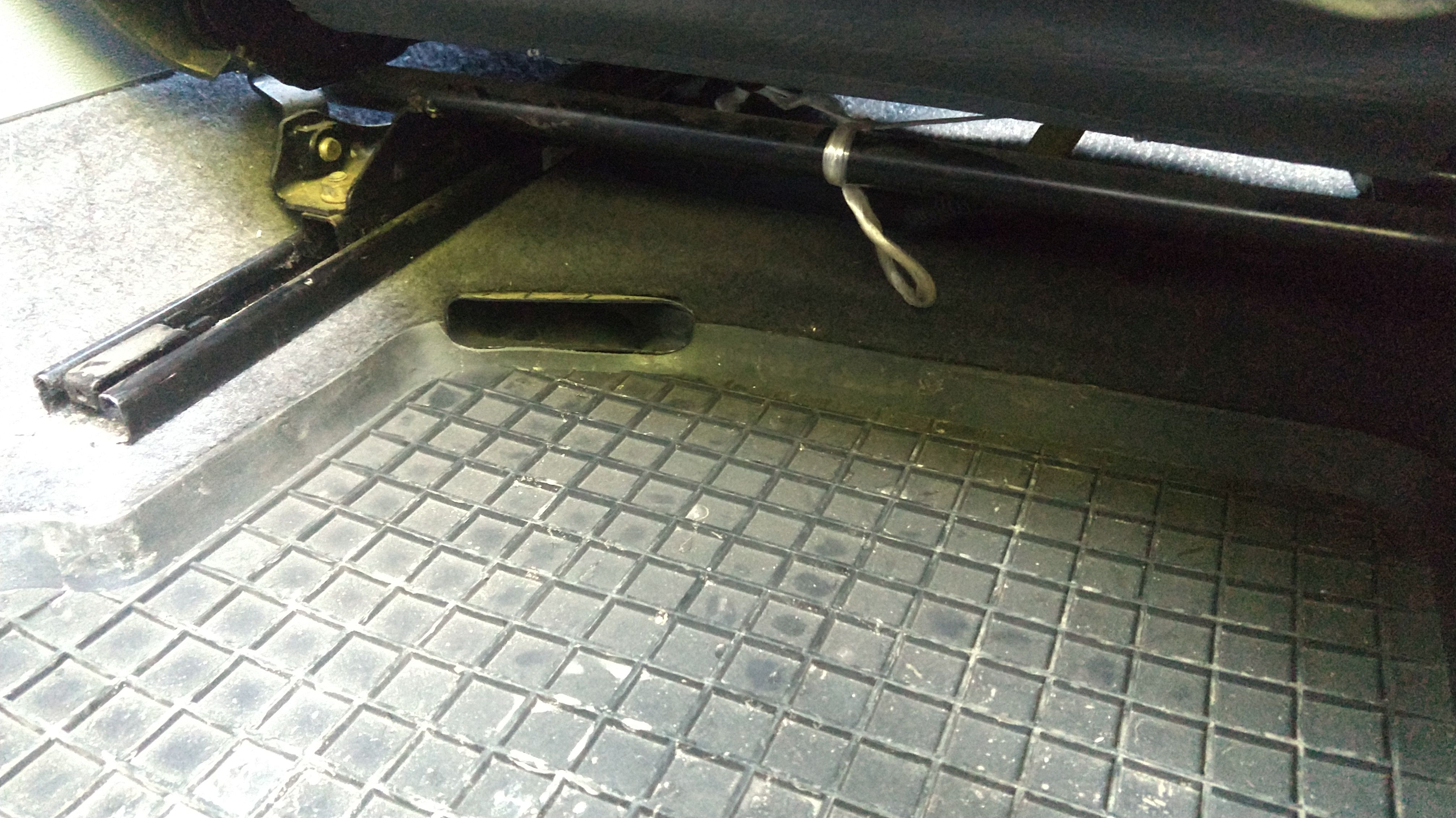

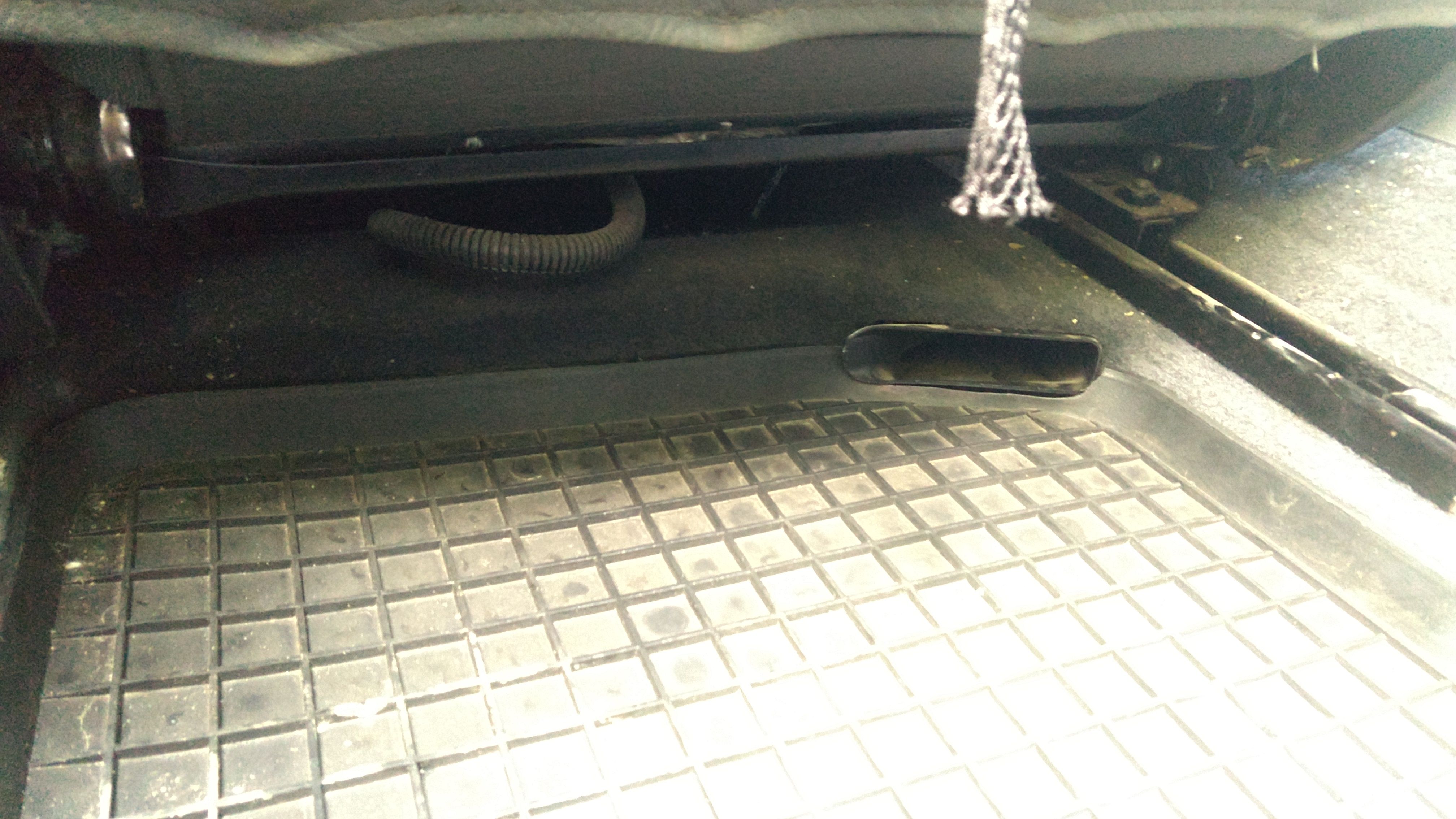

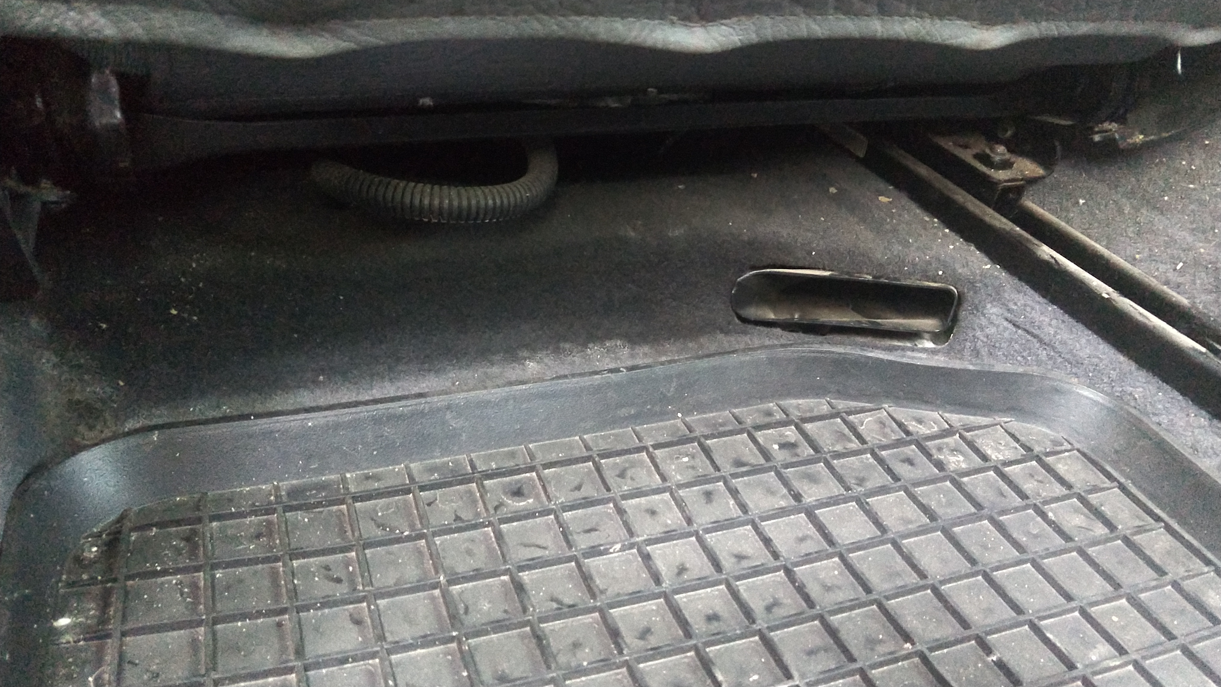

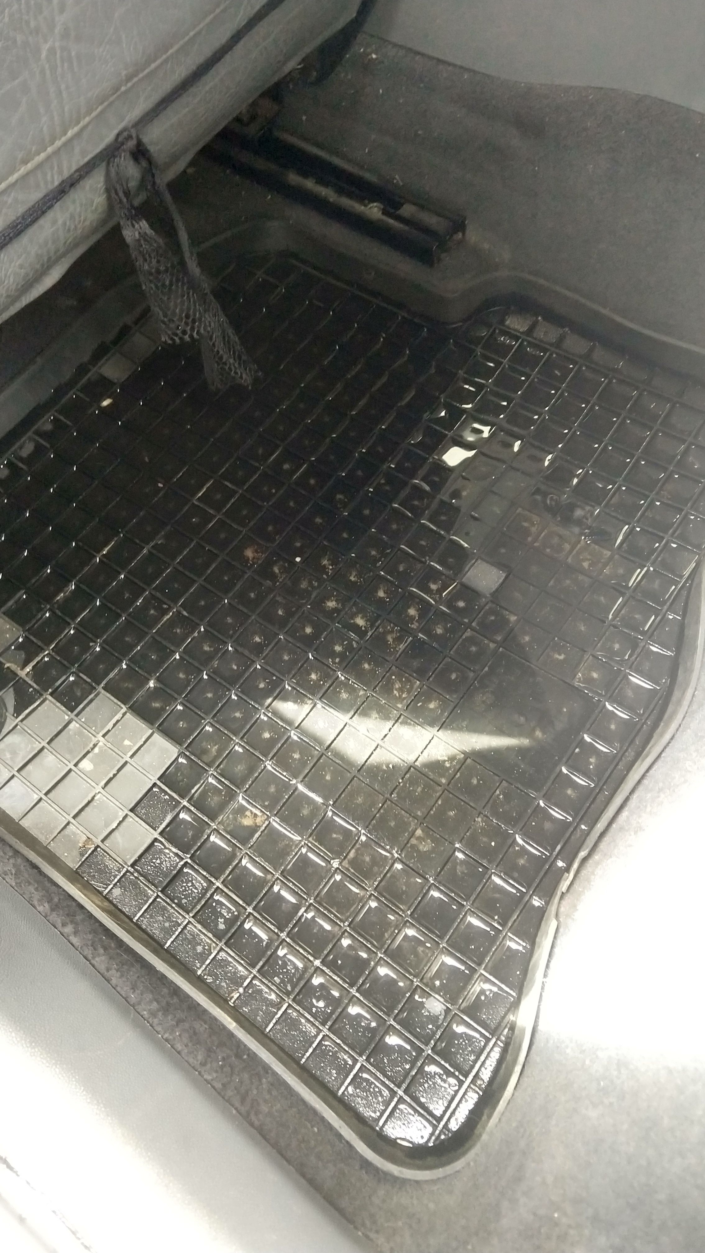

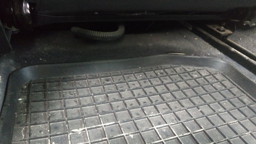

1. I first tried to stick the mat under the vent but it looked too forced. So I ended up using a box cutter after marking the curvature with a pen and the rubber cut so nicely it almost looks like it came from the factory that way (joking). Picture with how much water it would gather when raining attached 2. I also sealed the rear doors today with some sanitary silicone. Somehow I couldn't pull the panels all the way off (I used a leverage to hold them up while working on them, cleaned with dish soap, dried, then applied the silicone with my gun a fair amount and smoothed it out leaving no gaps (didn't take pictures but happy with the result, at least until the first rain) 3. Now I'm looking on how to improve this car's performance. Better gas didn't quite help, I've tried for 2 months using OMV maxxmotion 100. I noticed the air intake being quite narrow, would modifing this with some sort of a wider different end help burn gas quicker? 4. What is that small thing on the right side of my dashboard? A sensor? The locking mechanism for when it had it on a remote? Now I can only close/open by putting the key in the lock. There's also a rattle coming from between the dashboard and the windshield

But if you seal them up where would the water go? Just sit inside the doors until it evaporates? Surely the engineers would've also made a hole for the water to drain outside the car @KenONeillhow do I find that pipe myself to check it?

Hello, since I got this car second hand, I've had to put a lot of money into it. Alternator, distribution sensor, brake fluid, suspension, water pump, recently gas filter and a few different things, probably around 1000 euros in total. 1. Smell of gas or exhaust gases in the cabin. This happens especially when idling at stoplights. On top of that the car seems a bit more sluggish. Some said it could be the gas pump failing, others that the medium exhaust might be punctured, some that the plastic engine cover is not stable and leaking gas from the oil bay. (Sorry my english is really bad) In fact the last one might be possible, as even if the plastic engine cover is fixed with 3 screws or so, it still gets loose on the top left corner and vibrates under the bonnet, haven't found a fix, maybe drill a hole and tie it to something internal, or as other users wrote on the forum here, get rid of it entirely and replace the oil cap with something that fits from another model. I plan on going today to a shop to check any errors on the cars computer and what not, or maybe straight to someone who deals with broken exhausts? 2. water getting in the left footspace of back passenger's seat, This happens once in a while, not every time it rains. I've tried to see if the windows were up (and they were fully) checked the door seal and it's intact every side. Also, there's no sign of water along the door to show the leak, it's always dry even when i checked right after the rain. It somehow gathers there on the rubber mat, as if it emerged from the floor. 3. related to issue 2 above, I noticed two air vents under each front seat, leading air probably to the passengers in the back, but right now they're covered by the side of the rubber floor mat (original one) so there's no air getting through to dry the carpet. I thought of cutting out a hole on that side just to let the vent outlet free, but then I think if water would gather on the rubber mat, it will also get into the air vent because it's at the same level with the floor. Some of these issues have been talked about on the forum and I'm here posting after reading all the answers, which were mostly just letting others know they exist. I am here wondering if there's a fix to these, like I said, maybe a modification for the vents to go above the rubber mat without cutting and damaging it, maybe somehow to seal the leak at the rear left door because older posts had image links that expired and don't know most of the terms to try and see what's wrong and maybe fix it myself. Thanks for the interest if you've read so far and hope we can find answers together that might also help others in the future.
