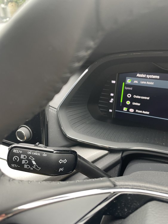

  1. Thanks all. Booked in with the dealer. They agree it’s probably software issue.
  2. When I test drove the car before buying I tested the cruise control and worked well! Weird.
  3. @Kenny R I don’t have that button
  4. @Bouncypetewas the software fix something the dealer could do rapidly or takes time?
  5. Thanks all for your help. Yes switch A is on. I think Bouncypete I’ll go with you suggestion and go to the dealer
  6. Thanks for the suggestions but I don’t have that second stalk
  7. Yes at speeds upto 55mph
  8. Hi just bought a 2020 octavia new shape. I can’t select cruise control, it’s stuck on speed limiter. Please help. What am I missing. IMG_2007.MP4
