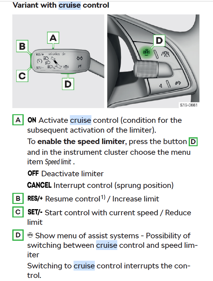

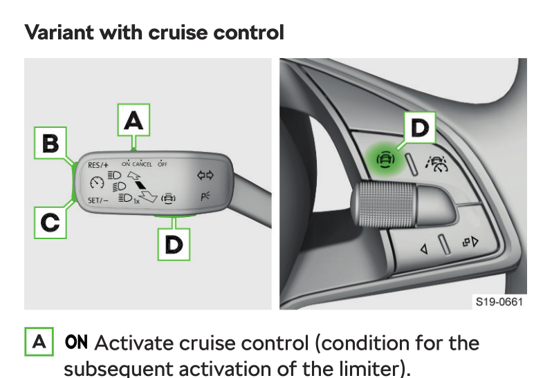

Do you have this one?  If yes, did you switch the "A" button to ON?

Thanks all for your help. Yes switch A is on. I think Bouncypete I’ll go with you suggestion and go to the dealer
Have you tried pushing button D on the bottom of the stalk?

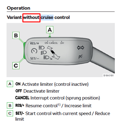

@Kenny R I don’t have that button
According to the owners manual, this one is without cruise control. :blink:
When I test drove the car before buying I tested the cruise control and worked well! Weird.
The stalk shown is also the stalk for cruise control, (but not ACC). UK handbook extract;
