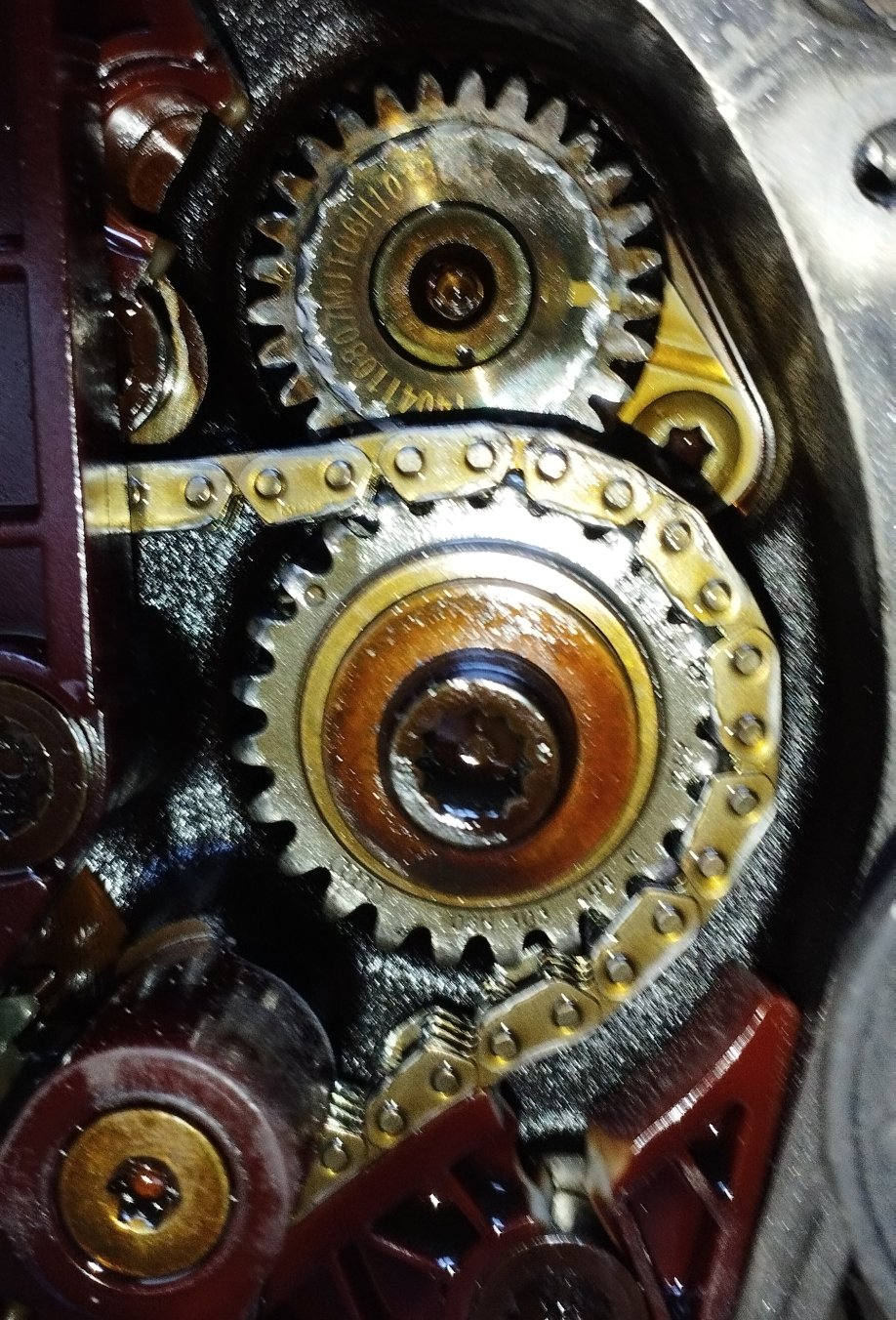

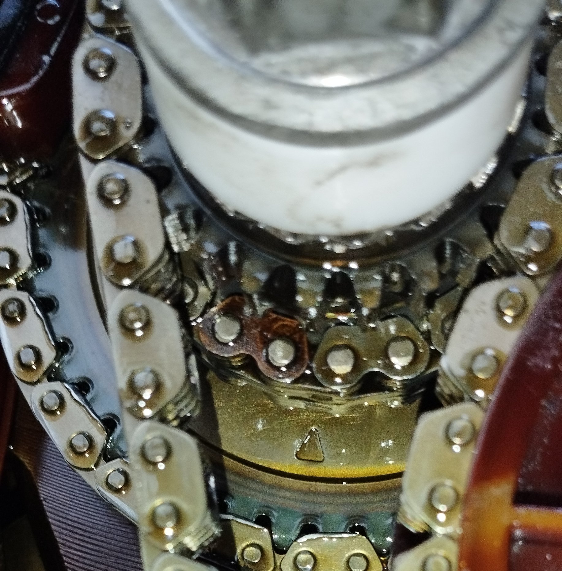

  1. So once I got the timing cover off it became obvious what the problem was. In addition to the exhaust balance shaft being seized and all the teeth having been ripped of the socket, it appears that whoever did the timing previously didn't align the marks properly. The timing chain was off by one tooth down on the crankshaft sprocket... That's the reason for the weird cam phase adjustment.... I'll upload some pics if I get the chance...
  2. You think I should just replace all the timing chains and guides in the this situation? I was considering just replacing the balance chain and guides, in addition to the two balance shafts of course...
  3. I finally got around to popping open this can of worms and I'll just let the pictures speak for themselves. Basically, the exhaust balance shaft seized, but the engine apparently didn't notice and simply ripped the teeth off and shattered the balance guides. Additionally, the camshaft timing marks line up perfectly and measure a near perfect 124mm apart with the intake measuring 65mm. However looking at the crank the colored link is one tooth off. Looking at the tensioner it's only four notches past the end with plenty of tension, so I'm guessing that whoever changed the chain probably a few years ago didn't time it right. That the +13* cam phase... The sprokets on the intake balance shaft look pretty chewed up too... Haven't pulled off the cam bridge yet to inspect it... I'd like to point out that miraculously this engine runs relatively well all things considered. I drove it about 100 kilometers after buying it at a used car dealer who claimed it was all in perfect working condition, but sold it at half book value... Once I've got this all fixed I'll recheck the oil pressure issue and maybe replace the cam bridge, it that doesn't work I'll look at the intake camshaft bearings...

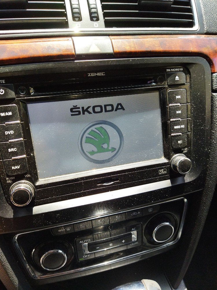

  7. I'm really just asking out of curiosity, how does the Skoda logo come up on a 3rd party nav system?
  8. Really? When the car starts up it shows the Skoda Logo on the screen, and the built in back up parking sensors display on the screen...

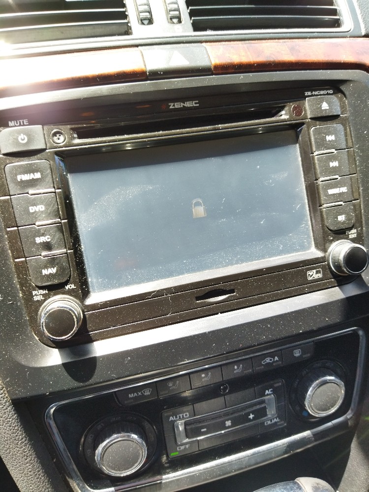

  9. I bought a 2011 Superb from a dealer and didn't notice until I got home that the radio is locked. Here's a picture. How do I unlock it? I've got a Launch X431 if that helps.
