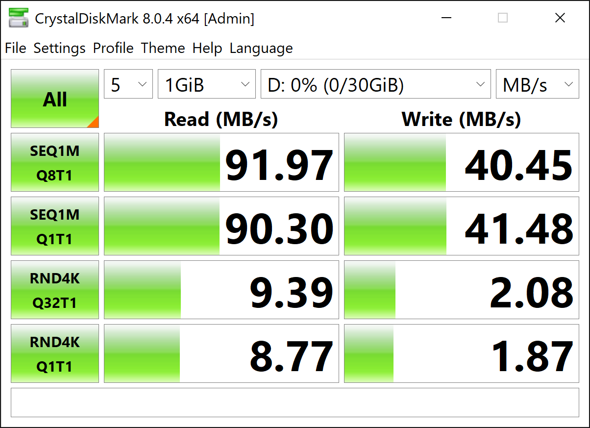

Wow that's quite a significant hit. Why would the 2 random read/writes be nearly identical when the sequential ones were so far apart though? Now don't get me wrong, I'm not for one minute suggesting I understand the figures, just reading the numbers π You were right as well about the USB socket in the car, can't get a clear piccie of the pins because of the obstructions. Will have another look tomorrow when 1) it's daylight 2) not having to try and adopt a yoga position because of the rain

Will try and get a pic of USB this afternoon, in the meantime checked the SD card I'd been having no joy with. It's Sandisk Ultra 32GB Class 10, quoted as 120mb/s. Realised now where I was going wrong. It was originally formatted Fat32 8192 bytes, could've sworn I'd originally formatted 4096 bytes but obviously not. Files this year obviously a little large hence why it maxed out. I have now formatted ExFat which allows down to 2048 bytes so files would have probably fitted. Have deleted them off this computer now and can't be arsed re-downloading, may try on the MAC some time to see if they do indeed fit.

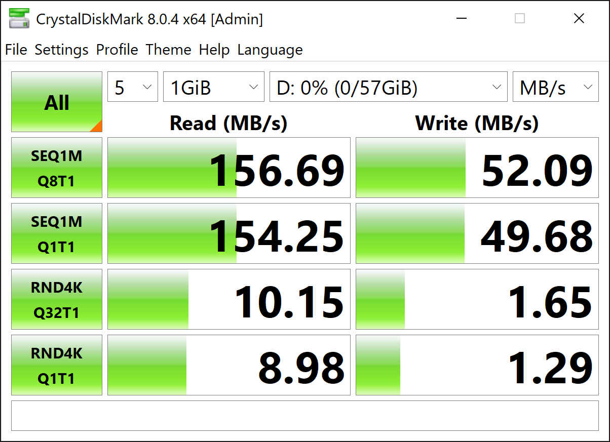

So here are the results I got. Brand new "Sandisk Ultra Dual Drive Go USB Type C 64GB" Formatted ExFat 4096 bytes (Interesting that when formatting SanDisk Ultra Class 10 SD card didn't give me the option of 4096 only 8192?? Just tried it again and same??) Computer is a Dell XPS 15 9560 running Win 10 Pro Hope this all means something to you π€ Dave
