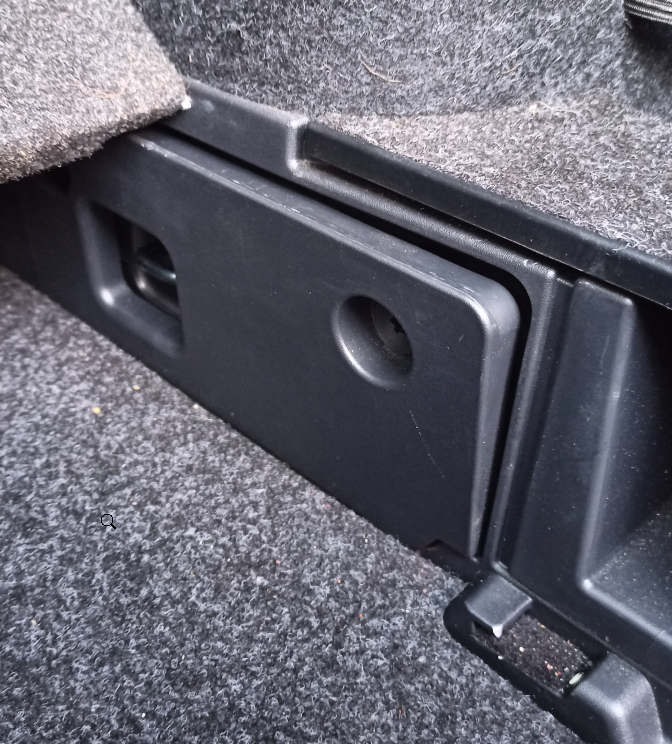

  5. Many thanks, JR. Blimey ! I can't believe two things.....firstly that I have been that dumb and secondly that someone responded so quickly. I have jsut had a detailed look over the boot 'Variofloor' and it does appear that these are indeed supports for the floor - no idea why I didn't spot it the first time! I've had Fords for so long, I will have to get used to the Skoda terminaology and way of doing things - which are totally new to me. Many thanks for you help.
  6. Hi All, I have just bought my fiorst Skoda - a 2018 Octavia Estate....and have a conundrum that numorous Googling etc. hasn't enabled me to resolve. In the boot, under the moveable floor, there are two plastic panels, one each side of the boot. These panels are secured by two round plastic 'buttons' that have torx heads. when these are fully screwed in, the panel doesn't sit flush, though if you press it in manually with your fingers, it does. I have taken both panels off and checked nothing is broken - but it appears to me that the torx head buttons would never secure the panel flush - it's as though some part was missing. As I have no idea what the panel is called, or what part could be missing, searching on Google has proved fruitless. I would be most grateful if someone could tell me how their cars covers are fixed, and or what these things are for? Are they just decorative?
