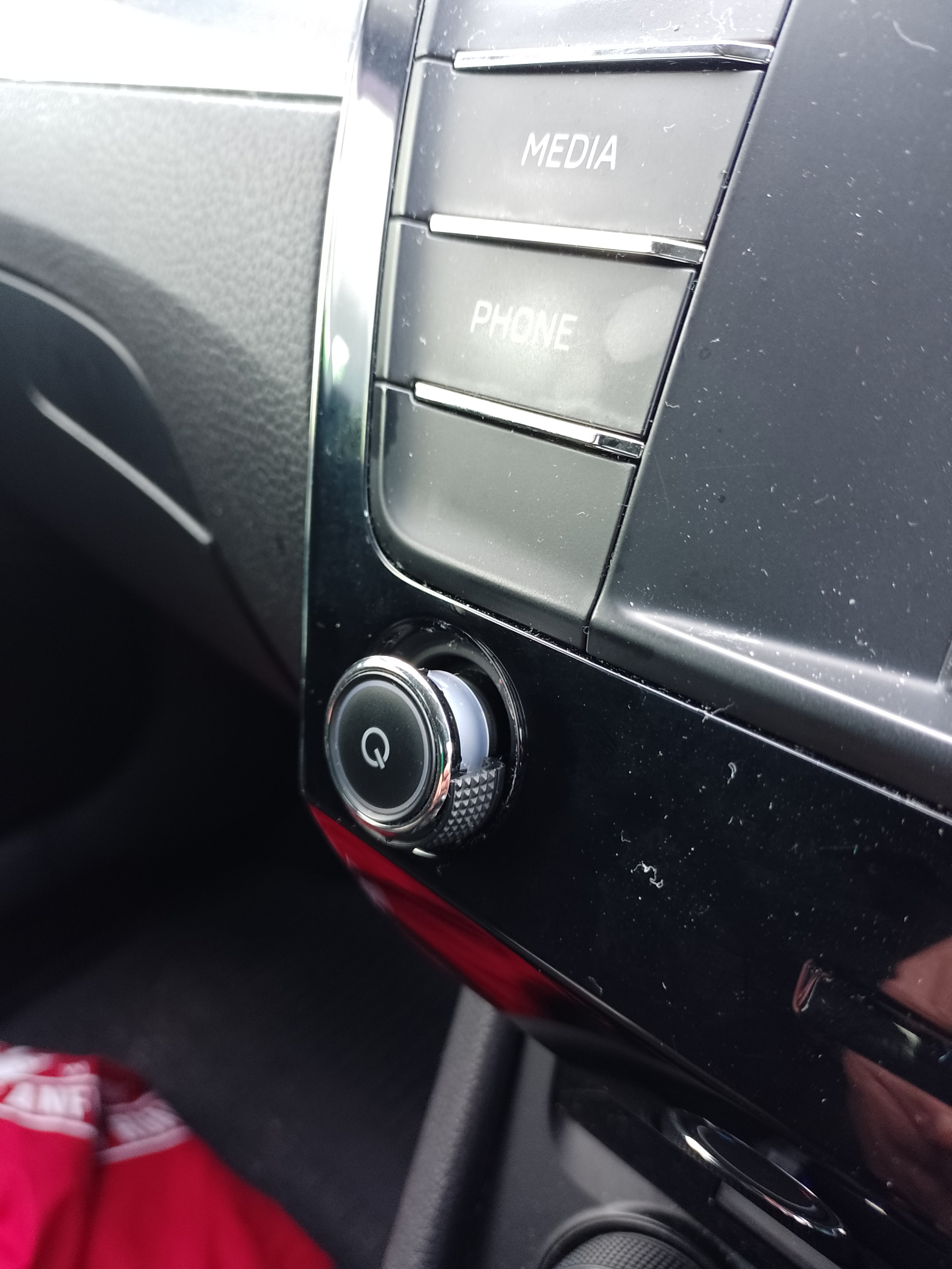

  1. Hi, yes they just pull off, I think it was temu I found them on.

  11. Well spotted 😊
  12. Yes I think that's the plan, apparently the knobs just pull off so should be an easy fix. It's interesting that this hasn't happened to anyone else as far as we know.
  13. Hi, you can see the turning grip has broken, it is the same for both knobs. I found out Skoda sell replacements but they are €30 each ! Some Chinese copies are available for 6 or 7 euros each. At the moment the knobs still work ok.
  14. Superb V3 standard unit no nav.
