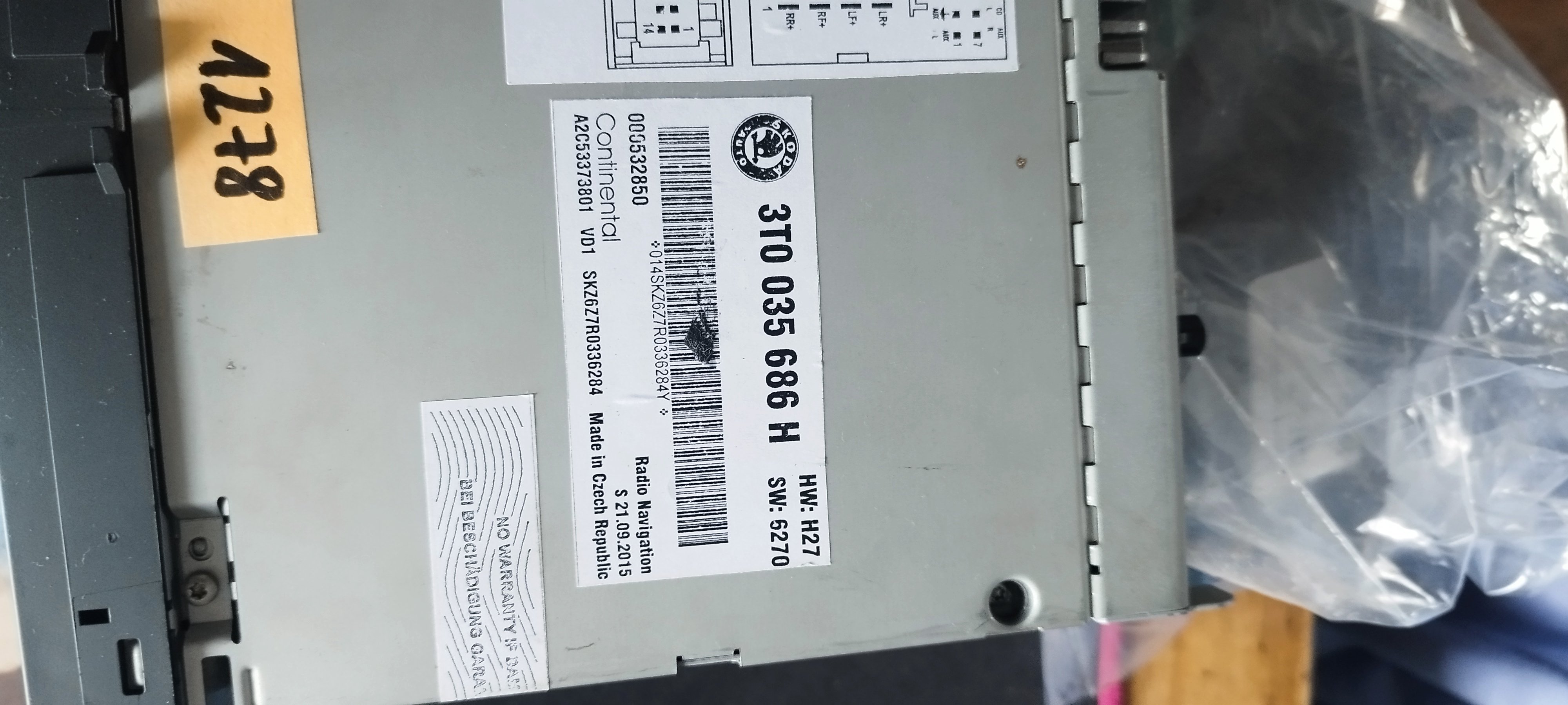

  1. Or it's the internal power supply of the head unit. I've ended up buying a replacement head unit. Completely aftermarket but with canbus connection

  5. My hazard lights are permanently on. Car on or off. Only way to stop it is disconnect the battery 🤣 I've been searching through the threads before creating a new one. The indicators come on on double time but all the bulbs work on the car. Car car bulb mil is one but literally every bulb and fuse in fine. Heeeeeeellp
