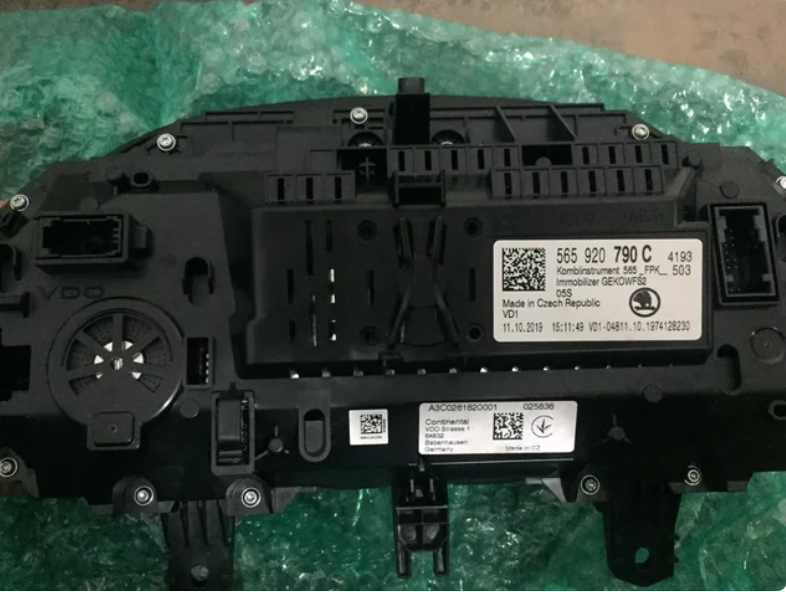

  1. Hi @ApertureS , then I understand that due to the type of immobilizer for my car the valid VC are 565 920 790 and 565 920 790A,

  3. Thanks for your recommendation friend, the VC comes from car scrapping I guess it will give me a guarantee, if they give me a guarantee and for the price (€200) it is worth it.

  5. my vehicle has 60,000km and the VC they sell me has approximately 20,000km,

  8. Hello colleagues, recently I changed my bolero system for an amundsen (5Q0035864C) and I am very happy, but now I want to change the analog board for the VC, I have found a scrap one with reference: 565 920 790 c. the seller tells me that it is valid for my skoda karoq MY18, could you confirm if it is correct please?
